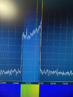

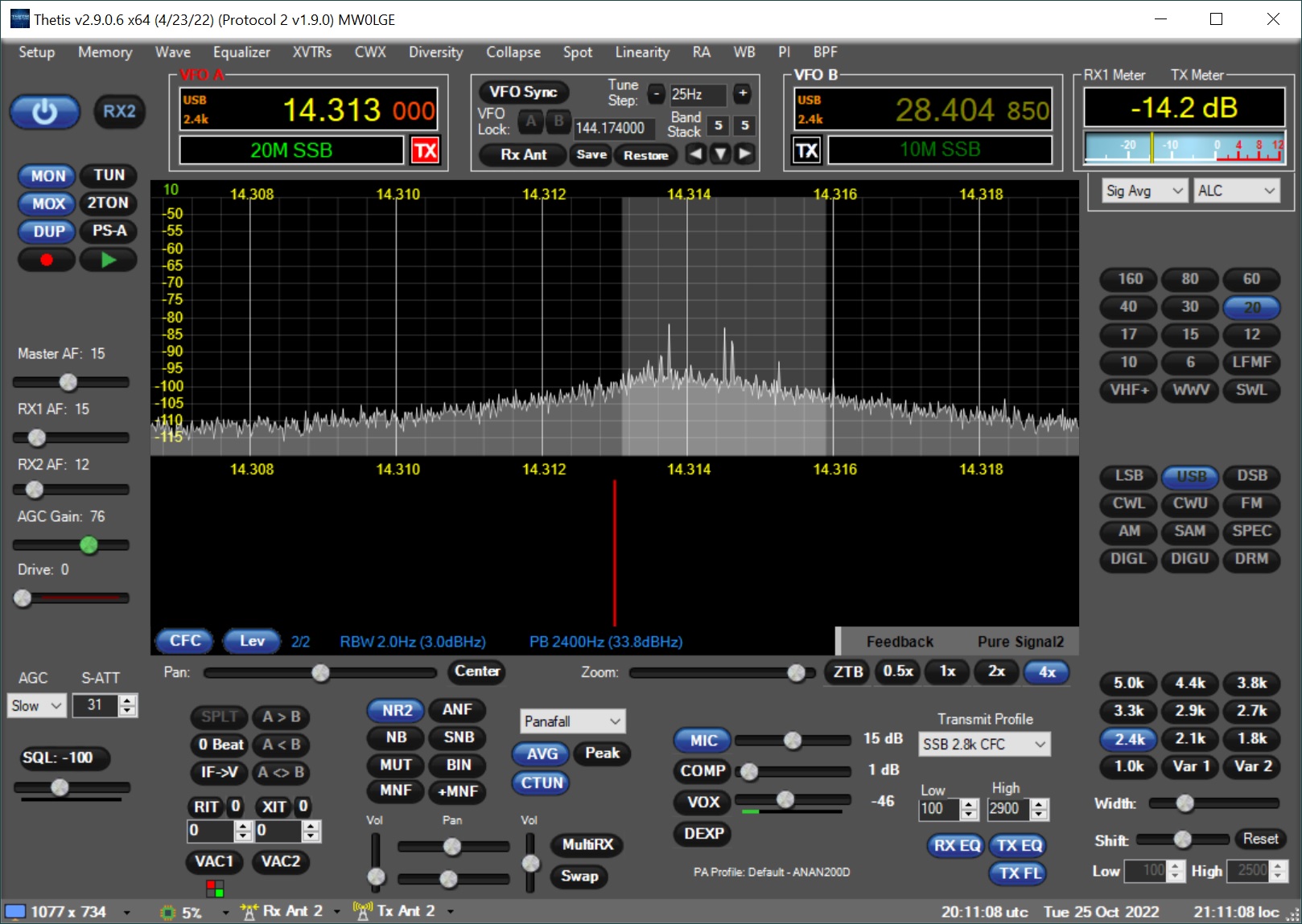

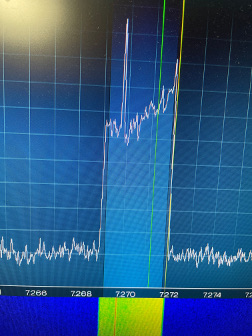

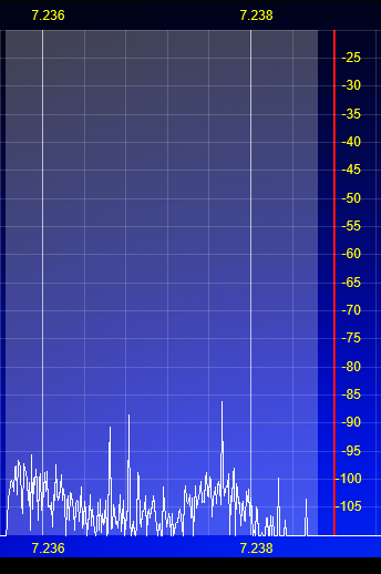

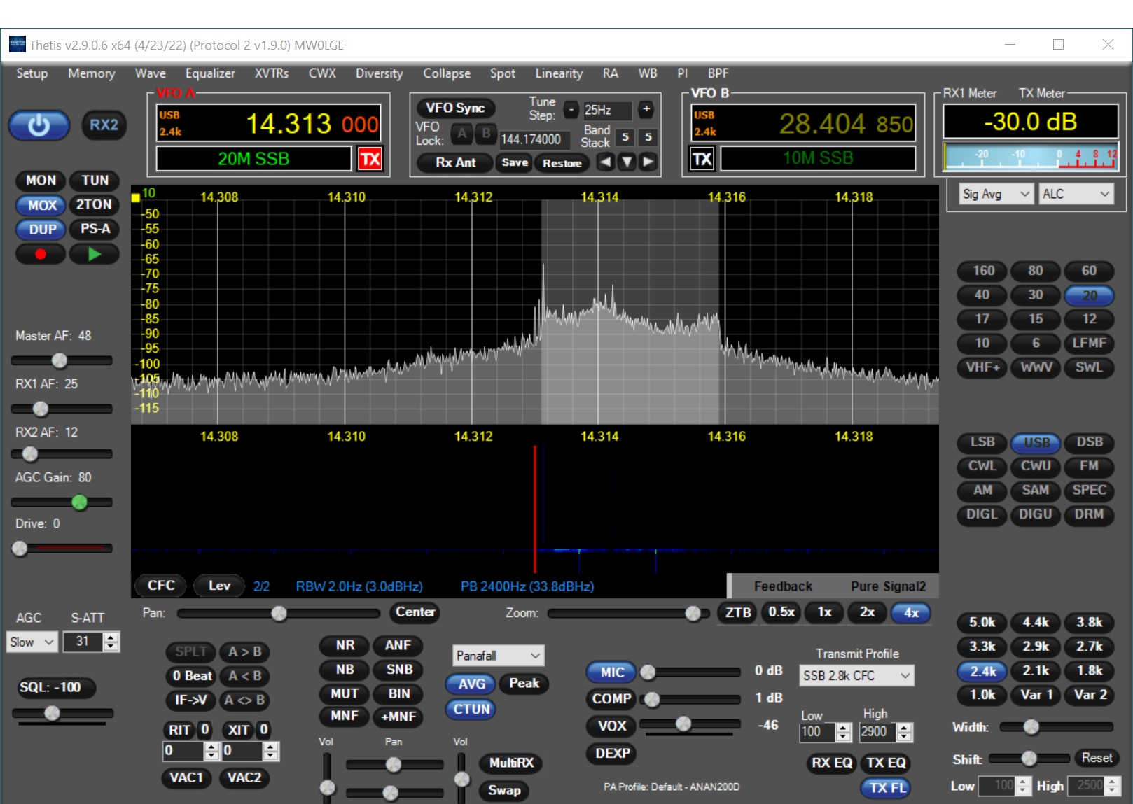

Okay, well I finally got the MIC and everything set up in the shack for the New 7000DLE MK2 with REV3 board and Version C of the new firmware causes my Radio to have a Carrier on the TX looking at my spectrum analyzer screen with the radio on a dummy load on LSB I have just reset the database to fresh start, set the 7000DLE to on 40 meters so if I'm tuned to 7.272.000 MHz to Carrier is on 7.270.000 MHz on Upper sideband it is at 7.274.000 MHz and only using the MOX to key the radio. I have Reset the Database and with no cables plugged in except for the Ethernet, Power, Antenna to a Dummy Load and NO difference. No Mike plugged in at all Just the Ethernet cable and coax With MOX enabled
I reinstalled the original protocol 1Firmware, it made ALOT of difference and the carrier was just barley there and could not be heard on the air.
I then reloaded Beta Version C of REV2 and the Carrier was back, I tried Version D and it has the issue to, I will have to use Version 1 but better then nothing.
Protocol 2, there are also Digital Audio artifact sounding echo's on the MIC audio that other stations can hear along with the Carrier.

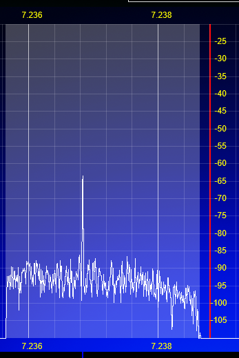

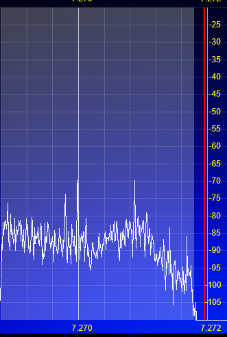

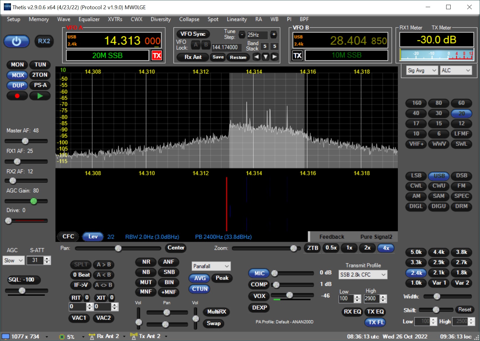

Attached the pictures, Protocol 1, The power on the radio transmitter is higher output to see the carrier Spike out of the RF signal floor, Protocol 2 Power output is turned way down.
Anyone else see this?

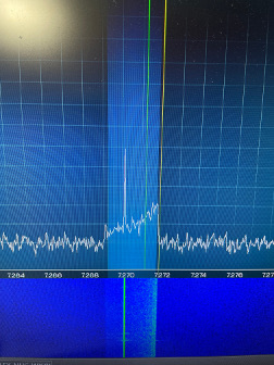

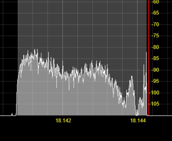

- Protocal 2 Firmware D small.jpg (43.61 KiB) Viewed 27656 times
- Protocal 2 Firmware C Small.jpg (43.53 KiB) Viewed 27656 times
- Protocal 1 Firmware Small.jpg (39.19 KiB) Viewed 27656 times

That spur (it's not a carrier) should not be there with P1 or P2. And as KC2RGW already pointed out, any echo (or reverb) on your signal is dramatic evidence of RFI. The reason it appears as an echo is because there is in our radios, depending on settings, there is generally between a 100ms to 200ms delay from mic input to RF output. So any RF getting back into the mic input creates an echo.wx7y wrote:I reinstalled the original protocol 1Firmware, it made ALOT of difference and the carrier was just barley there and could not be heard on the air...there are also Digital Audio artifact sounding echo's on the MIC audio that other stations can hear along with the Carrier.
Concentrating on only P1 for now, does this happen on all frequencies and bands? If you can eliminate the RFI that is (probably) causing that spur then all will probably be well. In other words, P2 is most likely not the cause, but merely making the problem more apparent.

NO, Revision 1 work great No spur, no Digital reverb just great sounding audio, the Audio is NOT being over driven, I use the same Database for Revision 1 as Revision 2 and have tested it with a HARD RESET other than audio levels set correctly.
Like I said before the Pictures from the first message show it all, the Bottom Picture is Revision 1 and no MIC plugged in Using MOX to key the radio in ANY of the pictures.
The Audio, reverb is NOT RFI it is there even when the Output Power is at 1W and only happens with Revision 2 Firmware which and has NOTHING to do with RFI.
The Spur is NOT being suppressed on Revision 2 like it is on Revision 1 (Look at the Pictures) and is strong enough carrier to be heard 20 Miles away which is way to strong for FCC Regulations and permissibility , If no one else is seeing this or hearing this then I would be surprised, But maybe I'm the only one that has the issue or that has the RF Test equipment to see the issue's who has a ANAN 7K DLE REV 3 radio.

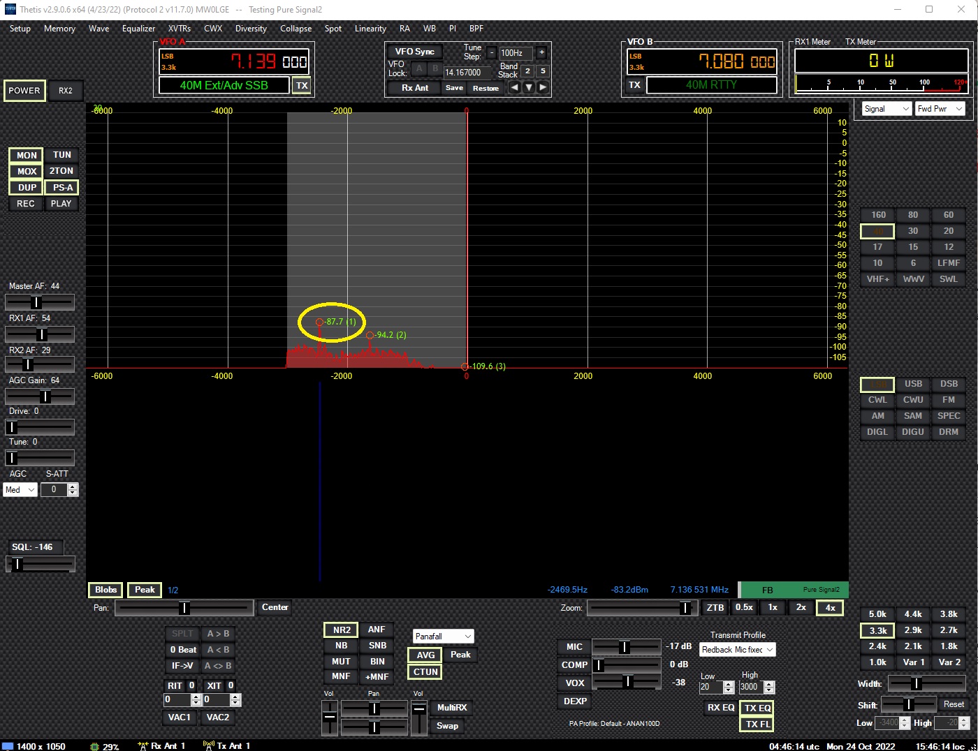

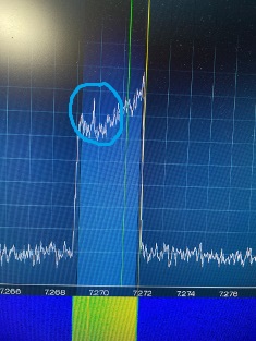

In that picture that is Revision 1 and is there all the time, and is WHAT I am talking about, or with the MIC plugged into the radio or not and from 1 to 100% Drive levels.
To see it in the TX spectrum on the Radio scroll up 10 or 20 DB on rev 1 and I can just see it out of the grass.
On REV 2 looking at the other two pictures that I sent using REV2 ver C and REV2 ver D you see it is SO much stronger.
A station a mile away can barely see that signal using REV 1 running 30 Watts out and is at least -110DB down and is perfectly acceptable and legal but with REV 2 it is +30 to +50 DB higher, which you can see in the Picture, and I can see it with the same process as above using the ANAN TX spectrum.
He hears it about 10 over S9 when I key using MOX with no MIC plugged in running the same Power level using SSB with no MIC he should NOT hear anything at all.

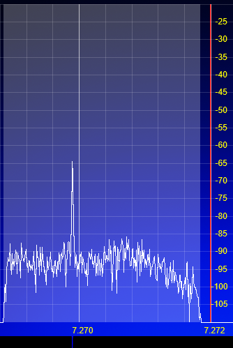

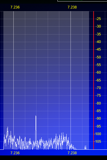

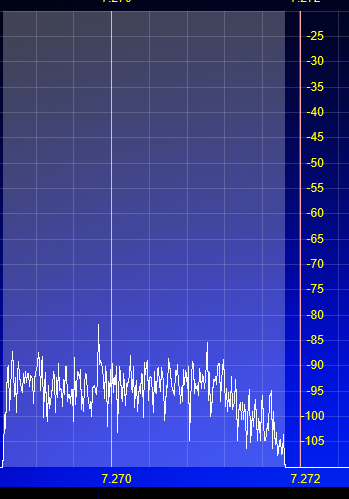

Sure, no problem whatsoever, here you go
These Pictures taken using the Thetis TX Display and are named for what they are displaying in case they get confused in the upload.
1st Picture "MIC Boost" ON, REV1, MIC unplugged, still there just harder to see because it's in the Noise
2nd Picture "MIC Boost" OFF REV1, MIC unplugged, there are actually 2 birdies that show with the lower MIC gain but still there.
REV 1 Is acceptable on the over the air testing.
3rd Picture "MIC Boost" ON, REV2, MIC unplugged, Pops right up out of the TX Noise floor
4th Picture "MIC Boost" OFF REV2, MIC unplugged, Pops right up out of the TX Noise floor
REV 2 Is not acceptable on the over the air testing.
The MIC level is set at "0" in these test

- REV2 MIC boost on (1).png (139.16 KiB) Viewed 27565 times
- REV2 MIC boost off (2).png (135.92 KiB) Viewed 27565 times
- REV1 MIC boost off (2).png (163.24 KiB) Viewed 27565 times
- REV1 MIC boost on (1).png (146.74 KiB) Viewed 27565 times

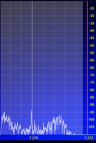

did another test with REV 2 C,
I turned off the 20DB Boost and turned up the MIC gain to approx. 17DB so the Mic levels are -10DB down on the ALC meter (same as with MIC Boost) BUT ALL of the TX grass is substantially higher, and the birdies are buried down in the INCREASED TX Grass, here is the Picture of it in this configuration.
Woops, the Display range changed turning up the MIC gain so there IS lower Birdies with the MIC boost off and MIC gain set to +17DB

- REV2 MIC boost off MIC gain up to 17DB #2.png (139.81 KiB) Viewed 27555 times
Re: New 7000MKIII Protocol 2 Firmware Topic
So the spur is strongly associated with mic boost. That implies that the CODEC IC on the Orion board is picking up some sort of noise on the mic input, and that the noise is worse with P2 firmware installed. In terms of potential noise producers in P2, there is the gigabit Ethernet rate increase that might be a factor.
Did you happen to try line in or VAC in order to confirm that the noise is uniquely associated with the CODEC mic input?
I'm assuming you are using a dynamic mic of some kind? Not that that matters where this problem is concerned, I'm just curious?
Were you going to try P2 Rev's A and B?

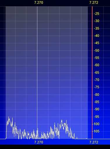

Here are the Pictures,
Look like REV2 C using the Line input maxed out (doesn't make a difference) the Birdy is only about 2 DB stronger, and the TX noise floor is 1 DB Lower BUT REV1 clearly shows the 2nd Birdy closer to Zero Beat much stronger.
VAC on both Revisions is very as the attached picture shows no sign of the Birdies so definitely in the Audio chain somewhere
If you think the Line input can be driven with a MIC I will build a cable to interface to it.
Rev 2 ver A gives me sequence errors 8 (DDC2) errors, The signals look the about the same as Ver C, I have pictures if you want them
Rev 2 ver B radio will not connect to Thetis, just click the relays and throws the sequence error 8 (ddc2) error

- REV2 A Line Input source selected with Gain set for max at 12.0.png (155.24 KiB) Viewed 27525 times
- REV2 A MIC boost on .png (152.69 KiB) Viewed 27525 times
- REV2 A MIC boost off .png (149.83 KiB) Viewed 27525 times

This is unfortunately interesting. The presence of interference on the CODEC mic input in both P1 and P2, and becoming worse with P2.
Does anyone else see this? I cannot duplicate it on my 8000 running P2 here. Is it something unique to new 7000's that use the Orion MKIII?
Obviously rev's A and B are non-starters for you, and rev. C works quite well (other than the interference), which tracks well with everyone else's experience.
Line in cannot be driven by a mic alone, a mic preamp would be required to bring the signal up to line level.
Using a condenser or electret mic would help as you could disable mic boost.
The "a" answer would be to use VAC audio, although I realize this might not be something you are interested in.

I spent so many hours working on this project and gave it a good college try.
Thanks for all your hard work on this and this is the way my luck goes.
73's
Bret
WX7Y

Re: VK-JOE's 100D questions
Audio chain "birdie"??
Want to share an interesting observation with MIC input “static” levels on the 100D
To me it looks like a “birdie” – its approx. 2450Hz offset from the VFO frequency (on either sideband – whichever is selected – here it’s on LSB)
I can totally remove this “birdie” using the Equalizer (TX) and simply “tuning out” at 2450Hz
Obviously, this creates a “hole” in this passband – not desirable.
Varying the audio chain “gain” will not suppress this “birdie” on its own – it will move the entire passband – including the “birdie”.
Under operating conditions – this “birdie” has little noticeable effect – unless there is “dead audio” - then the 2450Hz can be heard – albeit very very quiet.
I have “pulled” the microphone from the MIC socket – so this “birdie” appears to be generated inside the radio.
Has anyone seen similar effects in their radios?
Is this “birdie” caused by some stray harmonics entering the audio chain?
I did not look in detail at the schematics – thought to share this observation first – just in case its something common and a known artifact.
Hope the above information / observation serves some greater need
Perhaps its present in other radios – but simply not noticed
Have Fun
Have Fun

Re: Mic audio birdies/spurs 100D/7000/P1 vs. P2 firmware
Scott alerted me to this thread. I have been experiencing similar 'audio birdies' almost exactly as described here with my 200D mic input. For me this happened several years ago and I swapped to PC audio, which I used successfully until I hit a reverb problem recently (in another thread).
Here is a screen shot of my mic audio spectrum- you can clearly see the peaks present giving the birdy type interreference. These audio tones are heard on TX and cause a real degradation of signal quality.
73 Dave G3ZQH
200D, Thetis 2.9.0.6, Protocol 2 v 1.9, W10 PC, electret headset
73 Dave G3ZQH
I don't see this on my 100D or 8000. They are both very quiet. And there are not a lot of reports on this issue, although perhaps we'll see a few more now that this topic is started. But it hardly seems epidemic.
My gut feel is that this is noise from one of the internal switchers or some sort of clock noise affecting the CODEC chip itself, and nothing to do with software, firmware or the FPGA. Perhaps something along the lines of this topic: viewtopic.php?f=17&t=2922 (Jim did a fabulous job of fixing his ANAN if you read through the entire topic).
I just took a screen shot of what's coming out of my 8000. Nothing plugged into the microphone port, mic boost off, mic gain maximum. Transmit passband is 50 to 3500Hz (quite wide). Protocol 2 is in use.
It looks essentially the same mic boost on or off, mic or line selected, on all bands. When I turn on MON and turn up the volume I just hear normal noise akin to white noise, there are no obvious tones. It is quite an odd shape, though, not at all flat, and I have to wonder what is causing that.
Just another observation to add. The same birdies are not there when I unplug my mic- although some different peaks appear at a lower level (see screenshots below). My mic is electret, so is it possible that these audio birdies are linked to the bias voltage? Has anyone seen these peaks with a standard mic?
73 Dave G3ZQH
73 Dave G3ZQH
Dave--both Bret and Joe are reporting these spurs without their mic's being disconnected. That you are only seeing them with your mic plugged in implies that the mic element and/or cable are picking up this energy and bringing it into the ANAN, rather than it being generated inside the ANAN somehow. In other words, your problem is likely a different problem compared to what Bret and Joe have reported.G3ZQH wrote:Just another observation to add. The same birdies are not there when I unplug my mic- although some different peaks appear at a lower level (see screenshots below).
One thing you might try is to turn off mic bias. If that eliminates the spurs you are seeing then they might be coming out of the CODEC bias supply, or they might be coming from the mic element itself. The only way to know for certain is to try an entirely different make/model microphone. If you turn off the bias and you are still seeing them, then it is likely being picked up by the cable or body of the mic and getting in that way. At that point you could try coiling up and/or otherwise moving the cable and seeing if those spurs change in character.
