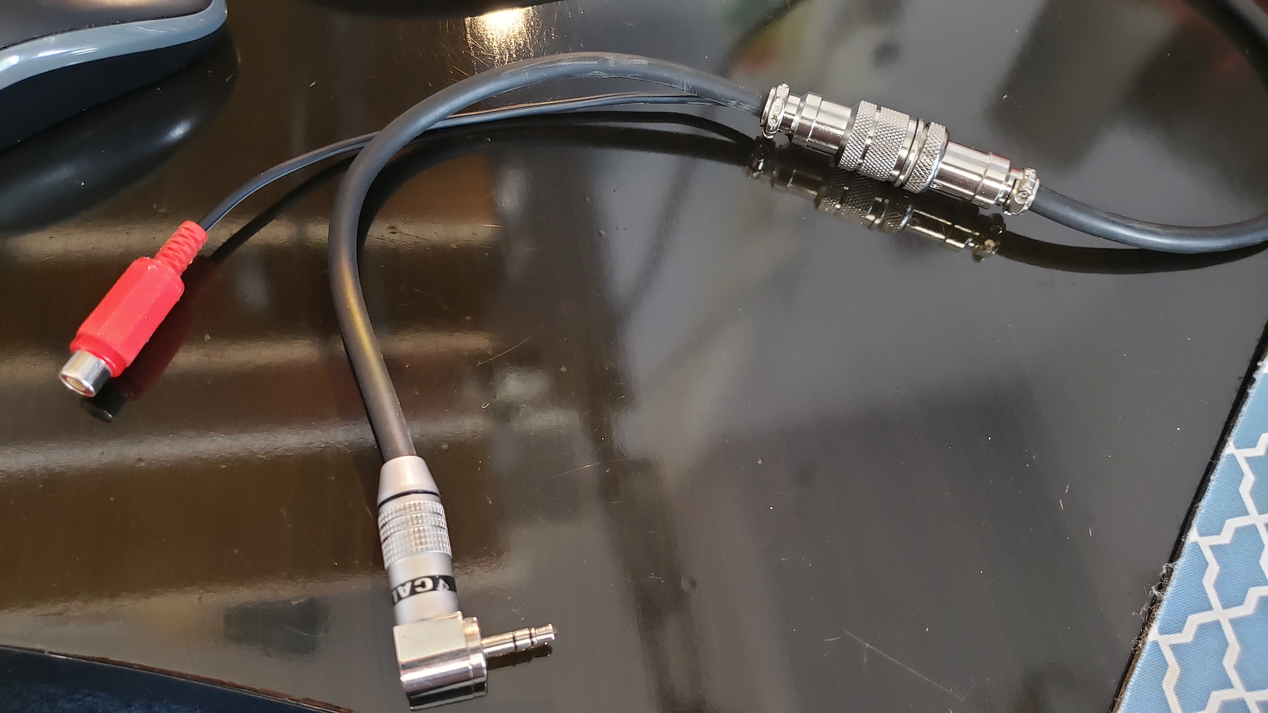

Finally results, I have to use the ptt at the front mic connection which eliminates the click from the mic element.
Jay N2GQ
Posts: 5941
Re: Click from Microphone
That makes no sense, and I'd really like to understand why that works.
Sexy connector!
Is the RCA to Y in the footswitch?
K4IBC
Posts: 76
Post by K4IBC »
w-u-2-o wrote: Sexy connector!
Thought so too. Did a search for it and came up with a Calrad 30-256 that is not listed on their website.
n2gq
Posts: 148
Post by n2gq »
[quote="w-u-2-o"]That makes no sense, and I'd really like to understand why that works.
Sexy connector!
Is the RCA to Y in the footswitch?[/quote
Yes the rca is for the ptt foot switch. The right angle plug 1/8 is made by calrad, the other gentleman is correct and I got the plug from krp electronics in Farmingdale.
Jay N2GQ
