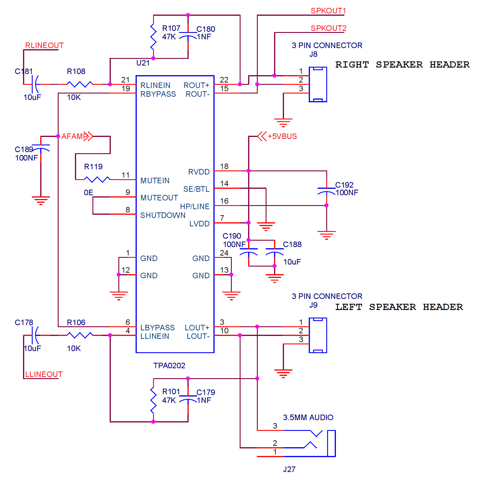

Old thread I know, but I'm curious how people are driving monitor speakers with the 7000DLE MKII . (no PC)
I've tried the 3mm audio output, but my radio at least has low-level noise on it - low level crackle and spits. Not a fan.
The (Very Strange) 1/4" jacks on the back are ok, but 2 watts of "chip audio" does not appeal to me either.
I have a number of audio amps and speakers available, the issue seems to be getting a clean signal out of the radio at a reasonable impedance and level. The rig is only six months old, so I'm not too keen on modifications yet, but I may consider that.
Is the audio amp power amp on a separate board from the Orion II? If so, perhaps I could make a "reversible" modification and bring a line-level signal out from the radio board. ?? I have the "manual", but it fails to provide much in the way of technical information.
Jim N7CXI

Jim,N7CXI wrote:Old thread I know, but I'm curious how people are driving monitor speakers with the 7000DLE MKII . (no PC)
I've tried the 3mm audio output, but my radio at least has low-level noise on it - low level crackle and spits. Not a fan.![]()
Jim N7CXI
I have the same radio as you, I'm driving a set of Klipsch ProMedia 2.1 satellites and subwoofer straight out of the headphone jack, no issues at all, amazing sound quality. Are you sure there's not a problem with your audio cable?

The noise I hear using that output is a very low-level crackling, hissing, "scraping" noise, like a noisy semiconductor junction. I've tested the cable and put DeOxit on the plugs to no avail.AG5CK wrote:I use the HP jack on the back of my 7000 dle mk2. I never had an issue with the pc speakers but did have a ground loop issue with the jbl 305 monitors. The ground loop caused a high frequency whine when my PC was turned on. I put one of those 2 to 3 prong outlet adapters on the power cord for each monitor and solved it. It seemed more professional than cutting the ground prong off of the cords.
Of course the monitors I've hooked up to it have a lot of gain; it could be that I could put a Tee or PI resistive attenuator in the line and run the gain higher on the rig - putting the noise down far enough that I wouldn't hear it.
Ground loops... Now you've gone and said it.
Jim N7CXI
Re: Powered Speaker for my setup !!
Jim,
That sure sounds like a hardware issue. I would send that radio to Doug for repair.
W2FMU
W2FMU
At this time the 7K and 8K schematics are not publicly posted but are available upon request from the factory.N7CXI wrote:Is the audio amp power amp on a separate board from the Orion II? If so, perhaps I could make a "reversible" modification and bring a line-level signal out from the radio board. ?? I have the "manual", but it fails to provide much in the way of technical information.
If by reversible you mean without cuts and jumpers on a board the answer is "no".
The amp chip is on the main Orion MKII board.
The easiest way to get line out levels would be to cut/jumper the breakout/connector board on the rear panel to re-purpose the DIG IN RCA connectors. Left and right line-out are available on the ribbon cable that comes from the Orion MKII.
Nevertheless, you really shouldn't be having problems with the output of the headphone jack. I wonder if there is some cracked solder on that jack that could be touched up.
I would not recommend that. Here is a snippet of the schematic. You can Google the data sheet on the TPA0202 amplifier IC for more information. The outputs are configured in bridge-tied mode. If you ground either side of a speaker output, or tie them together, your risk damaging the TPA0202.N7CXI wrote:Actually I haven't tried the headphone jack yet, just the rear-panel jacks. I'll think about that. The impedance is all wrong, but as long as the audio amp doesn't care about that it might be worth trying.
