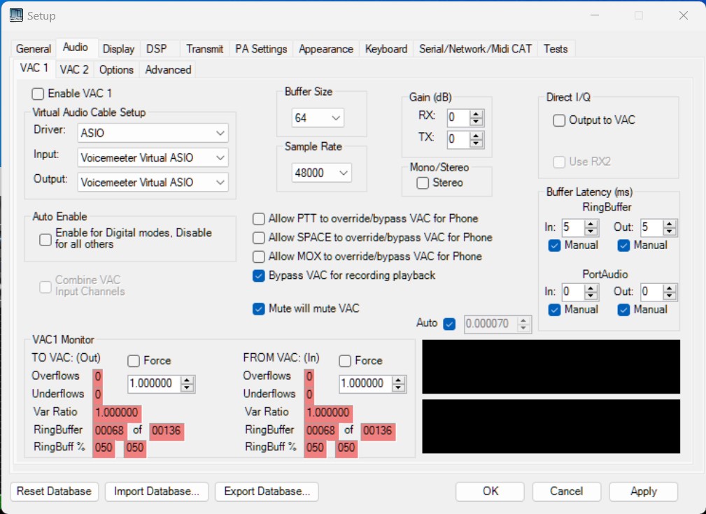

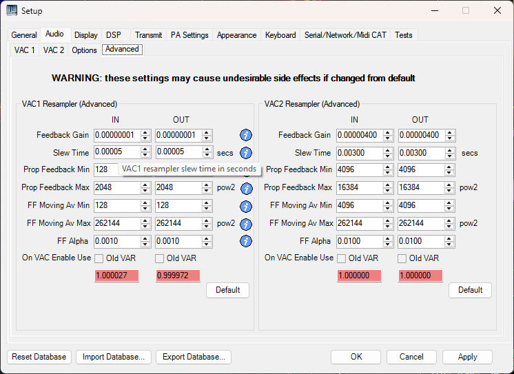

Ruben,
Here's my settings and an explanation of why I'm running them:
My VAC buffer size is 64 (much lower than anyone else's I've seen posted), my RingBuffer is 5/5 and PortAudio is 0/0.
I learned early on that if I had buffer size set to 2048 (or even 1024) I could easily get away with running RingBuffers of 0/0, but I was looking for minimum latency so I kept reducing the VAC buffer size to 512, then 256, then 128, and finally all the way to 64. At some point (don't remember where anymore) I did see that I needed to start increasing RingBuffers to something greater than 0/0 to avoid my transmit audio from getting "robotic" sounding. I determined empirically that a RingBuffer setting of 5/5 settled down within a few seconds and was 100% reliable for RX and TX audio so that's the values I locked in to (again, that is with a VAC buffer size of 64).
I'm running a MOTU M4 interface with its buffers also set to 64. I'm also using Voicemeeter and have been informed that VM isn't designed to (and shouldn't be expected to) function reliably at all with a buffer size of 64, but it certainly does in my particular case so that's what I'm using!
I guess what I'm saying is if you decided to try a smaller VAC buffer size just to see if your TX audio was still stable, then keep reducing the buffer size until a "breakup" problem first appears, then stay at that buffer size and start increasing your RingBuffer size until the audio re-stabilized, you should then be operating at the minimum latency that your system can reliably support.
Scott, please do correct me if my latency logic is incorrect!

Posts: 5947
Re: Thetis 2.8.11-21+++ VAC advanced controls: results and discussion
Everything is relative. Main VAC buffer latency equals size x 1/48000 (in seconds), or size/48 (in milliseconds).
So a buffer of size 64 = 1.3ms, of size 2048 = 42.7ms. Meanwhile the ringbuffer is adding it's own contribution. Shoot for the minimum combination.
