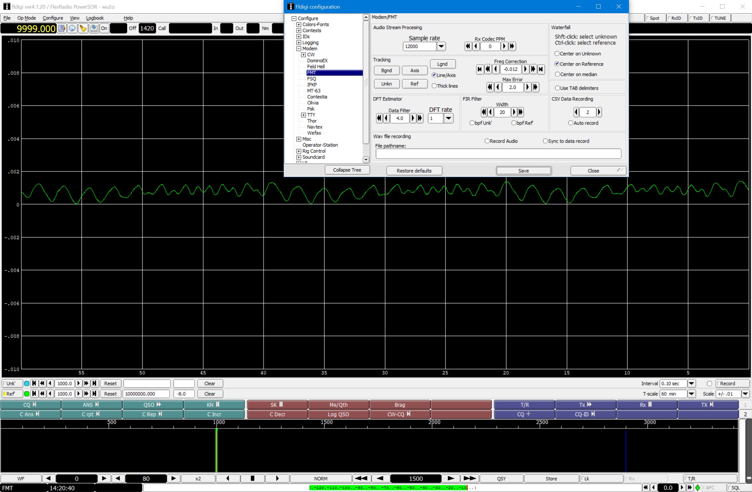

This is with 21k6

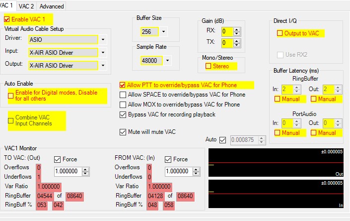

I'm using FLDigi's FMT mode to track my GPS to see the practical effect of these settings.
#1 One problem is the Buffer Size and Buffer Latency checkboxes are not being saved so have to change them on every restart of Thetis.
#2 Takes about 3 minutes to get close to where it should be...seems this could be faster so maybe the slew rate can be increased. I'll experiment
#3 I'm seeing a couple of transients which you can seen in the FLDigi data -- they coincide with a jump in the plot in Thetis. I'll have to capture one of those.
#4 Since I turned of Window buffer cache flushing I've had virtually no dropouts and been able to drop buffer size to 64.
- Screenshot 2021-09-30 112232.png (31.11 KiB) Viewed 60019 times
- Screenshot 2021-09-30 112151.png (55.57 KiB) Viewed 60019 times
- Screenshot 2021-09-30 111942.png (22.39 KiB) Viewed 60019 times

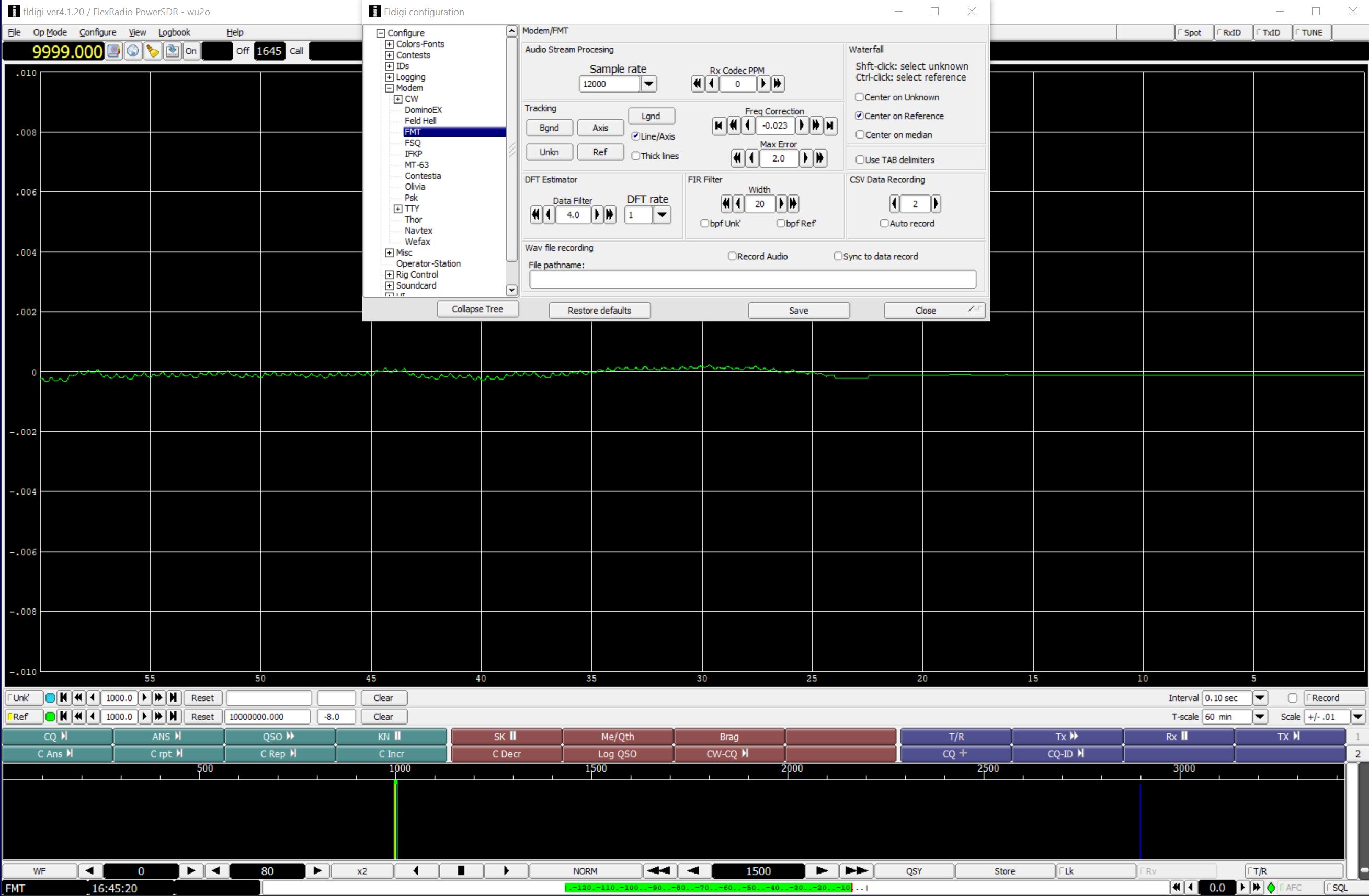

Re: Thetis 2.8.11-21+++ VAC advanced controls: results and discussion
Caught one of the transients
Looks kind of like a bit flip from negative to positive
This was about 3 minutes after startup.
- Screenshot 2021-09-30 114418.png (10.89 KiB) Viewed 60016 times

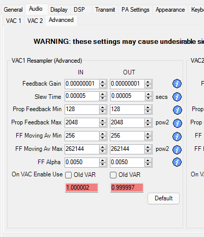

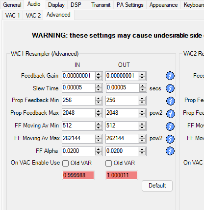

Bumping up the FF Alpha to 0.02 got rid of the big transients. But long-term stability is not too good. Switching back for Force for now and will show how stable it is there.
- Screenshot 2021-09-30 161150.png (39.13 KiB) Viewed 59997 times
- Screenshot 2021-09-30 122018.png (22.27 KiB) Viewed 59997 times

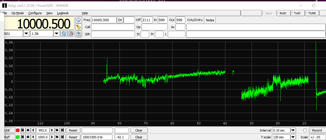

Scott...have you tried turning off the windows buffer cache flushing? Did miracles here. As long as you're on on UPS you're protected. Blue screen of death horks the buffer flush anyways so doesn't matter.
As for phase word I don't think that's involved here at all, is it? That would be in the Frequency Calibration. we have a frequency correction in FLDigi that CAN get us to within 1mHz -- I didn't use that on the run above. Would be nice to add that fine resolution correction to Thetis too. And that's a good example of how to avoid precision problems.
Tempting to do this:
freq *= 1.000000000000001
But that pushes precision and you can see the difference doing it a different way
main()
double f = 10000000;
double f2;
f2 = f * 1.000000000000001;
printf("f=%.17f\n",f2);
f2 = f + f*0.000000000000001;
f=10000000.00000001117587090
f=10000000.00000000931322575
You can see from the FLDigi plot I showed earlier that the drift is about 30mHz so not much and I can see how you could get 0.2Hz with WWV -- I've done WWV to < 10mHz on a good day. I worked with Dave W1HKJ on the FMT mode in FLDigi to where I can measure a frequency to < 2mHz now. I was running my own FMT with a group of users while we were developing this and you'll see many of the FMT operators using FLDigi now.
Some value is askew in the resampler...perhaps hitting accumulated error due to too much precision being used....especially with the fact that you get 15-17 digits of precision from a double so anything over 15 will be lost or rounded.
If I had access to the source I could take a look at this.
Here's a measurement of a local AM station -- which is extremely stable but not terribly accurate -- I have to put fairly good size frequency correction to zero out FLDigi. The real frequency of the station is off about 0.4Hz. This is a good way to measure another frequency to check the resampler if one doesn't have a decent reference.
This measurement has a standard deviation of 5mHz
main()
double f2;
- Screenshot 2021-10-01 094335.png (66.27 KiB) Viewed 59857 times

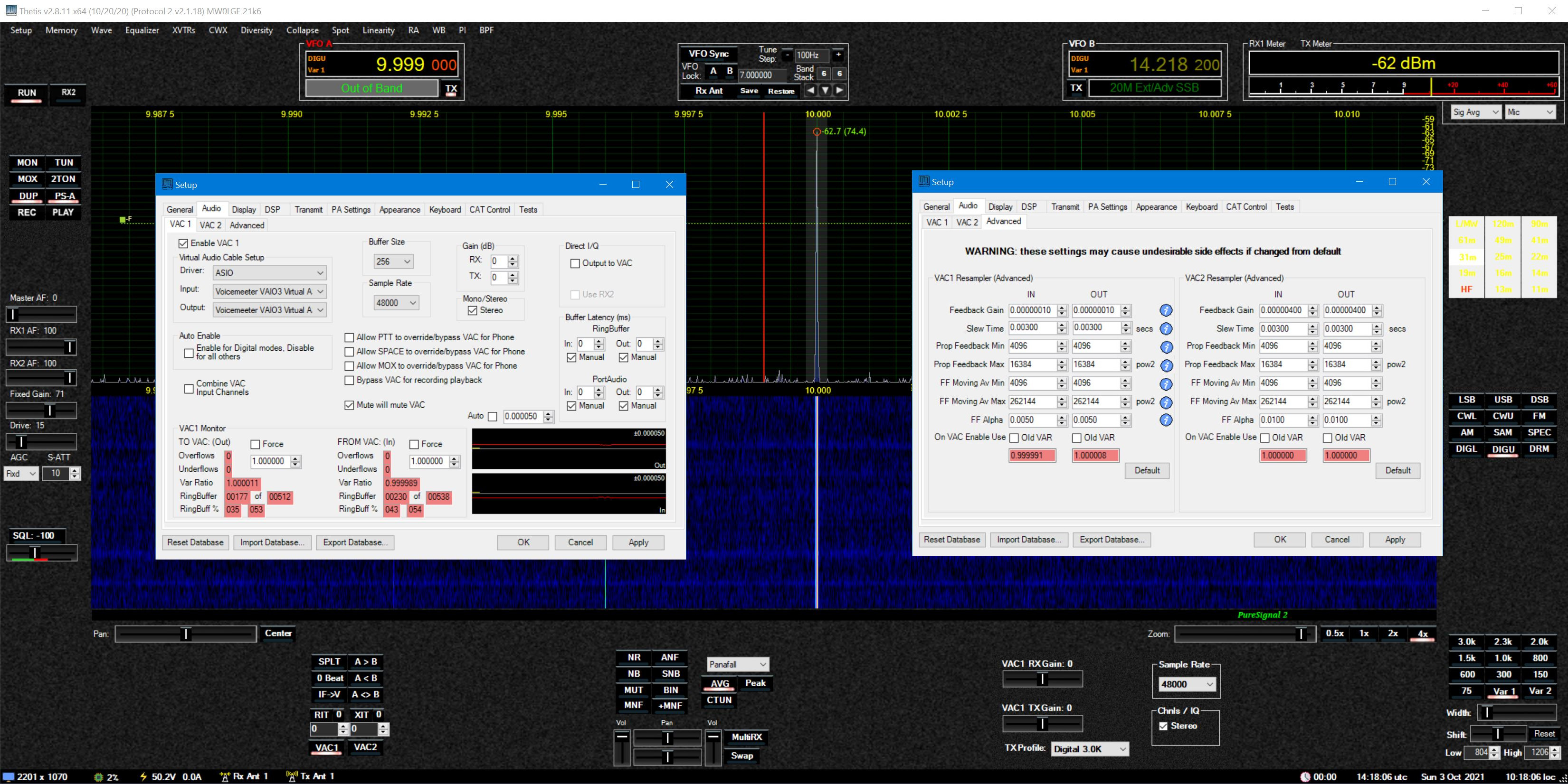

I spent most of today looking at frequency accuracy. I used a hybrid splitter to split my BG7TBL GPSDO output so I could continue to feed it to my 8000 reference input, and after putting on a big attenuator, feed it to the Ant 1 input at -63dBm.
I had the Bodnar available to the Presonus audio interface.
I used the fldigi FMT feature as my measurement device.
My take-aways so far:
- The resampler works well when everything is properly adjusted and one is not getting under/over-run counts. Typically ±0.001Hz slow variations with the GPS reference on the Presonus, twice that with the Presonus internal reference.
- Slightly mis-adjusting things so that I was getting a steady but slow diet of under/over-runs, say 60 per hour, the resampler was kind of a mess, wandering around strangely. But, still, not seeing anything worse than ±0.005 or so.
- Even force=on with the Presonus internal reference was good, but under/over-runs were much higher in this condition, and audible glitches were heard.
- Obviously a GPS reference on the Presonus with force=on was stellar. Unmeasurable variation. Rock solid.
- Under all conditions I had a strange frequency offset that I had to put into fldigi, -0.023Hz, even with the Bodnar selected in the Presonus and force=on. I could not tie that to Thetis tuning quantization. I have no idea where it's coming from. This is something I'd like to figure out.
Bottom line: any of these conditions would have been more than enough to easily achieve high honors (≤1Hz) in any FMT event, and are far more than adequate to run something like FT8. If things look stable in the VAC monitoring section then all should be well. We may be worrying about nothing here, although from an academic standpoint it is fun to look at.

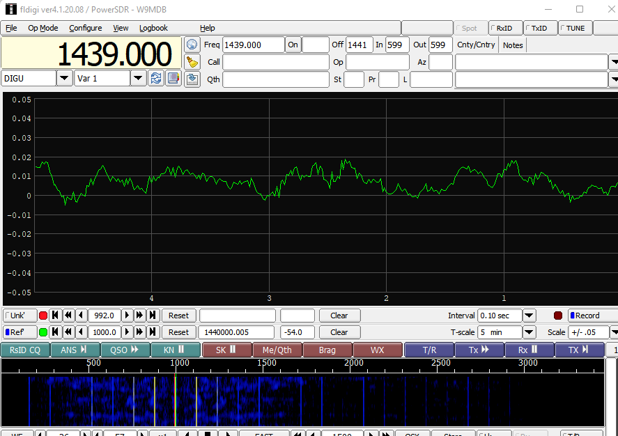

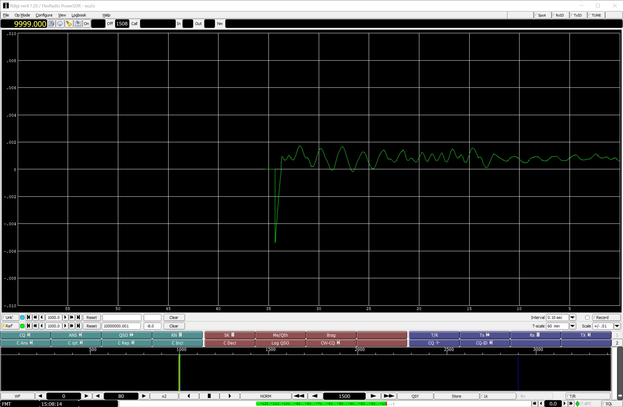

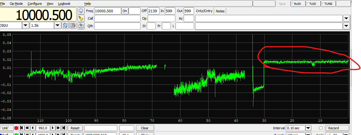

I got serious today and took a few hours of data. As before, my setup used a Mini Circuits hybrid splitter to split my BG7TBL GPSDO output so it could continue to feed the 8000 reference input and, after putting on a big attenuator, also feed the Ant 1 input at -63dBm. The Bodnar GPS reference was available to the Presonus audio interface, and the fldigi FMT feature was again the measurement device.
Thetis setup is as shown below (that's a composite image, not some special dual settings display
). Nothing crazy in the VAC advanced settings, just slowing down the feedback gain and FF alpha settings a bit from the default to gain better stability. Some step attenuation was added to lower IMD from the GPSDO 10MHz, and the passband was restricted to lower noise.
The computer was used for light web browsing while these experiments were taking place. No special measures were taken to restrict operating system activity.
If you right click any of these images and select "Open image in new tab" you will get them full size for easier viewing.
First up was a 6o minute test with the Presonus on its internal reference and the resampler active. Results were quite good. Very stable. There was clear evidence of a fast and slow loop in the repetitive pattern. You can judge for yourself what you think the periods are. The fldigi FMT configuration is as shown. A frequency offset in fldigi was necessary to get it close to zero. As before, I have no idea what is causing the offset. On the waterfall the input audio level was at -8dB, and there was at least 70dB of audio SNR, which is more than adequate.
Next I investigated what happens when you change feedback gain and FF alpha. Please ignore the startup transient. In the first approx. 20 minute period the feedback gain and FF alpha settings twice that of the results above. I had expected to see a change in periodicity but instead there is only a change of approx. a factor of two in the amplitude of the frequency variations. In the second 12 or 13 minutes or so the feedback gain and FF alpha were changed to 1/10 what it was in the first test. Again, this had a dramatic effect on the amplitude but not periodicity of the frequency variations.
After that the Presonus was switched from the internal frequency reference to the Bodnar GPS external reference. VAC advanced settings were set back to the starting condition as shown above. It took a good 20 minutes for things to settle down (not pictured). After they settled down, the results with the resampler are seen in the first 35 minutes of the data. You'll note the change required in the fldigi frequency correction. For the last 25 minutes Force was activated. Perfectly perfect, except for that annoying .023Hz frequency correction!
After all this my conclusions remain the same: any of these configurations would happily meet any requirements, from meat and potatoes phone and SSB, to FT8, to the most obscure FMT event. Under and overruns remained at zero throughout these tests after an appropriate period of stabilization had elapsed. No need to invest in a GPS reference for your audio interface, but the operator does need to do their part in smartly choosing VAC settings that work with their specific configuration. A GPSDO on the RF hardware can be quite worthwhile. IMHO, the default feedback gain and FF alpha settings need to be smaller than the current defaults. We can argue about how much smaller

I hope this is right place for this post.
I have a simple objective. I want to connect Thetis 2.9.0 using VAC to a VARA digital modem. Actually a VARA modem is a consortium of 17 different modems that are dynamically selected to deliver the best throughput possible depending on chosen bandwidth, received signal-to-noise ratio, and message size. Three bandwidths - 500, 2300, and 2750 Hz - are supported with speeds ranging from 18 to 8489 bits per second. VARA implements a TCP/IP-like ARQ control protocol to deliver error-free messages.
Based on the high interest and activity around the VarAC digital chat mode built on the VARA modem, I know my objective is shared by other ANAN/Thetis operators.
I use Voice Meeter Banana with ASIO drivers set to 16 bits and 48 kHz.
I have tried all of the different combinations of RingBuffer Latency both manual and automatic, buffer size, and resampler configurations shown on this and another thread. My understanding is that the PortAudio setting don't apply to ASIO drivers.
With the resamplers running (Force unchecked), the VARA modem will only receive data transfers at is slowest and most forgiving mode. When I disable the resamplers (Force checked), I get expected error-free data transfers at speeds consistent with received signal-to-noise ratio.
What am I missing?
Larry
What am I missing?
Larry
Larry,
You've posted nothing about what sort of performance the VAC diagnostics are reporting with the resampler enabled.
The first metric to look at are the under and overrun counters. Are you able to achieve conditions whereby those are not counting (you can reset them to zero by clicking on them)?
It is possible to use the resampler with VARA. I use the paid version VARA for Winlink and it works fine, ratcheting up and down through the various speed grades normally.
This is not relevant to your problem, but it's worth noting that ASIO is only running between Thetis and Voicemeeter. The connection between VARA and Voicemeeter is not ASIO (probably MME), however it appears that you have gone into the sound control panel and set the parameters for the various Voicemeeter virtual devices appropriately.
As background, I am a retired electronics engineer and have an appreciation for the task at hand, albeit a foggy one. Fifty years ago, I designed a time base corrector that stabilized the analog video stream from a video tape recorder to within broadcast video standards.
I am encouraged. The way Winlink and VarAC use the VARA modem is very similar. If you can achieve the higher and more demanding speeds, I should be able to do the same.
With auto ringbuffer latency (boxes unticked), I can achieve a zero over and underruns during receive. However, the frequency instability of the output is well outside the range of usable. Keying the transmitter throws in a transient and VAC out underflows jump.
Perhaps from the posts on the forum, I should have been able to determine a procedure to achieve my optimized results. If that exists and I missed it, sorry, could you please point me to it. Otherwise, suggestions of a starting point and procedure would be appreciated.
Yes, the Voicemeeter inputs and outputs have been set to 16 bit 48 kHz.
Larry
Larry

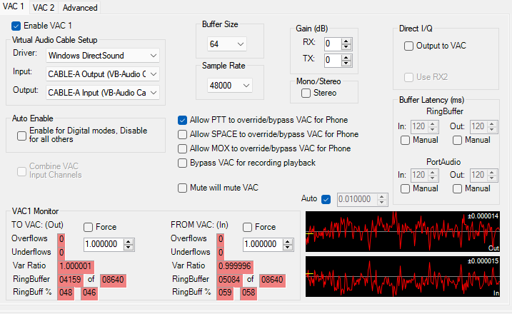

I have two PCs both relatively quick with Passmark CPU ratings in the 13,000 range.
I have tried different buffer sizes between 64 and 256.
I have one PC connected to my 7K which is what I had been focused on. I decided to try to apply what I had learned to my ANAN 100 attached to a different and slightly faster PC. That didn't go well.
Below with 256 buffer and ANAN 100.
After the feedback servo stabilizes with ringbuffer between 45 and 55 %, I can reduce the receive ringbuffer size to about 20 before getting over and underruns. Unkeying the transmitter triggers a quick batch of receive over and underruns as the servo is destabilized.
The transmitter ringbuffer is stable during receive and transmit at about 25.
A few minutes ago, I had a VarAC QSO with a station where we exchanged SNR reports of about +15 dB. Exchanges both ways were at the slowest 18 bps rate until I ticked the two Force boxes. Speed shot up to the maximum 270 bps for small chat size messages. I attribute that to the frequency slewing caused by the resampler.
In addition to ARQ, the VARA modem implements good forward error correction. My experiments show no real difference in VARA large message transfer speed or packet error rate with resampler on and stable or off. I think it is time to give up on this one. As an old and tired clock maker, I just want to tell time.
Larry
