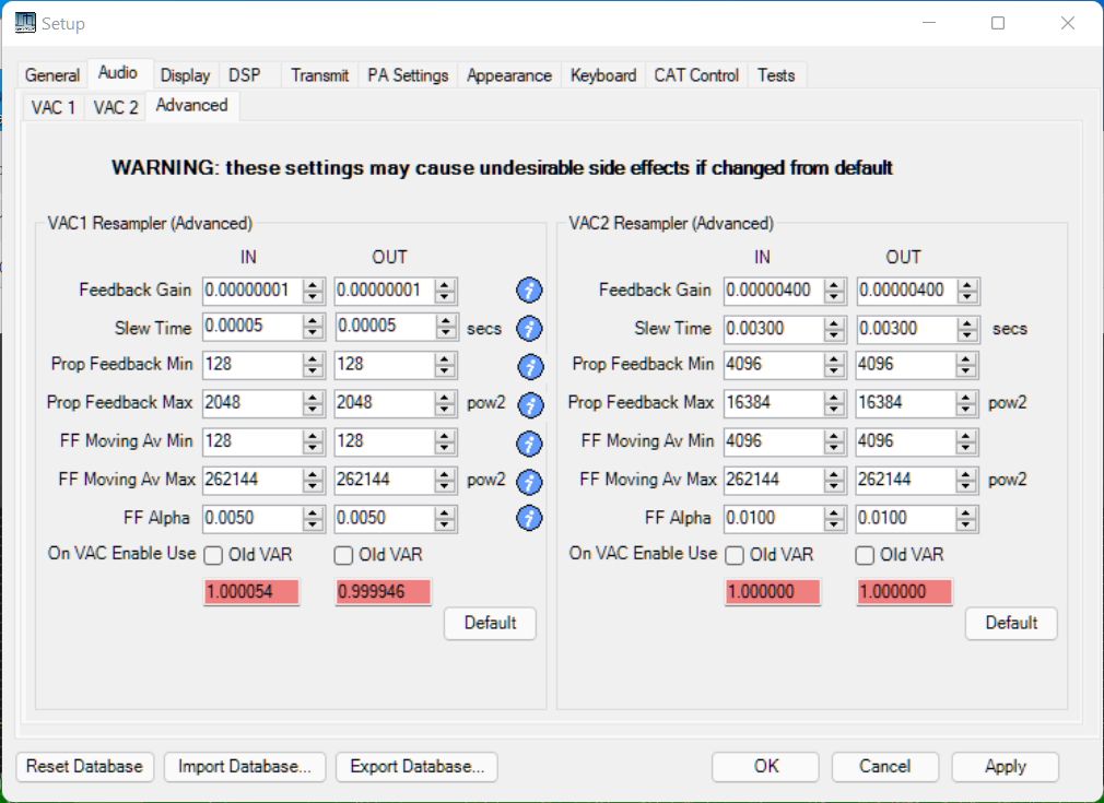

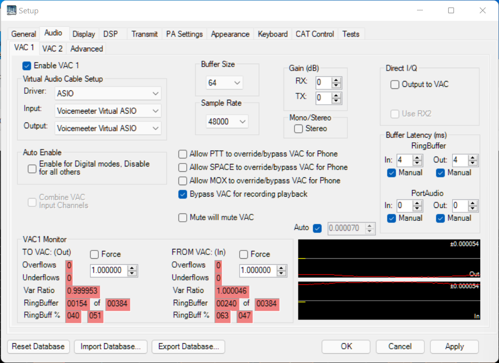

Thanks for posting your settings Mark. I am testing your advanced settings and I notice right away that the VAR ratios move in a much tighetr range once they settle down so looking really solid here.
K1LSB wrote:Scott,
FWIW, my latest VAC1 and Advanced settings appear to eliminate the need to uncheck/recheck the RingBuffer boxes after a Thetis session startup (at least for me).
I don't have any fancy clock hardware. And I've left VAC2 alone for now, focusing on VAC1.
Here are my current settings:

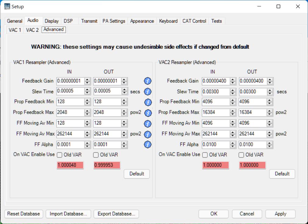

Tony EI7BMB wrote:Thanks for posting your settings Mark. I am testing your advanced settings and I notice right away that the VAR ratios move in a much tighetr range once they settle down so looking really solid here.
Tony,
Here's my latest Advanced settings, the most stable yet. Still no need to uncheck/recheck the RingBuffer boxes.
Audio Advanced.PNG (235.29 KiB) Viewed 55237 times

Mark,
I'm right in the middle of testing your "old" settings, don't want to change to your latest in the middle of the experiment. However, preliminary results show superior performance of your settings over the defaults, or my own less aggressive attempts.
Preliminary results:
- GPS + resampler: 1.4 counts/hour. Smack on 1.000000 var ratio. Interesting, buffer occupancy is skewed at 35 out, 65 in. This is a home run, best so far.
- GPS fixed (forced): 9.5 counts/hour -- this is an unexpected train wreck and it implies that something in advanced settings has an effect even when Force = ON. However var ratio remains smack on 1.000000.
- Internal reference + resampler: just started this 5 minutes ago, but already looking very good.
I feel like I need to wait 10-20 minutes before zeroing the counters with your settings though. They take a long time to settle.
More to follow tomorrow morning EDT.

w-u-2-o wrote:- It would be very good if others could try a revised Feedback Gain of 1E-07 (0.0000001) and FF Alpha of .005 and provide reports on the performance of those changes.
I tried those settings and got rather poor underflow/overflow results (max of 7 per field per hour).
Then I reduced the Feedback Gain to 1E-08 (0.00000001) and stability so far is astonishing! Been running for over 2 hours now and not a single underflow/overflow! And that's while rag chewing in Thetis and simultaneously using the computer for nonstop internet. No telling how long this stellar performance is going to continue but I did want to report my findings.
FWIW my computer is a slightly overclocked and heavily undervolted i7-6700K on an MSI motherboard with 16 gig of RAM and an old GTX 970 video card.
Here's all of my current settings:
Audio VAC1.PNG (250.09 KiB) Viewed 55071 times
Audio Advanced.PNG (232.52 KiB) Viewed 55071 times
