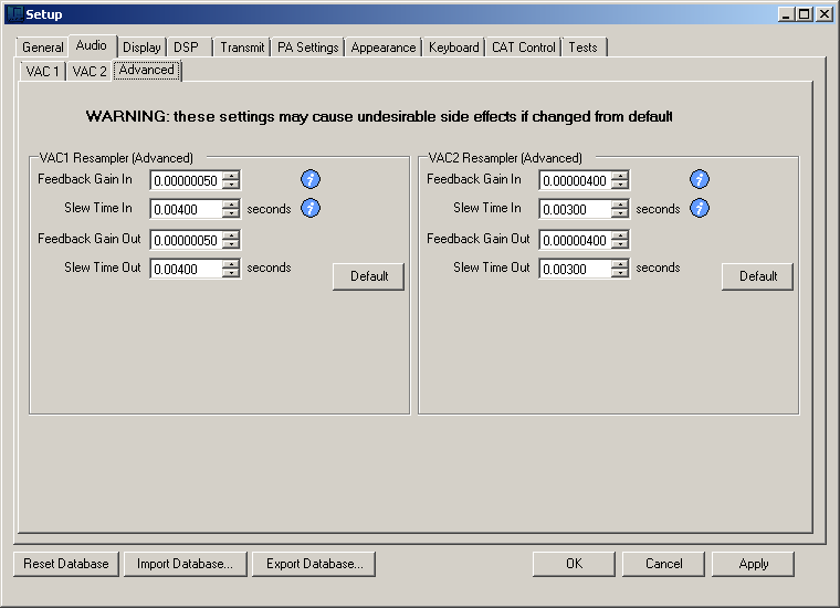

Recently, Richie exposed a couple of controls, accessible via the "Advanced" tab. Of the two, really only the Feedback Gain setting matters with respect to the aforementioned stability.
For a couple of days now I've been messing with the Feedback Gain settings, unfortunately with little improvement.
The standard, default setting for Feedback Gain is 4x10^-6, aka 0.000004, or 4 millionths of whatever the unit is. In the interests of brevity I'm just going to call this "4", and other settings will be relative to that.
I've tried settings between 5 and .1, relative to the default setting of 4. 4 definitely seems to be the largest setting that gives good performance. Lower settings seem marginally more stable. But there's really no difference in gross stability at any setting between 4 and .1. I can be sitting in front of the machine, and everything might be fine for 20 minutes or 200 minutes. Then, for no apparent reason, over or underflows just start rapidly accumulating. As usual, to stop this I will cycle one of the Ringbuffer manual checkboxes to get VAC to restart.
I'm now trying the absolute minimum setting possible, which is .01 relative to 4 (or 0.00000001 if you prefer). More to follow with those results.

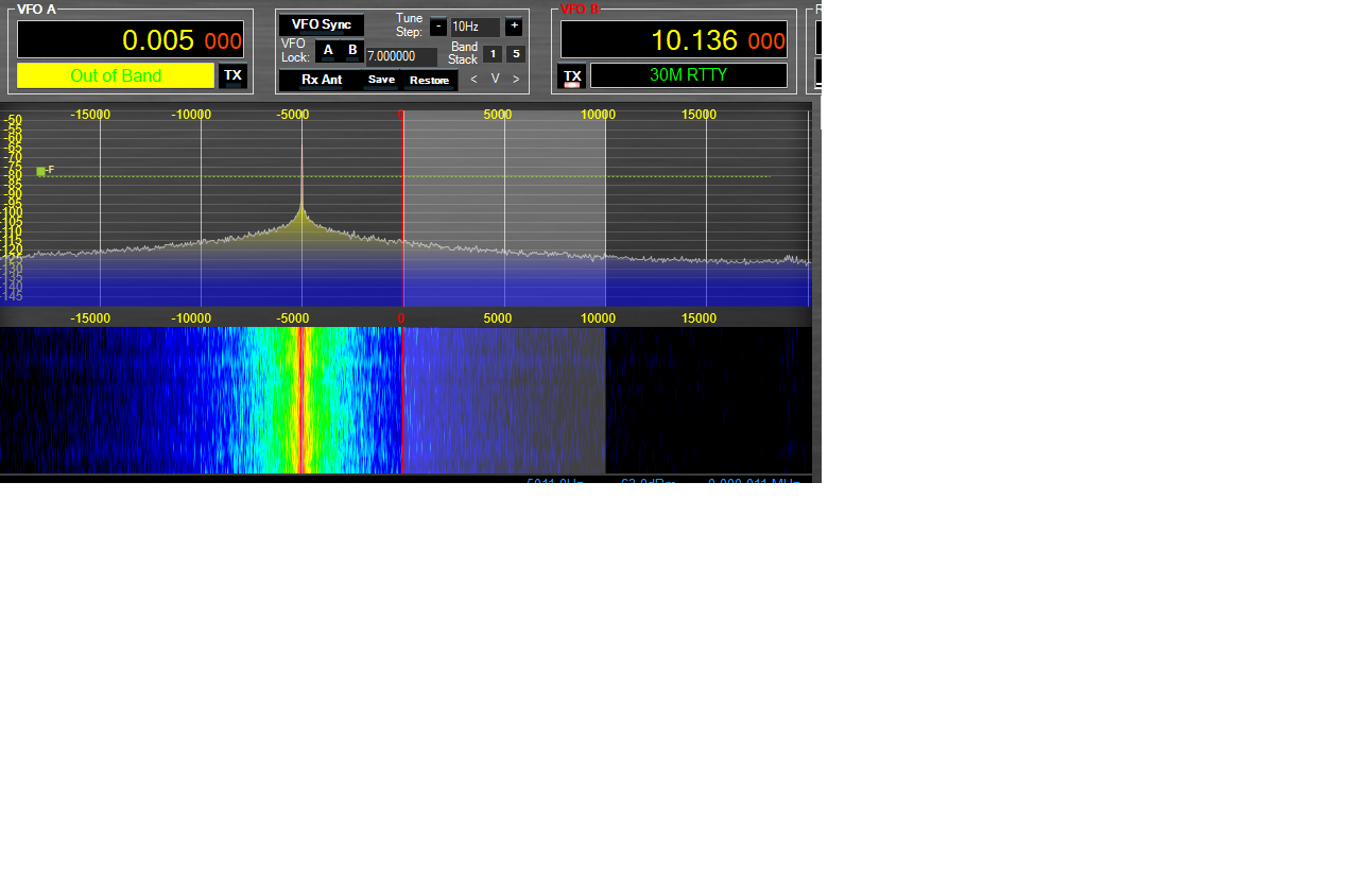

Using 21h and 2.1.18 firmware on 7000DLE MKII.
The wideband behavior and panscope look odd in this video.
I see base level variations in the wb that are worrisome when average is turned off.
And the way an FT8 transmission looks is odd. It starts off with the noise level in the panscope high and the wb display shows jittering noise level. Then the panscope level decreases and the wb stabilizes after about 4 seconds of transmit both at the same time.
This has been going on for a long time...P1 and prior versions so not new behavior.
https://www.dropbox.com/s/4idhmw7socq93 ... .webm?dl=0
Another thing I noticed while playing with wb and panscope is the 0Hz line -- the level does not seem to depend on a signal being present but does oscillate when an antenna is unplugged/plugged. I assume this is a bogus frequency resulting from the FFT 0th element.

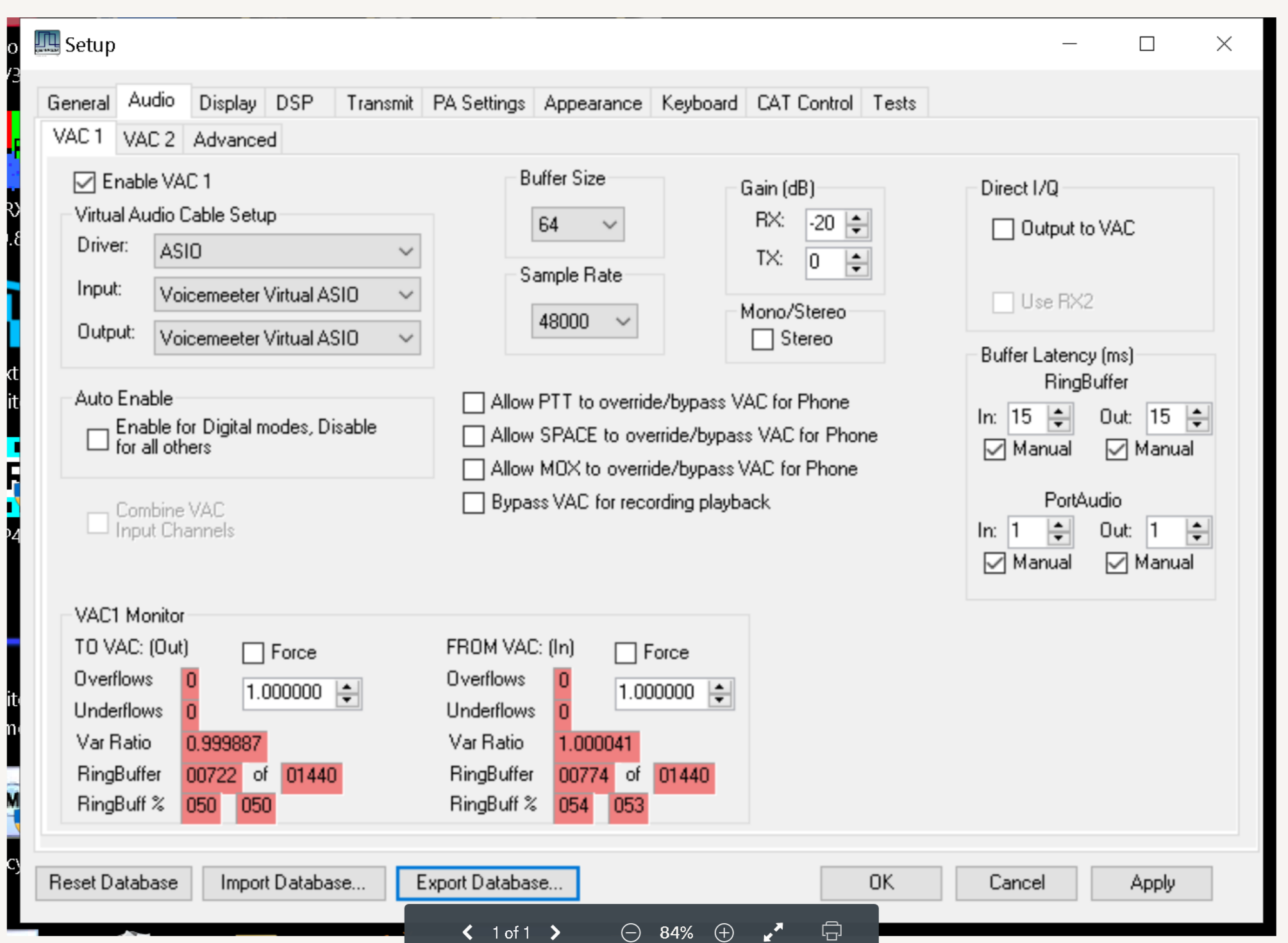

I just quickly set up some values from Walters examples above (interesting to know about the 0/1 setting for PA), and let it sit for a few minutes.
Initially var ratio was swinging either side of 1.0, but eventually settled, perhaps took 3-4 minutes. I am not sure if it will switch into an unstable state at some point however. Defaults used for feedback/slew. I must add that I tend to ignore all this stuff, sick everything on forced etc. and just work datamodes ;)
So the issue is that it will become 'settled', and then for some reason just becomes unstable? I wonder if something is going on with usb or audio sub system, perhaps power management.
As I type this, it has been 1.000000 for 5+ mins but I have just noticed that it is starting to swing around again on the 'TO VAC' and has reached 1.000000 again and has settled there. This was followed by 'FROM VAC' doing the same thing, but has settled again.

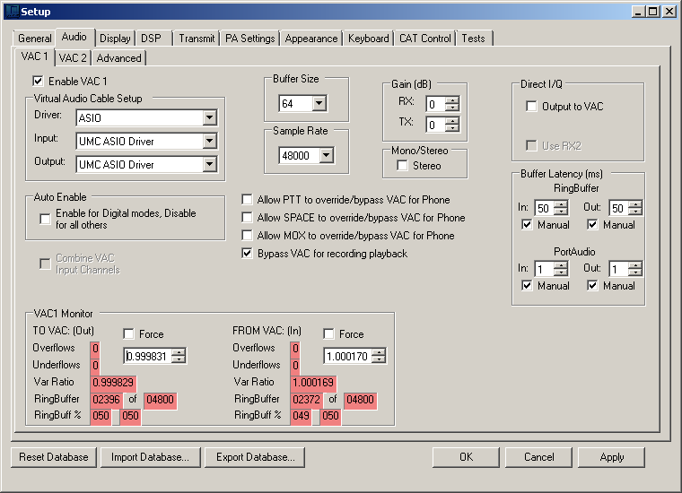

I ran it all night, around 15hrs, power saving for screens disabled. No buffer under/overruns reported. During the first 2-3hrs I was actually multiplayer gaming with some friends using the same PC without any impact on Thetis it seemed.
I did however discover some interesting behaviour, which can be seen in the following vid. Something interesting and odd happened around 8mins into the vid.

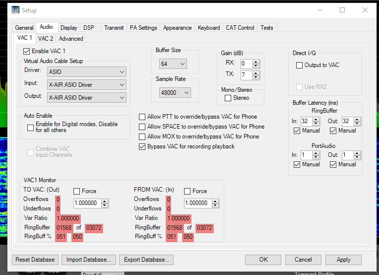

Bryan & Walter: great info from both of you.
Richie: I think you are not seeing the problem because you are using a very high Ringbuffer value. I typically use a value of "0".

I notice my VAR ratios never really settle down, I thought this was the normal behaviour for this but perhaps not. here's my set up.
W4WMT
Posts: 346
Re: Thetis 2.8.11-21+++ VAC advanced controls: results and discussion
Post by W4WMT »
Tony EI7BMB wrote: I notice my VAR ratios never really settle down, I thought this was the normal behaviour for this but perhaps not. here's my set up.
Hi Tony,
What you show there is perfect! It's completely normal for the var ratios to "hunt" slowly in the last 1 or 2 digits. The resampler is doing its job in a textbook fashion. Your overflows & underflows are zero. And the loop is steering the sample rates in order to keep the ringbuffer exactly half full.
Perfect in every way!

Still randomly unstable at RB 32. Not worth going bigger, that's already a ridiculously large value.
W4WMT
Posts: 346
Post by W4WMT »
w-u-2-o wrote:Still randomly unstable at RB 32. Not worth going bigger, that's already a ridiculously large value.
Do the random instabilities vanish when you Force=1 ?
