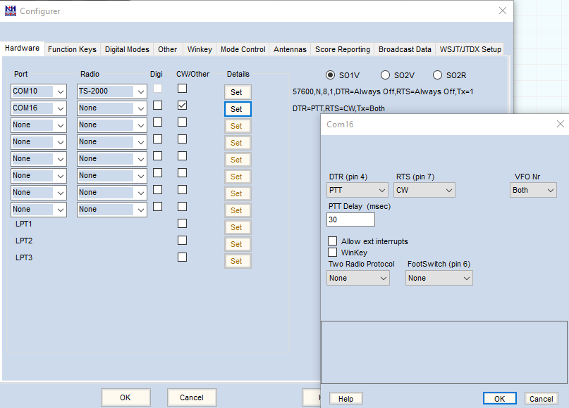

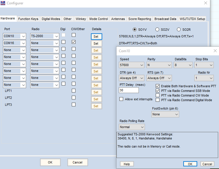

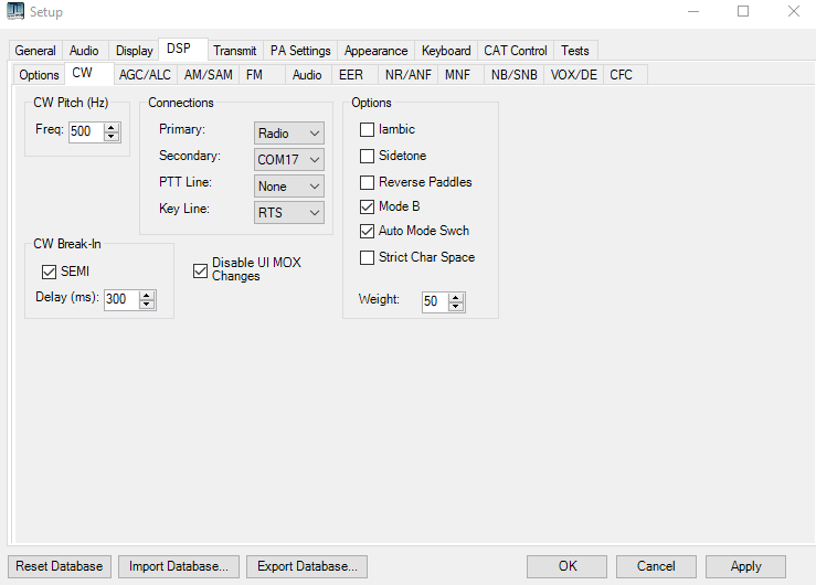

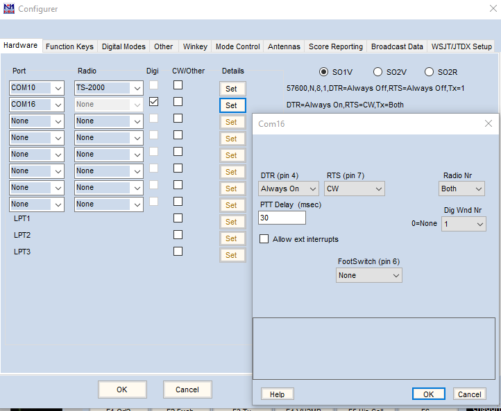

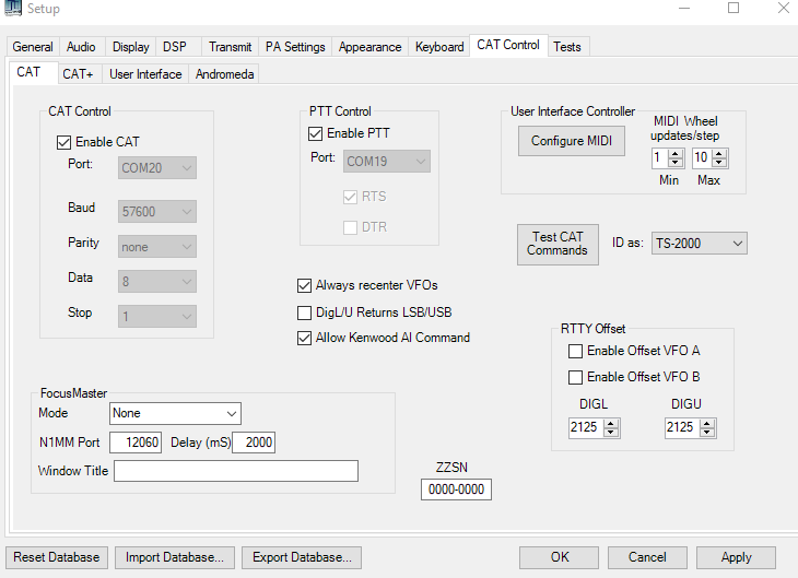

I wanted to set up Thetis & N1MM for CW and doing something that is not right and Thetis goes in to transmit immediately when power on.
Thank you for the support. I have unchecked the CAT PTT temporarily.
Bhanu
VU2MB

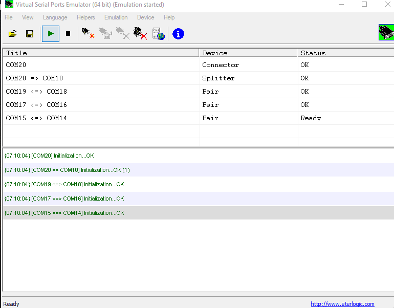

Here is my setup
VSPE setup.png (20.44 KiB) Viewed 10048 times
N1MM Com 10 Setup.png (56.17 KiB) Viewed 10048 times
N1MM Com 16 Setup.png (45.77 KiB) Viewed 10048 times
Thetis CAT setup.png (41.72 KiB) Viewed 10048 times
Thetis CW setup.png (31.47 KiB) Viewed 10048 times

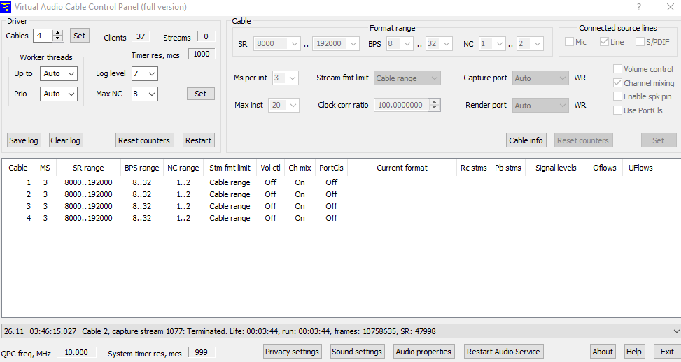

VAC Setup.png (50.68 KiB) Viewed 10048 times

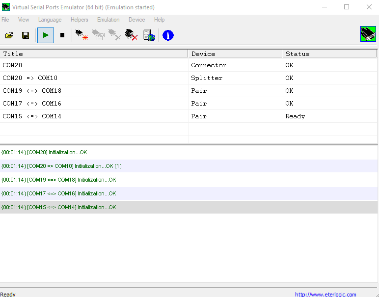

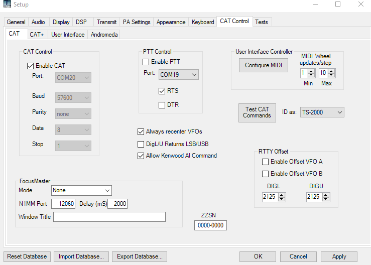

I have CW working perfectly in N1MM. Here's a few things I've observed that are wrong in your setup:
1. CAT needs to be done with a port pair, not a splitter.
2. In N1MM, COM16 needs to have the Digi options OFF, and the CW/Other option ON.
3. In COM16 "Details", DTR should probably be "Always OFF". (FWIW, I use DTR for CW and RTS "Always Off", but that shouldn't matter as long as you've matched it in Thetis, and you have.)
4. I've had better luck with radio type set to "Flex5000 RX2". This change may or may not be necessary, but it works for me. If you make this change, be sure to go back to COM16 "Details" and set VFO Nr to "1".

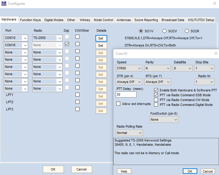

Thanks for your response and I have found the reason why it was doing all strange things like triggering PTT when clicking CW Break in SEMI.
We had a visitor with his 5 years son and while he was roaming around he must have come to the shack and put the headphone Mic connector to the Anan 200D's key socket as The Mic plug ( Sennheiser E835) and Headphone pugs were occupied and headphone's mic plug was hanging so he plugged it to the key's socket.
After removing it things were easy and working again. I have no issues with Splitter and using it for long following Rafael's NN3RP guide and I am attaching it herewith. It has been already there though in this forum.
Attaching screenshots of my working setup for CW.
Thank you & 73
Bhanu
VU2MB
