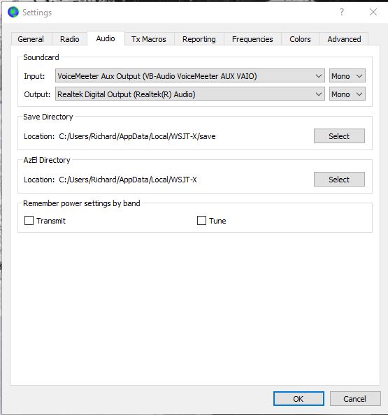

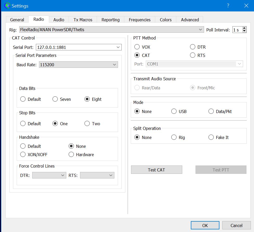

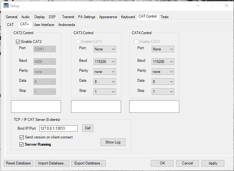

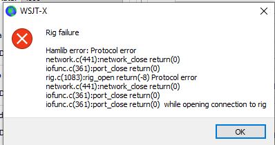

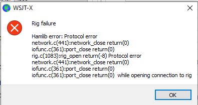

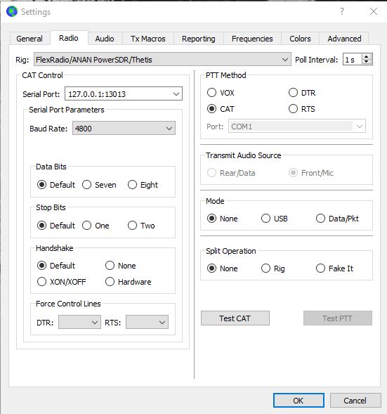

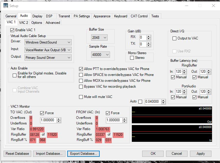

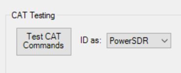

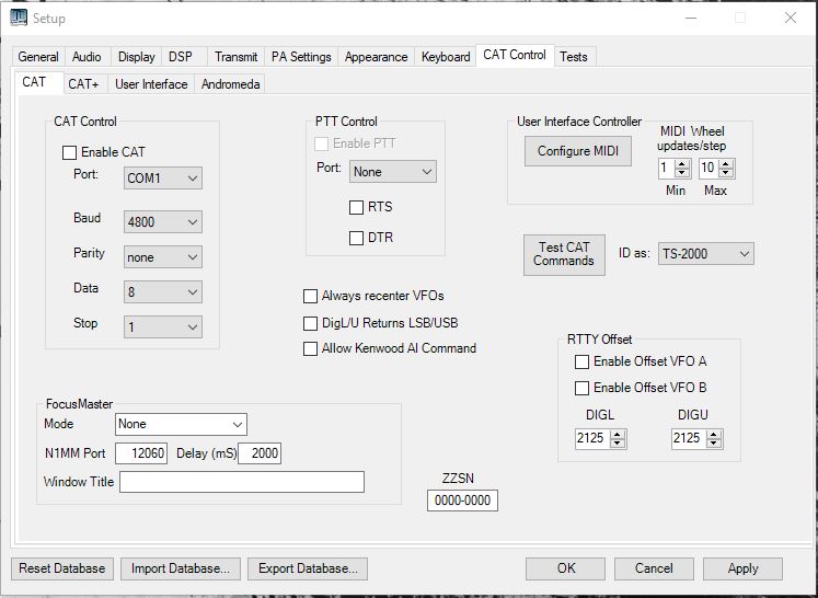

Here are my settings. CAT is not working, see error window below:
WSJTX Radio.JPG (58.24 KiB) Viewed 8474 times
WSJTC Audio.JPG (47.21 KiB) Viewed 8474 times
Thetis CAT+.JPG (61.65 KiB) Viewed 8474 times
Thetis CAT.JPG (66.57 KiB) Viewed 8474 times
WSJTX CAT Error.JPG (25.5 KiB) Viewed 8474 times
Re: FT8
Check out Scotts excellent tutorial , you can skip straight to 8. http://wu2o.dyndns.org/wu2o_vac_tutorial_2.html
I'm guessing you do not have virtual serial ports set up. If you are using JTDX you also have the options of TCI control (JTDX only) or TCP/IP cat control as Mike mentioned above.
More info on TCP/IP here viewtopic.php?f=22&t=4249
w9mdb
Posts: 465
Re: FT8
Post by w9mdb »
Turn off the "Send version on client connect".
That is not TS-2000 or PowerSDR compatible.
I have fixed that in the latest Hamlib but I believe WSJTX 2.4.0 still has the problem with the older Hamlib.
You can upgrade Hamlib in WSJTX and hopefully still use the "version" option.

Posts: 6110
Re: FT8
This should not be that hard. Based on your screen shots your setup has many problems with both CAT and audio. Let's fix CAT first.
Here are screen shots of my WSJT-X and Thetis setup. Make sure you are using the latest versions.
1. Upgrade to Thetis 2.9.0.6 if your are not already running that. Get it here: https://github.com/ramdor/Thetis-2.9.0/releases. Use the 64 bit version.
2. Completely uninstall WSJT-X.
3. Install WSJT-X pre-release 2.6.0-rc1. Get it here: https://physics.princeton.edu/pulsar/k1jt/wsjtx.html (scroll down until you find the 2.6.0-rc1 release installer). Use the 64 bit version.

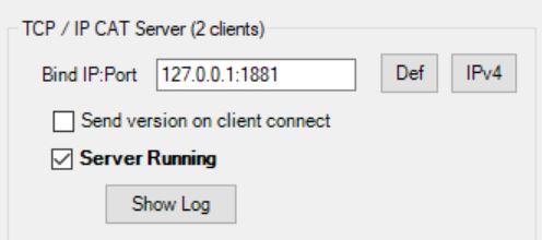

4. In Thetis > Setup > Serial/Network/Midi CAT > Network make it look like this:
The port number I use is 1881, but you can use the default.
Also make Thetis > Setup > Serial/Network/Midi CAT > Options look like this:
5. In WSJT-X make your radio settings look like this:
Again I use port 1881, you can use the default port that Thetis provides. Whatever you do, the port numbers MUST match in both WSJT-X and Thetis.
6. Test your CAT connection.

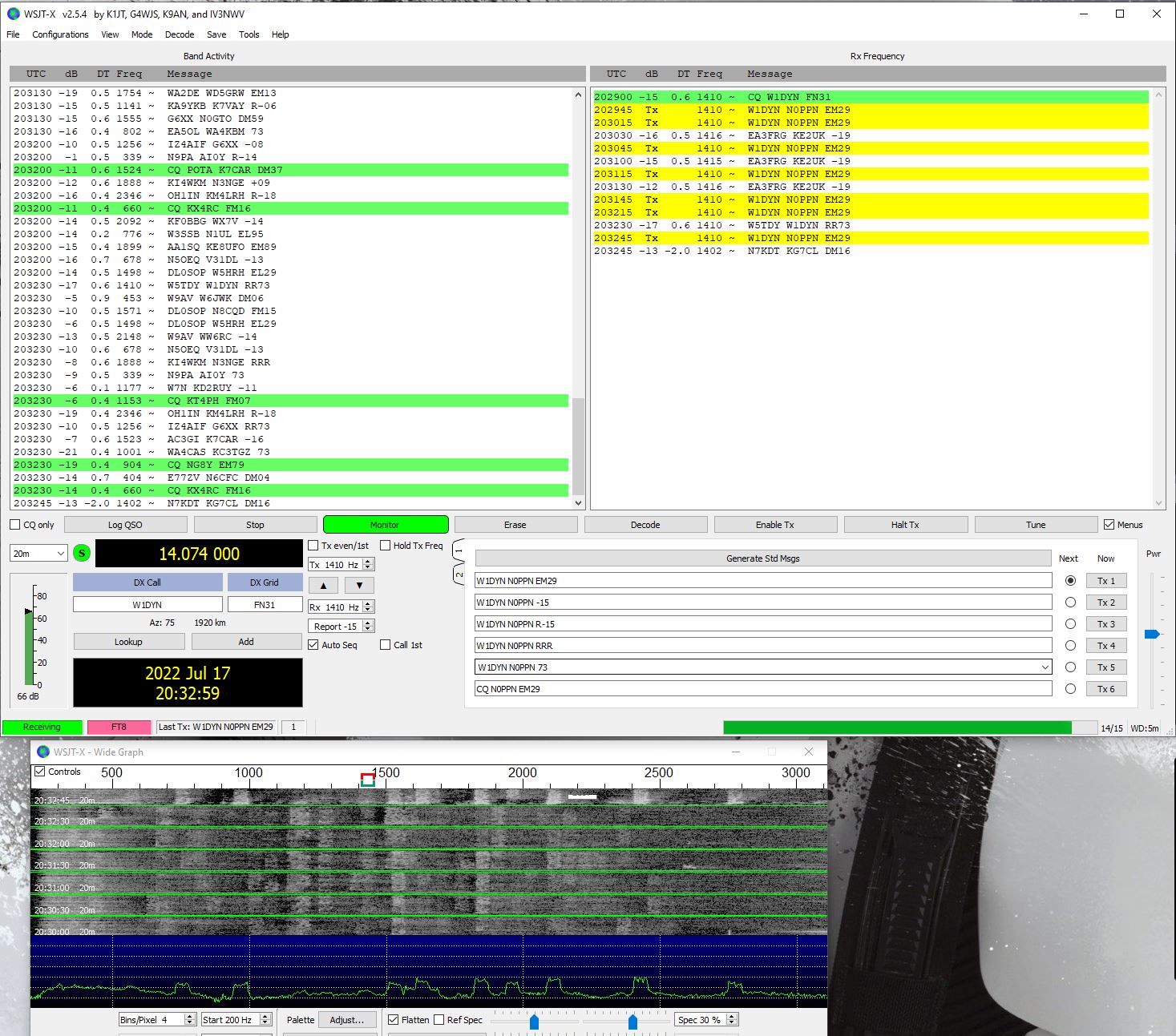

Thank you! I am now decoding and seeing what I think I should be seeing.
However, when the WSJT is in TX there is no FWD power from the radio?
Thanks again!
wsjtc tx.JPG (367.23 KiB) Viewed 8377 times
Posts: 6110
Re: FT8
rdscuba wrote:Thank you! I am now decoding and seeing what I think I should be seeing.
That's because, as I wrote in my first response above, based on your screen shots your setup has many problems with both CAT and audio. We've fixed the CAT, now let's fix the audio.
You need to assign Thetis to one Voicemeeter virtual channel, and WSJT-X to a different Voicemeeter virtual channel, then connect them to each other in Voicemeeter.
My setup is very unlike yours, so I cannot simply post screen shots for you to copy.
For this to work you need to be running either Voicemeeter Banana or Voicemeeter Potato, not the base Voicemeeter version.
1. In Voicemeeter, click the A1 Hardware Output button and assign it to your default PC speaker audio output.
2. Assign the Voicemeeter VAIO channel to both the VAC input and output in Thetis. Use the MME driver, not Directsound (Directsound sucks ;) )
3. Assign the Voicemeeter Aux channel in WSJT-X, again for both input and output.
4. In Voicemeeter click the "send" buttons (marked A1 through B2 or B3, depending on the version) as follows:
a) On the Voicemeeter VAIO channel click the B2 button, this will send audio from Thetis to WSJT-X.
b) On the Voicemeeter Aux channel click the B1 button, this will send audio from WSJT-X to Thetis.
5. Leave all other buttons in Voicemeeter OFF. Leave all Voicemeeter volume sliders at the default 0dB.
With luck this will provide basic functionality. There are some other tweaks we probably need to do, but, again, let's go for the basics first.
