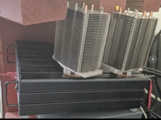

Using the info at the link you sent, I'm doing a little test using a pair of recovered CPU radiators with heat sink compound over the hot spot near the top side of the rig. Be nice if they drew off enough heat without a fan. Must have about 3 dozens fans . If the radiator fins don't do the job I use your quiet fan recommend.
Tnx 4 help
Fins on Anan.jpg (59.69 KiB) Viewed 10732 times
