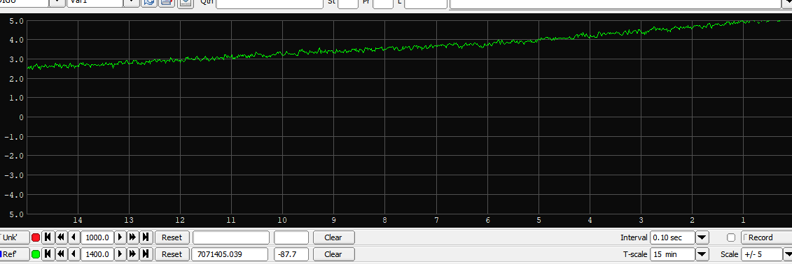

I run a monthly frequency measurement test. Have been using an ANAN 100 with a Bodnar Mini GPS as the 10MHz sync and an Omni VII with another Bodnar Mini GPS as a reference frequency. FLDigi provides the means to use the reference frequency to very accurately measure a frequency. In this setup I can usually measure my transmit frequency to 0.001Hz standard deviation.
I just set up my new 7000DKE MKII and I'm seeing way too much frequency drift on the 7000 trying to measure a reference frequency. I've got the Bodnar on 10MHz fed into the 10MHz jack on the rig and the 2nd Bodnar on antenna 2.
In the best of worlds this line should be flat.
I also noticed a huge frequency drift occurring during FT8 decoding....totally unacceptable.
So what's the story with the 10MHz reference -- is there something else I need to do to enable it? Is the Bodnar square wave no good for it? The manual says nothing about it.
I'm hoping there's a fix for this as I don't want to be disappointed with my purchase. I do have a BG7TBL I can hook up too...so will try that next.

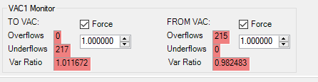

Scott, can you please clarify how to disable the resampler? is that done by simply checking the "Force" boxes? I think you told us once but I've forgotten..
Re: 7000DLE MKII Frequency Drift
Yes, that's correct. Also take a look at the link to the resampler topic I posted above.K1LSB wrote:Scott, can you please clarify how to disable the resampler? is that done by simply checking the "Force" boxes? I think you told us once but I've forgotten..
Resampler was disabled
Is there some jumper I have to change?Mike W9MDB
Hi Mike,
Were those overflows & underflows static, or were they accumulating on you while you were measuring your drift?
Do you know how to click on the counters to reset them back to zero? That helps you to keep track of recent events.
You have to get these counters to zero, over long stretches of time (minutes), or all bets are off for the kind of freq stability you are looking for.
73, Bryan W4WMT
73, Bryan W4WMT

Bryan--his resampler is disabled. Those counts are therefore meaningless.W4WMT wrote:Hi Mike,
73, Bryan W4WMT

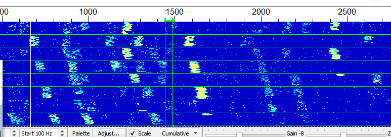

I have both an ANAN 100 and 7000DLE MKII now. Just got the MKII and setting it up and testing.
The Omni VII I've been using is able to measure the Bodnar to within 0.001Hz std deviation even with it's frequency drift. You may not be familiar with FLDigi's FMT capability....I worked with Dave W1HKJ to implement it. It's uses by most of the FMT participants now.
Check out the drift on the FT8 watefrall....this is thermally related even though I'm just putting out less than 2 watts (amp does the rest.
This can't be oscillator drift....it's like the frequency reference has no reference at all.
I'm on firmware 2.0.

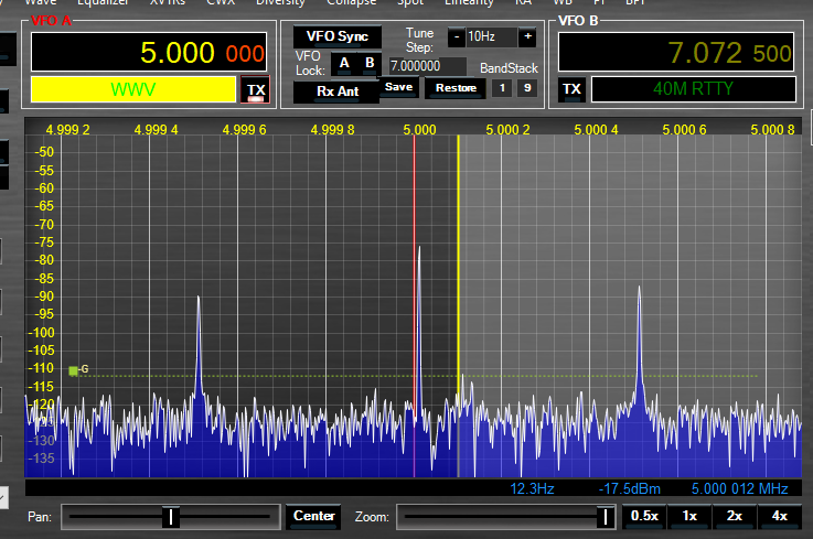

Tuned to 5MHz -- correction set to 0
While doing this the rig drifted from about 20Hz too high to 20Hz too low.

Even with the resampler disabled, we still want the ringbuffer to behave.w-u-2-o wrote:W4WMT wrote: Bryan--his resampler is disabled. Those counts are therefore meaningless.
Each time the receive ringbuffer underflows, a VAC buffer's worth of samples gets dumped on the floor.
That's going to drive the drift measuring algorithm completly bonkers!
73, Bryan

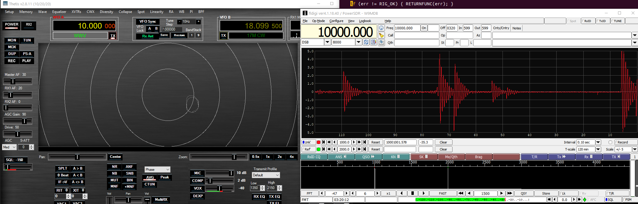

Mike--that measurement is no good. You have to be in DSB mode. Please make another video.w9mdb wrote:Tuned to 5MHz -- correction set to 0
And here's a video of the Phase
https://www.dropbox.com/s/0r5bs5ya26ep0 ... .webm?dl=1
DSB mode makes no difference...but here 'tis...
https://www.dropbox.com/s/xakamn5qaprlb ... .webm?dl=1
Is there newer firmware than 2.0? Surely other people would be seeing this too from the recent shipments. I'm thinking I have a bum unit.

Bodnar has 1.16 and have been measuring this thing to 0.001Hz since I've had it.
32mA on the Bodnar and turning it on/off shows no change in the phasing.
Could something have popped loose inside?
Would opening it void the warranty?

Yes...the DSB phase display is ever so slightly worse without the GPSDO.
Same problem with drifting....I see 30Hz drift in the FT8 waterfall.
I've contacted Apache support for a warranty claim..has to be a bad rig....

FWIW, I run a dual ported Bodnar GPSDO on my new 7000. Works fine. The WWV DSB Phase display swims around two or three times per second with nothing connected to the 10Mhz ref input, then locks right in when the GPSDO is connected.
73, Bryan W4WMT

Doesn't matter what the calibration is -- it's drifting +/-30Hz with or without the GPSDO.
I'm 100% confident this is a bum rig.

I had my new 7000LE MKII repaired as it couldn't sync at all and was drifting horribly (50Hz or so).
Now that I have it back it's better...but still not good by any stretch.
Wild excursions happening. Never saw anything like this on the ANAN 100.
I sure can't be the frequency reference for the ppFMT I've been running with this behavior.
And spending another $80 to send this lemon in for repair again is not something I look forward to...especially since it seems it wasn't repaired correctly the 1st time.
The circular pattern in the phase plot just slowly tracks around the inner circle.
Slowly tracking around is normal. That's from ionospheric induced Doppler. Can you post a video of that?
Assuming the radio is now ok it may be that you have a virtual audio problem to solve.
That diagonal drift is something I ran into with fldigi early on when I was figuring out my Anan.
My “fix” was to ensure VAC and everything in the chain was 48kHz, buffer to 2048 and clicking “force” on the resampler. I left the buffers on auto and I was good to go at that point.
I have a 7000 but I don’t think this is a hardware thing, I think it’s a sampling rate issue. I’ve been rock solid ever since I set up this profile and saved it as “fldigi” which I toggle to for digital mode use with my VAC.
The fldigi WWV calibration mode is handy to run because you can see the line that develops go from angled to straight when you get the toggles toggled correctly.
