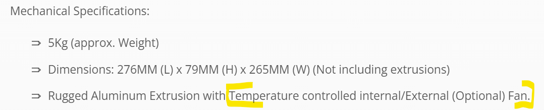

The fan does not seem to be temperature controlled in any way. It does not appear to change speed, and there is little to none warm air being expelled from any vents on the case. The only cooling seems to be conduction into the extruded chassis.

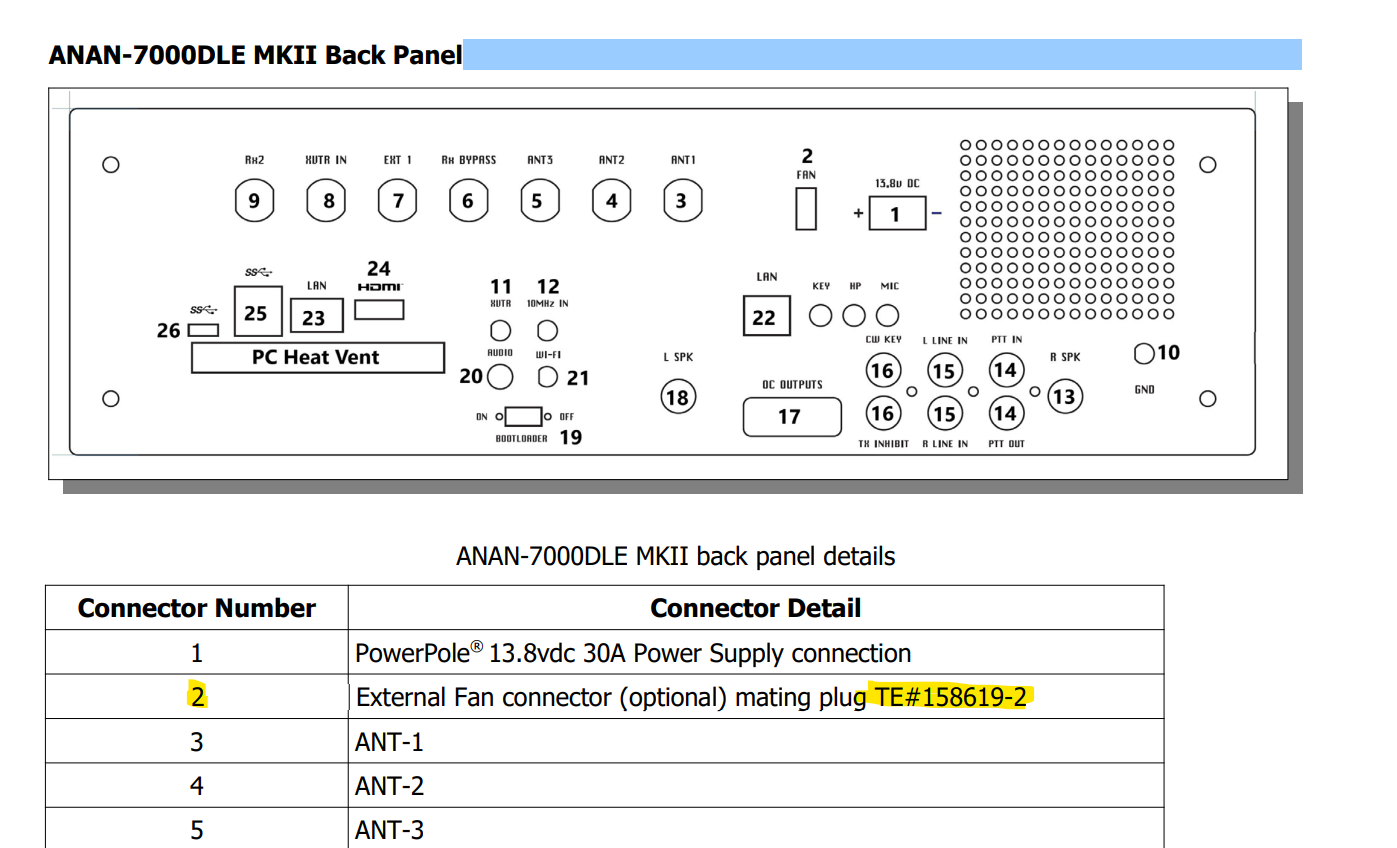

Do you know where one can purchase the right connector for the external fan connector? I have tried to lookup the given part number but haven't been successful in locating it for purchase.

At one time the design did include a fan controller, but the implementation of that circuit was "sub-optimal" and it was abandoned in later versions of the 7000DLE. I don't know why they simply didn't fix the design in later versions. You can read more about that here: viewtopic.php?f=17&t=2682&p=13874
Then there were a batch of MKII units that came out with no external fan power connector. You can read about that here: viewtopic.php?f=17&t=3914&p=19403

If you searched this forum for "fan connector" you would have found this post very quickly: viewtopic.php?f=17&t=2646&p=4349Do you know where one can purchase the right connector for the external fan connector? I have tried to lookup the given part number but haven't been successful in locating it for purchase.

Fine, they need to fix the website then. The product specifications still indicate a temperature controlled fan. They are advertising features not delivered. Seems like its been at least 2/3 years since that change was made. Why isn't it updated? There were able to update it with new or changed selling points, so no excuses.w-u-2-o wrote:At one time the design did include a fan controller, but the implementation of that circuit was "sub-optimal" and it was abandoned in later versions of the 7000DLE.

Thanks for the link. I searched for the part number as indicated in the manual (TE#158619-2) and couldn't find it. Hopefully this post will serve any future customers that come looking for the right connector.w-u-2-o wrote:If you searched this forum for "fan connector" you would have found this post very quickly: viewtopic.php?f=17&t=2646&p=4349

Thanks for the digram . Think I might try an external fan although there are posts for second internal fan on my 7000 mk2 . I replaced the original fan with a quieter unit with temp sensor so might use that type again for a second internal fan.

The current web page:Fine, they need to fix the website then. The product specifications still indicate a temperature controlled fan. They are advertising features not delivered. Seems like its been at least 2/3 years since that change was made. Why isn't it updated? There were able to update it with new or changed selling points, so no excuses.
