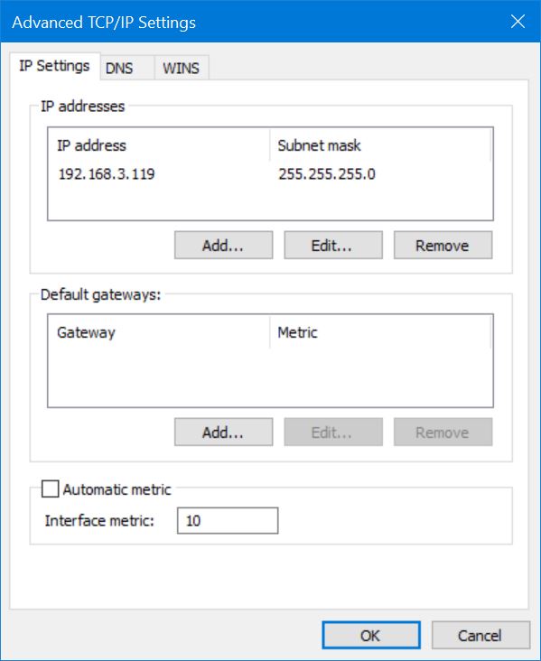

Metric on the laptop set to 1 and same for the desktop, actually they are configured both the same. And the NIC that has the internet on it is set for 100 so that all seems to be correct.

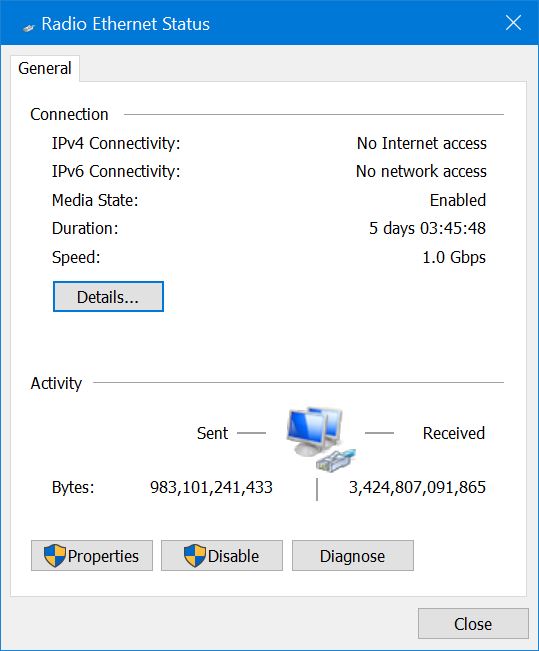

Super basic questions: do you get a link light on the ANAN when it is running in normal mode (not Bootloader)? Do you get a link light on the PC NIC? Do you see any traffic?
Firewall should not affect outgoing pings, but turn it off, and turn off anti-virus, just to be sure.

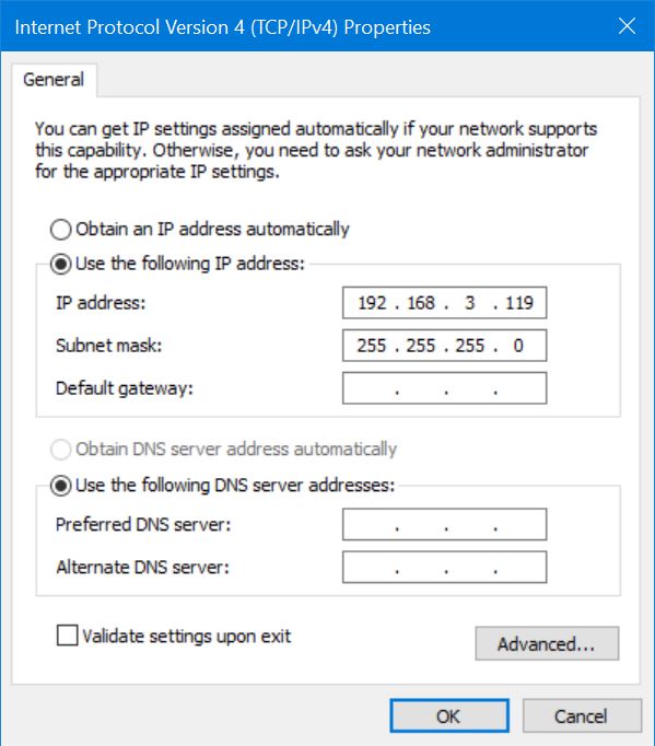

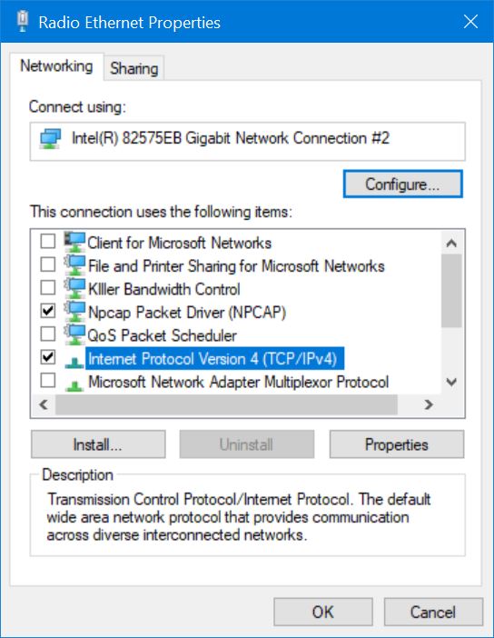

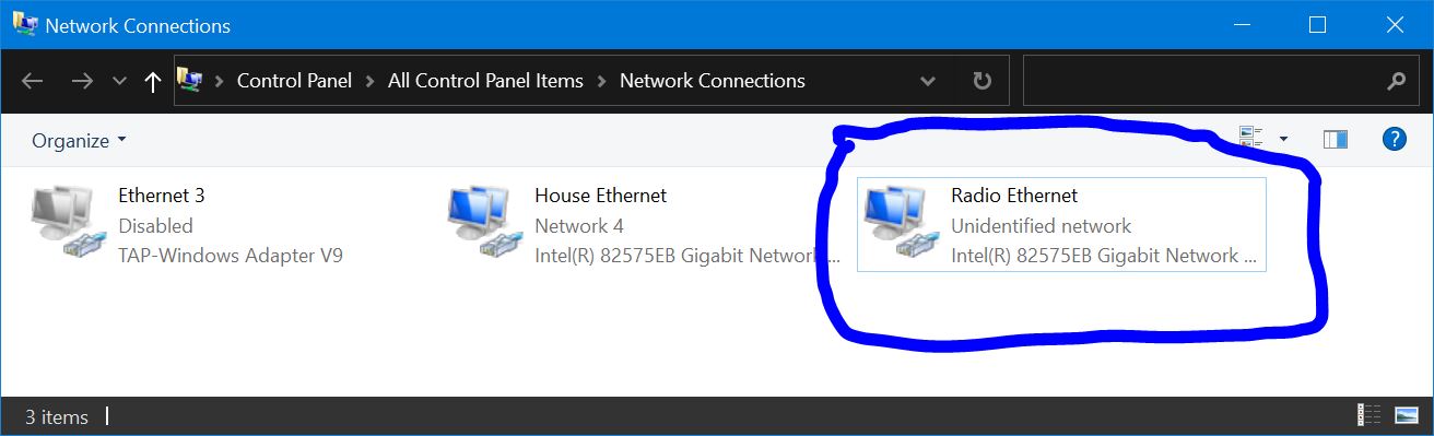

I have a dual NIC setup. No Wi-Fi (remember that counts as a NIC). House network is 192.168.1.x with a metric of 100. Radio network as shown. Every unnecessary protocol is disabled. ANAN IP is set to 192.168.3.2. It showing GigE speed because I'm running P2.

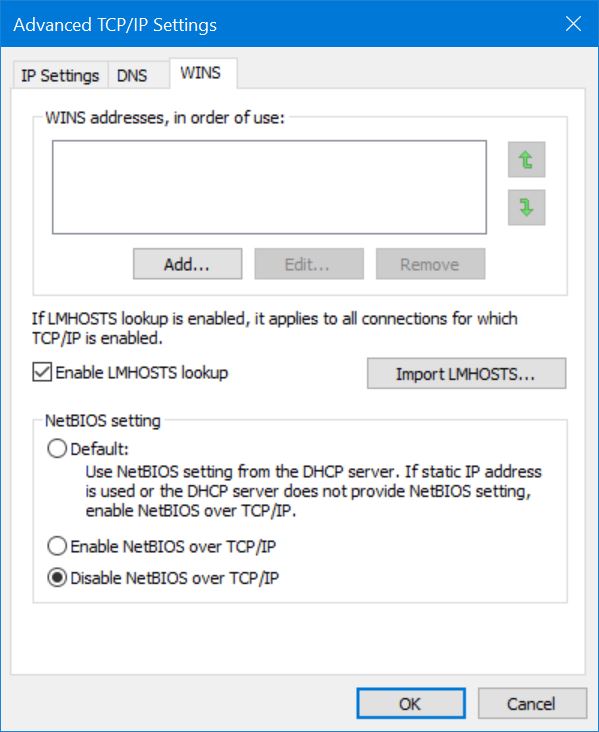

Only thing I changed was on the NIC config screen,,,
Advanced TCP/IP Settings, WINS tab
Default was checked, I unchecked it and checked Disable Net BIOS over TCP/IP
Pings coming back normal now from the ANAN
Powered up PC and PowerSDR hit power on and BINGO, we are a blip on the radar.
I just have no idea how that NIC config got changed. But now all the code in the ANAN has been loaded fresh so thats always a good thing.
