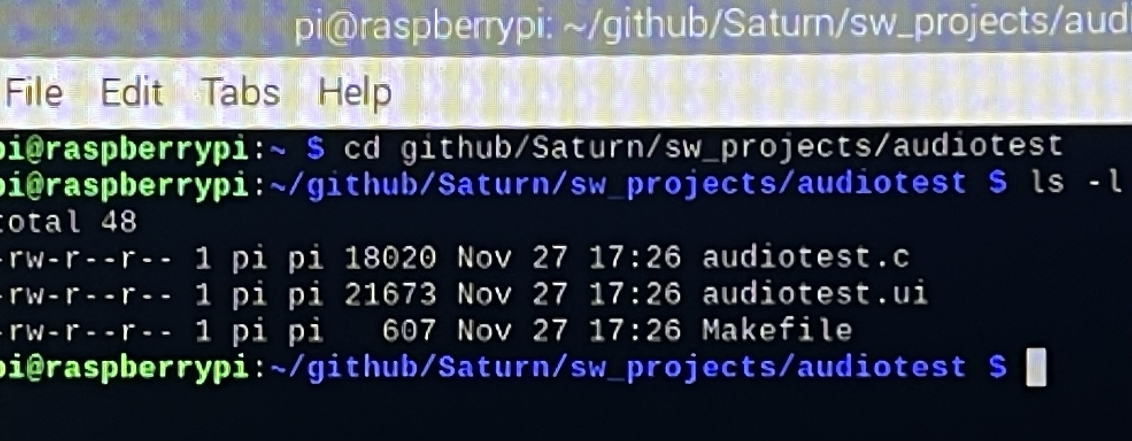

Re: G2 distorted audio using TRS and standard mic input
Good Morning,
Please find attached a pic of what is listed…audiotest.c appears to be first on my list, with only 3 files in that location.
Thanks once again, I really appreciate the help.
73 Rich
73 Rich
- IMG_2007.jpeg (772.51 KiB) Viewed 25737 times
Hi Rich,
Your audiotest directory looks like the application has not been built yet.
From the audiotest directory, try typing:
make
then you should be able to run it:
./audiotest
make
./audiotest

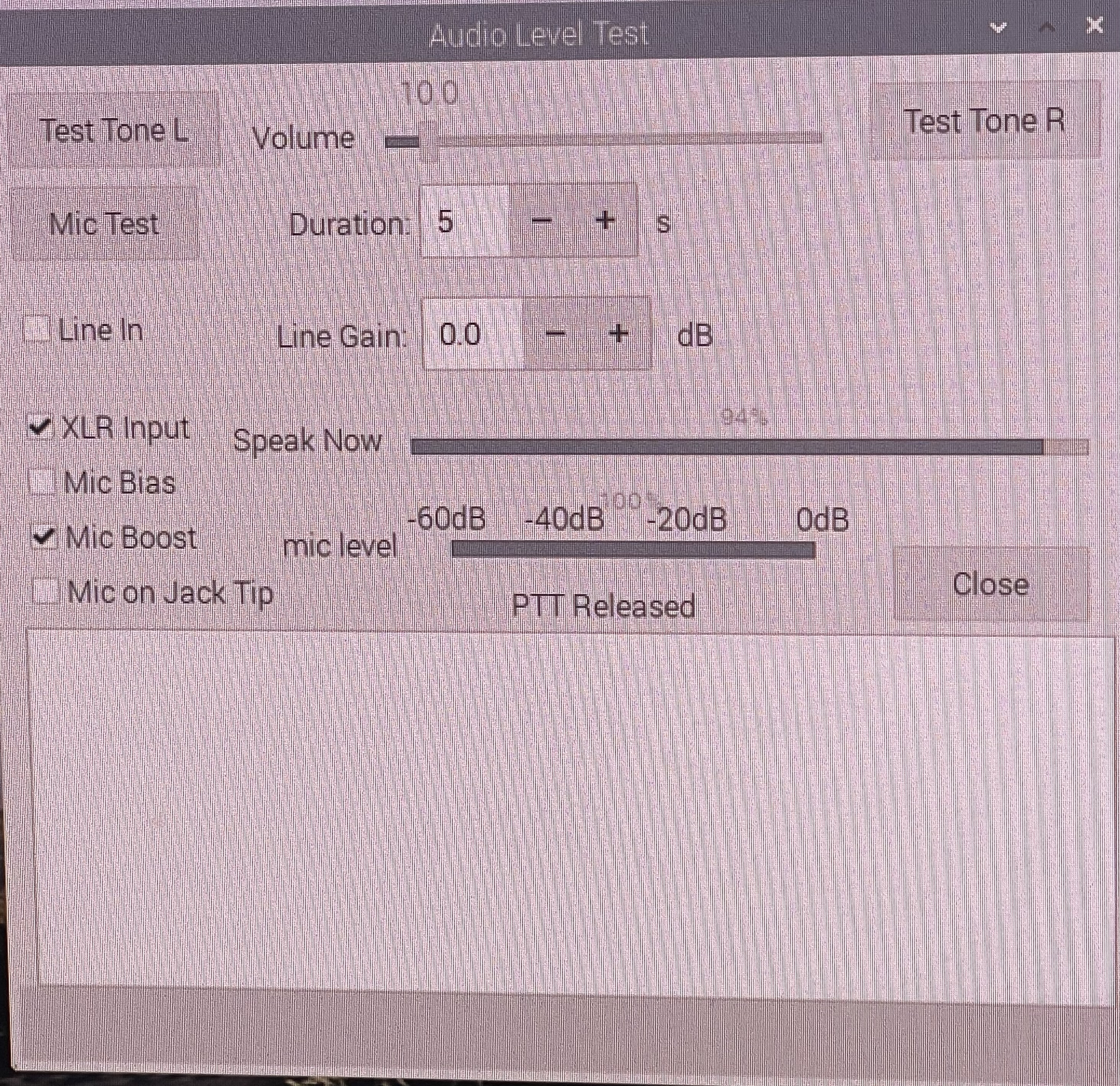

Hi guys,
Well audiotest app does not record any audio from the XLR input. My Electrovoice RE320 is plugged int the XLR input with a converting cable from XLR to balanced 1/4” plug, with wiring checked as recommended in the manual. PTT is my foot switch into the PTT socket on the back of my ‘no screen’ G2. So no outboard gear, just mic and PTT. Every cable connected is laden with ferrites as I was concerned about RF, although the noise witnessed on transmit, does not sound like RF…more like waves of white noise over the top of my voice when recorded on WebSDR and witnessed on the G2 ‘MON’ output.
So not sure what to do next. The audiocheck app implies I have no audio on the XLR input (only recording the click of the PTT) even if I employ the ‘mic boost’. Yet I’m clearly TXing audio, even if it is with a huge amount of noise.
Your thought once again would be much appreciated.
Many thanks in advance,
Rich
Rich
laurencebarker
- Posts: 329
did you select the XLR check box to choose that input? It works fine with my microphone.
Laurence Barker G8NJJ
Good Morning Laurence,
Yes, XLR was selected with no response, just a ‘click’ at the start of the test as the PTT is depressed. Then tried with the mic boost, just in case drive was too low, but still no audio. I’ll check again in a couple of hours and confirm all settings.
Thanks as again,
73 Richard
Thanks as again,
73 Richard

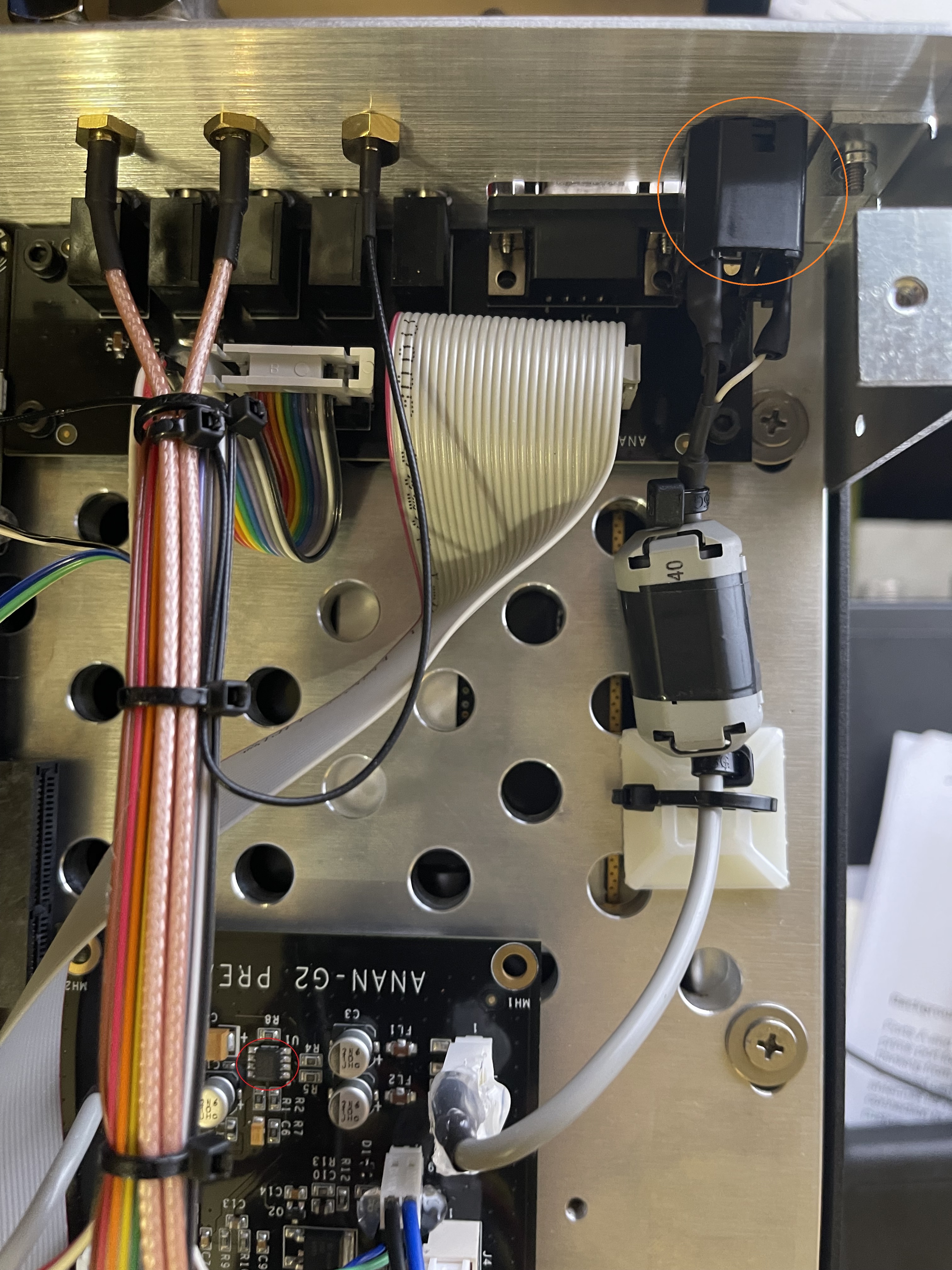

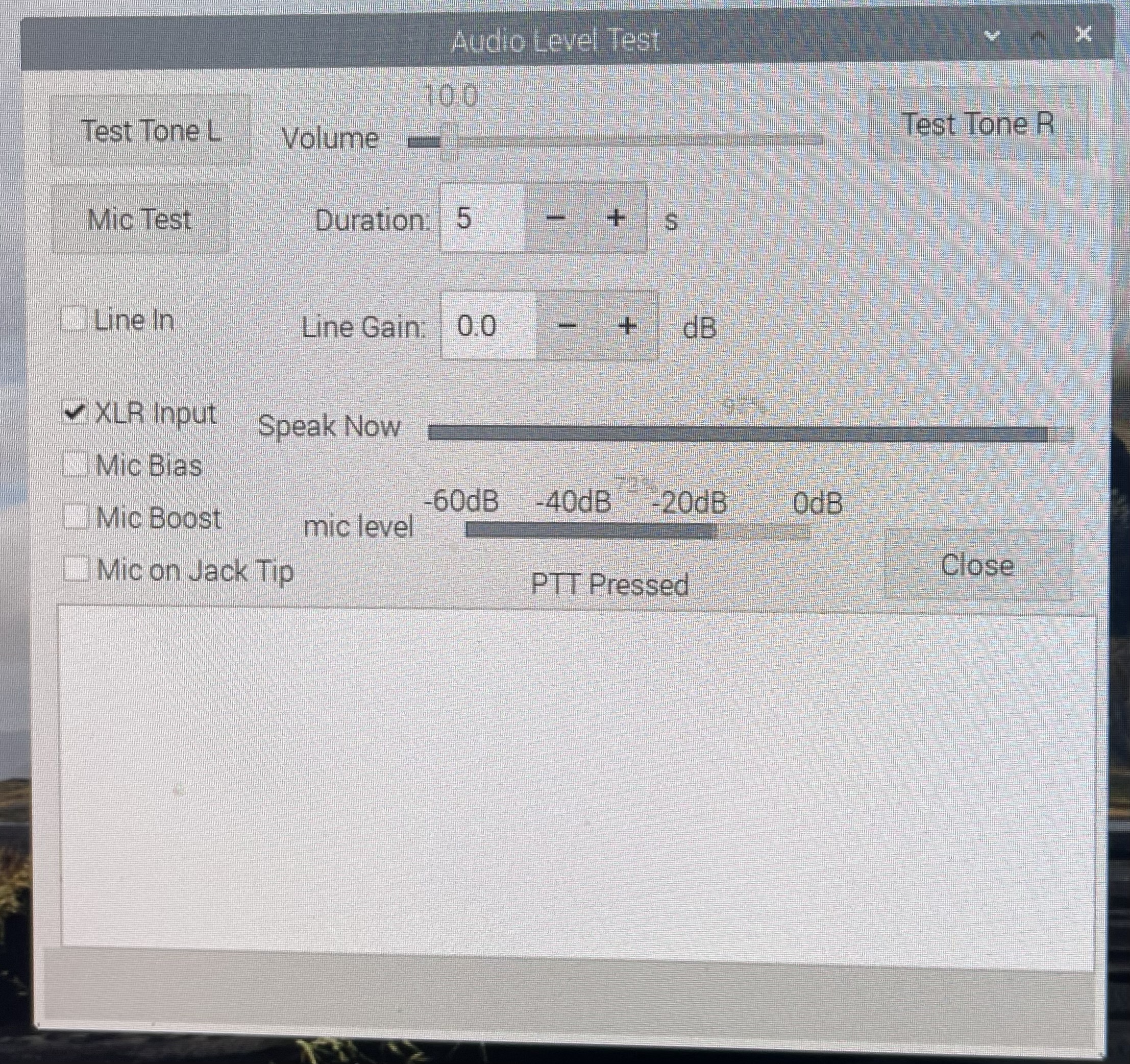

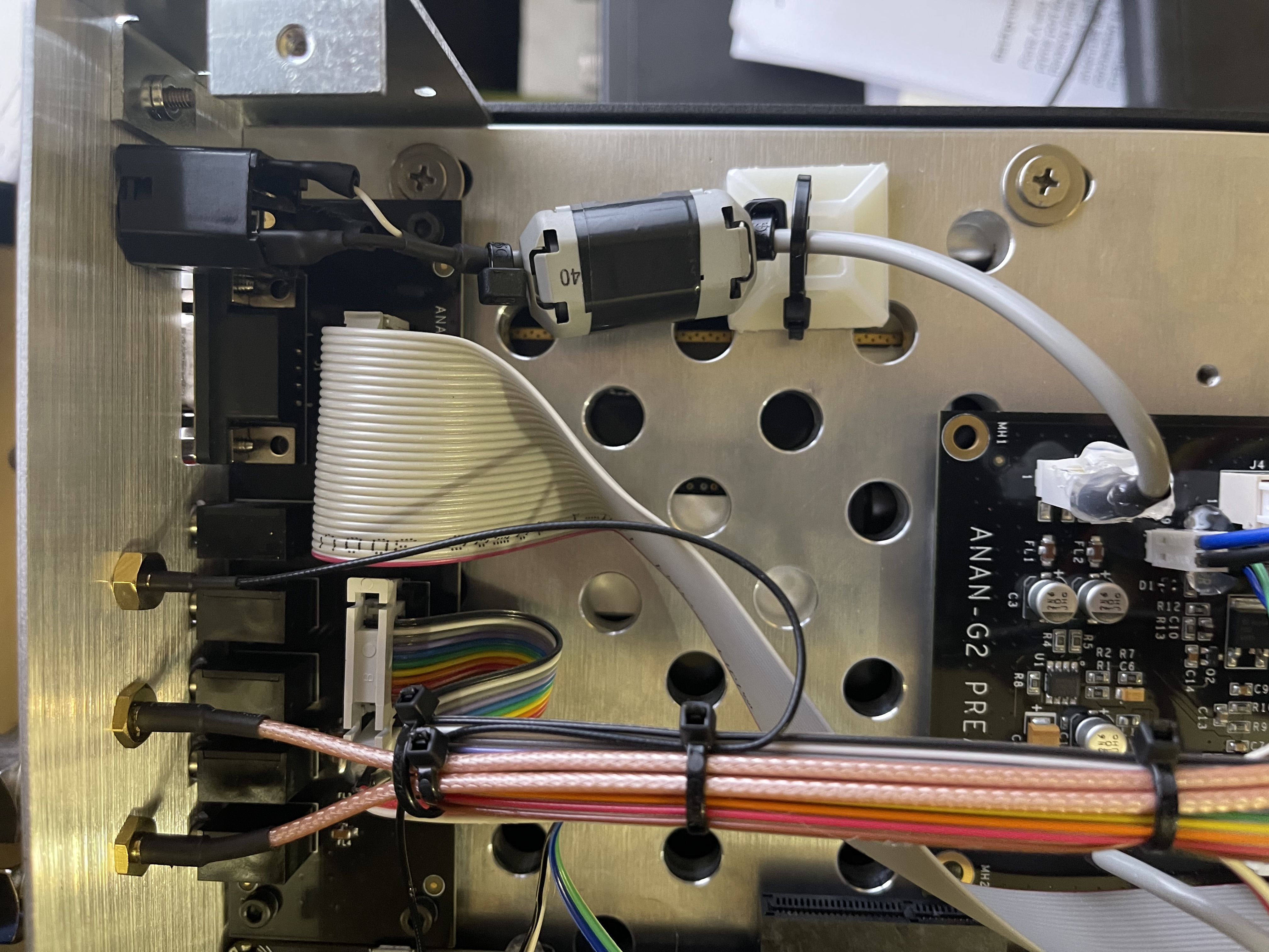

Hi Guys,
Further to the comments above I spotted N4VFR’s video on you tube “unboxing a G2” …in this video Darren removes the top cover and fits a clip on ferrite on the XLR to Preamp cable…as recommended by his friend Art. So as I’m having so much trouble getting audio without noise from the XLR socket I thought I’d try this out…only to find when I got inside that Apache Labs have already fitted a large grey ferrite on the cable, cable tied it in place near the socket and wrapped it with insulation tape. I haven’t seen another G2 with this factory fitted ferrite as yet.
Anyhow is this an admission that something is not quite right on the socket? I’ve still got -20db of noise on audiotest with no boost and 0+db of noise with the boost, even with No Mic plugged in.
I fitted a further 2 ferrites to the cable, which as had no effect.
See pics of factory fitted ferrite and my audiotest running with boost and No mic attached…smae noise level whether mic is attached or not.
Needless to say I’m going to forget the XLR socket for now which is a shame as I admire Apache Labs for its inclusion. If anyone has any further ideas or solutions feel free to post. In the meantime I’ll be running audio into the unbalanced rear mic socket with the Neutrik Balanced to Unbalanced transformer.
All the best, Rich
All the best, Rich
- IMG_2084.jpeg (4.13 MiB) Viewed 25268 times
- IMG_2060.jpeg (2.44 MiB) Viewed 25268 times

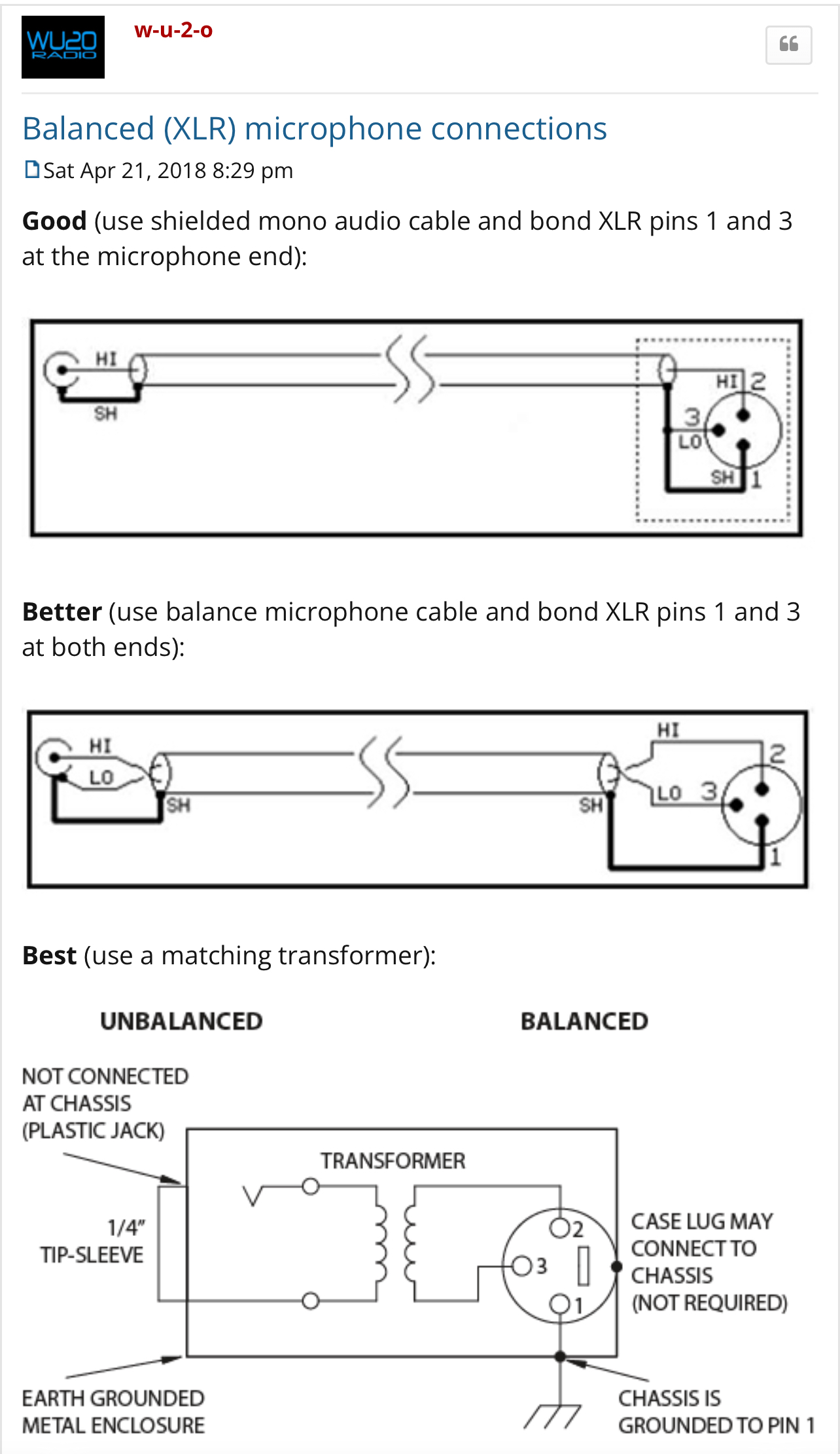

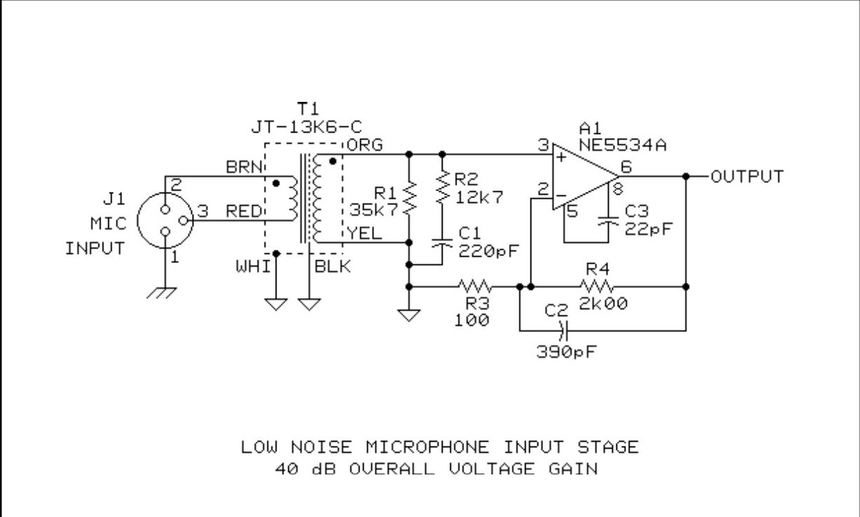

Laurence: can we publish the schematic for the balanced mic preamp?
It might be helpful if someone who is having distorted audio problems could put an oscilloscope to work and see what was going on. Perhaps on some of these boards the NE5534 is going into oscillation.
That's a reasonable request.w-u-2-o wrote:Laurence: can we publish the schematic for the balanced mic preamp?
Referring to the image below, I have U1 circled in red. What type of device is it? Hopefully it is NOT a single-stage NE5534 as is customarily done with economized differential mic inputs. And hopefully, U1 is a 3-stage instrumentation input device. I do see that it is preceded by what appears to be differential-mode input filters at FL1 and FL2 rather than a common-mode audio filter.It might be helpful if someone who is having distorted audio problems could put an oscilloscope to work and see what was going on. Perhaps on some of these boards the NE5534 is going into oscillation.
Differential mode filters affect waveform integrity; common mode type do not owing to 2L inductance cancellation. Of course we're not expecting audiophile-grade audio systems here but it does go to show the depth of thought that went into the preamp design.
Second question: is the 1/4-inch TRS jack sleeve bonded to the G2 frame or is it an isolated-sleeve jack? Switchcraft and Neutrik make both types. I'm referring to the circled jack in orange color.
- IMG_2060.jpg (2.5 MiB) Viewed 25129 times

As I posted, it is indeed a 5534. Gain is set to 10 (20dB voltage gain).

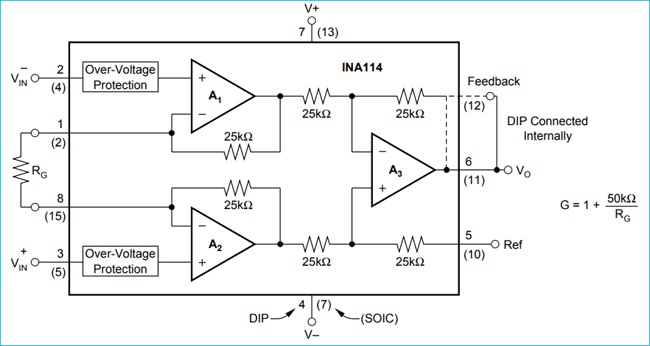

[Edited to add example of the 3-element instrumentation amplifier]
In a high RF environment, that NE5534 as a balanced differential input deserves either: (1) an audio input transformer; or (2) a pair of 5534s ahead of it, turning it into a true 3-element instrumentation input with high CMRR across a broad frequency spectrum. Frankly, it's not even debatable.
A transformer solution doesn't require an expensive Jensen or CineMag type but it does add to production cost. By contrast, the instrumentation option with a real common mode audio input choke adds very little to cost in a circuit area that's highly affected by RF ingress. If it were my G2, the cover would be off shortly after unpackaging to add a transformer.
One benefit with the right transformer is passive voltage gain with only a small increase in the input stage's noise figure. The Jensen JT13K6 shown below adds 14 dB of voltage gain ahead of the 5534. To bring overall gain down to 20 dB in the G2 only requires a change to the 5534's feedback resistor and its companion bandwidth-limiting capacitor. Sure, it's a premium part but reasonably good transformer performance can still be had at a fraction of its price.
- Inst amp.jpg (52 KiB) Viewed 25074 times
- 5534 Input.jpg (96.14 KiB) Viewed 25108 times

It doesn't have a transformer input: it has an NE5534 configured as a differential amplifier.
My understanding is that on new radios there is a common mode ferrite clamp. That transformer is physically large for the space available on the PCB. It would be eminently possible to make an "aftermarket" adapter that connected to the normal mic input or line input though.
I know that some Op Amps need external compensation caps to block RF like from getting amplified or going into oscillation.
Question: Do the new G2 radio now ship with the clamp on ferrite on the balanced mic cable in the radio?
If so since my G2 is from the first run I don’t have one in mine, I will tray adding one to see what difference it makes.

I've done some experiments today to look at the noise level as reported by Audiotest.
Firstly with no mic inputs connected:
with a 3.5mm mic input, Boost not selected: Audiotest noise level is <-60dB
with a 3.5mm mic input, Boost selected: Audiotest noise level is ~-55dB
with balanced mic input, Boost not selected: Audiotest noise level is <-60dB
with balanced mic input, Boost selected: Audiotest noise level is ~-40dB
those figures all seem reasonable. the difference in noise level with boost selected is because the balanced preamp has 20dB gain.
Then with a dynamic mic connected to the balanced input, and using an oscilloscope to monitor the signal level on J2 pin 1 on the balanced input preamplifier board: I was getting ~100mV p-p on speech peaks. Viewed using audiotest, I was getting peaks at ~-10dBc.
I don't know how typical my mic is (it is a £30 hand microphone such as you get for karaoke etc) but I think the gain needs to be lower or higher. It doesn't seem right using the mic boost preamp in the codec as well as an external preamp. Increasing the gain using a transformer seems like an interesting idea too. I have made a modification to bias the differential inputs to the NE5534 using a voltage regulator rather than a potential divider as that seems like good practice. I might be able to take some photos of that if anyone is interested.

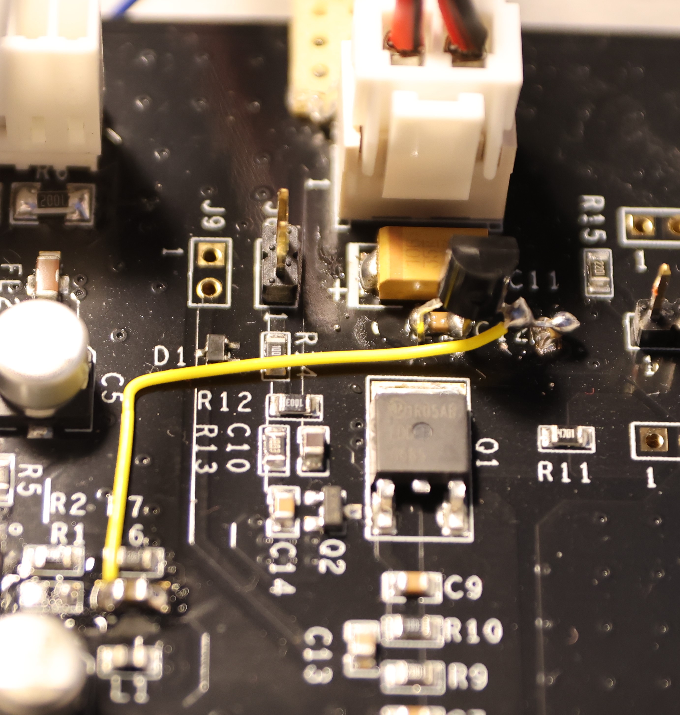

I got permission from Abhi to publish the schematic of the Mic preamp board for the G2.
I've also marked up the modification I made: this biases the op amp to +5v using a linear regulator. I'm speculating that the cause of "pickup" observed by some users was the effect of 13.8V power supply regulation. At high RF output power, taking 20-25A from the power supply, the voltage into the radio might droop on speech peaks. That would be power level and power supply dependent. With the additional regulator, and with my power supply, it is absolutely stable.
It was a simple modification to make, and I've attached a photo of my PCB. The 78L05 regulator is to the rear of the picture, mounted dead-bug style over C12. A yellow wire runs to the pad of C6, and R1 is removed.
I also found that R8 was 10K on my board; that makes the gain lower than intended. I've increased it to 39K, which then means I have adequate gain from dynamic microphones without using "mic boost" in the codec chip.

- 6Y3A0036.JPG (1005.93 KiB) Viewed 24760 times
