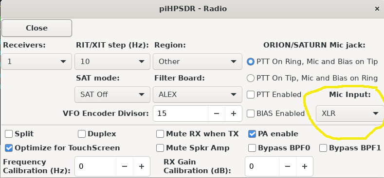

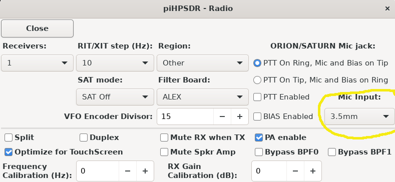

Re: New G2 with display and problems
Hi Roger,
From what I have heard the XLR input has more amplification than the mic
input. You should turn that down from 50 to something under 30.
When you change from XLR to front or rear mic input you also need to change
the setting in pihpsdr:
-Rick / N1GP
-Rick / N1GP
