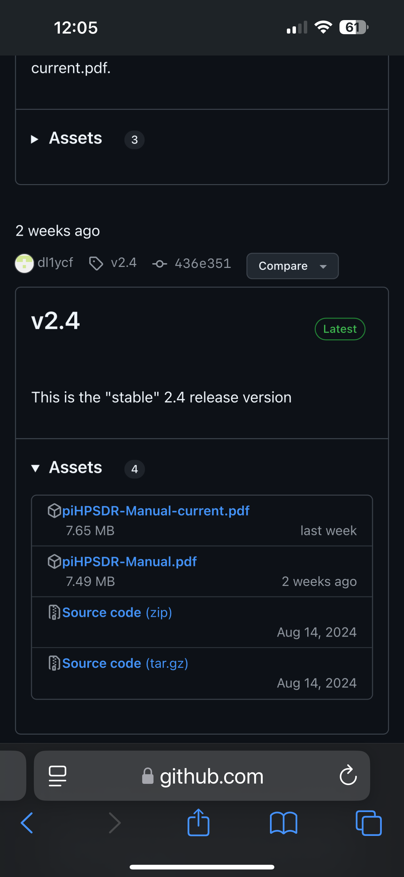

Thank you much Erik I think I found what I need by following that link. I went to the bottom of assets where it says version 2.4 zip file?

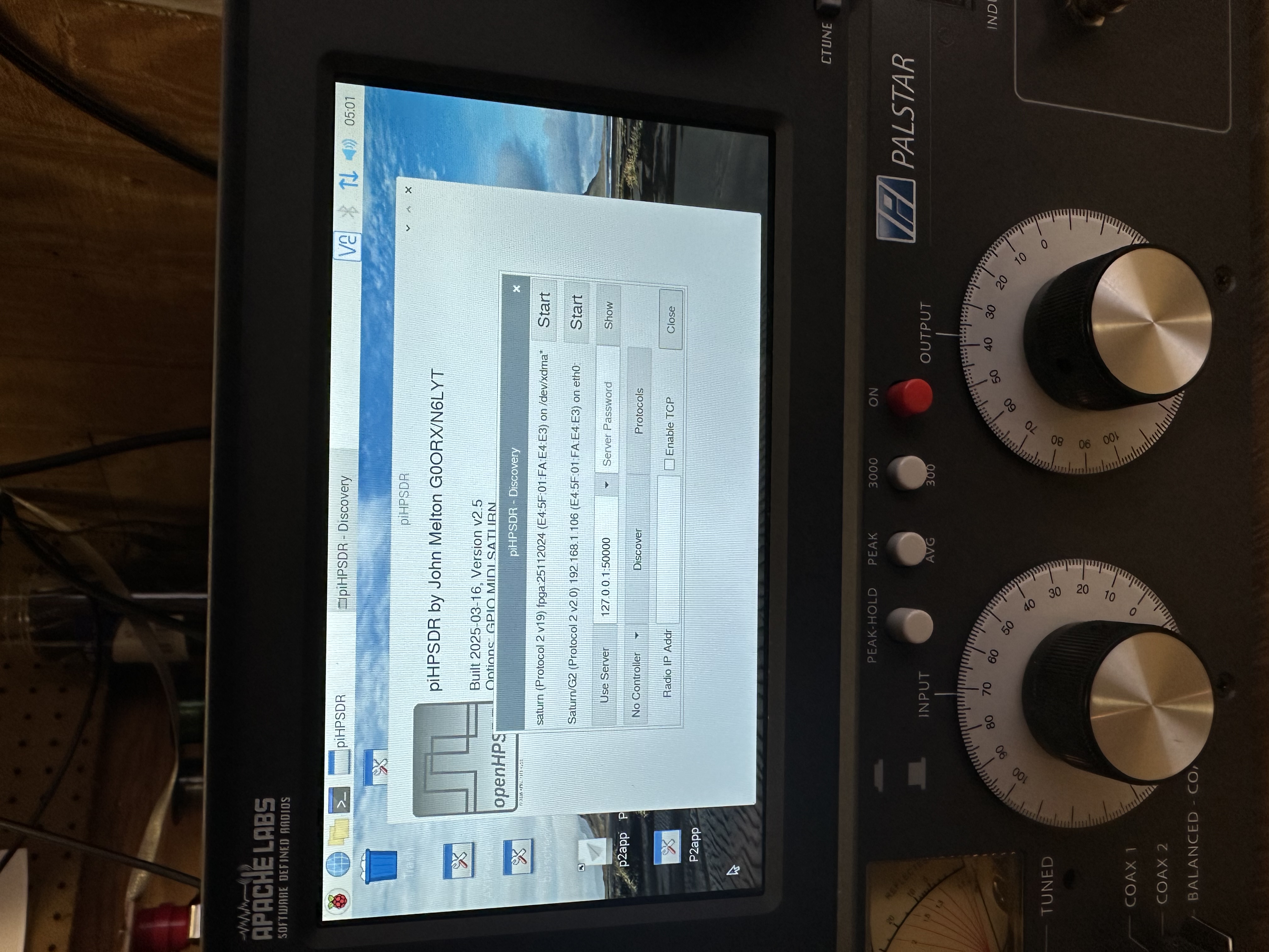

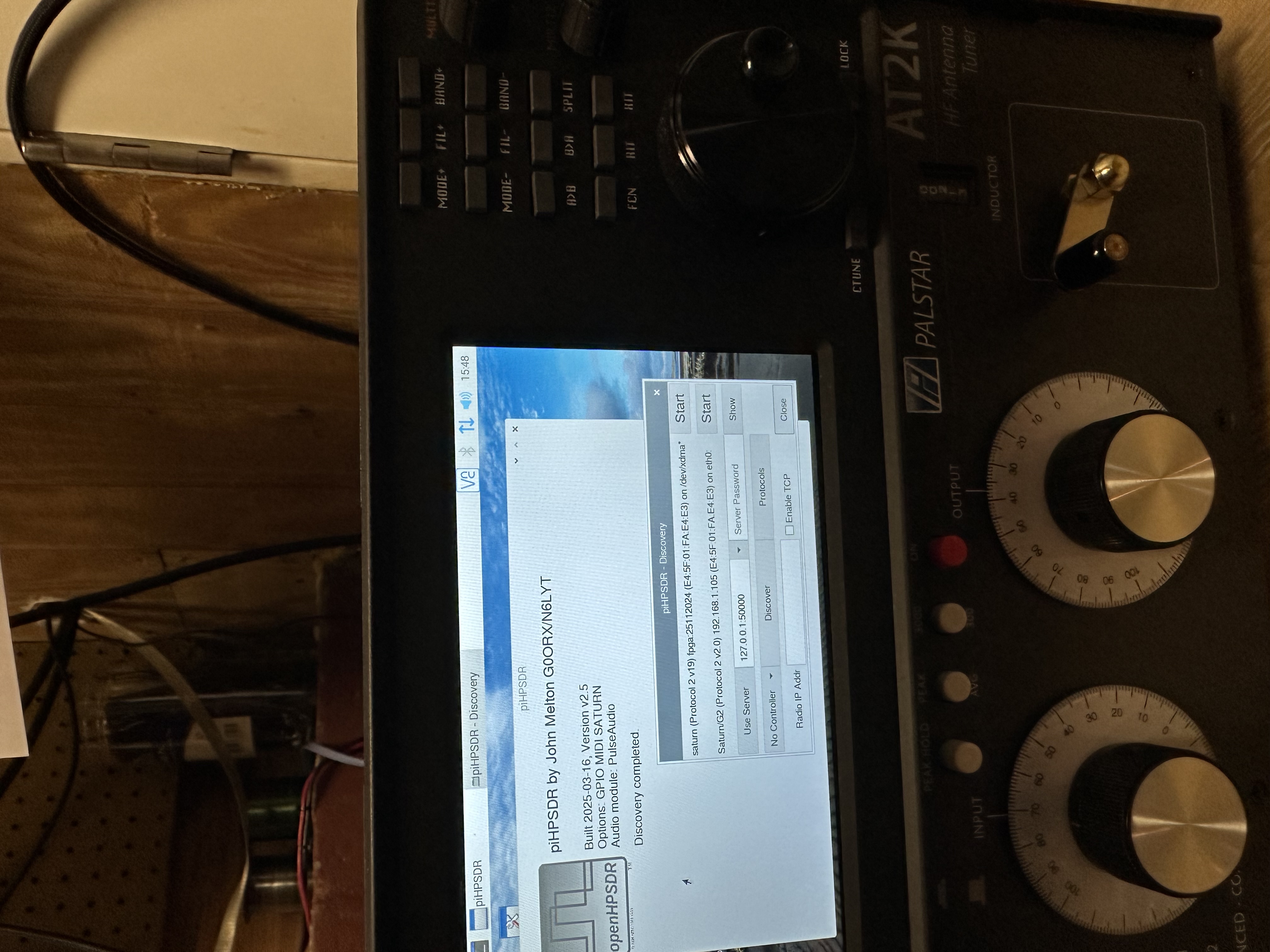

Ok so I figured out how to install the latest Pihpsdr version but when I launch it I’m getting the Discovery window? See pic please

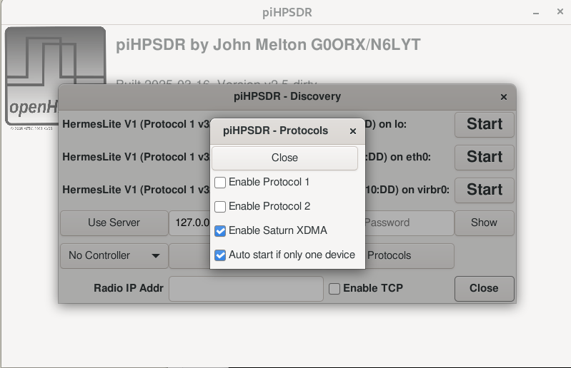

If you want to auto-start, set these options:
Either protocol2 or xdma (only one)

It has to different versions for me to select in that pic I posted ,but the version I updated to 2.5 I'm not seeing?
n1gp
Posts: 203
Re: G2 Pihpsdr Update
Post by n1gp »
The rear most image in your pic is pihpsdr and it says it's version 2.5
The front discovery selection is giving you 2 options, eth0 or xdma
It looks like you have p2app running which is giving you the eth0 option.
Did you start it? Otherwise it is most likely setup to start on boot.
You don't want it running if your going to run pihpsdr locally on the G2.
You can stop it for the current session by typing: killall -9 p2app

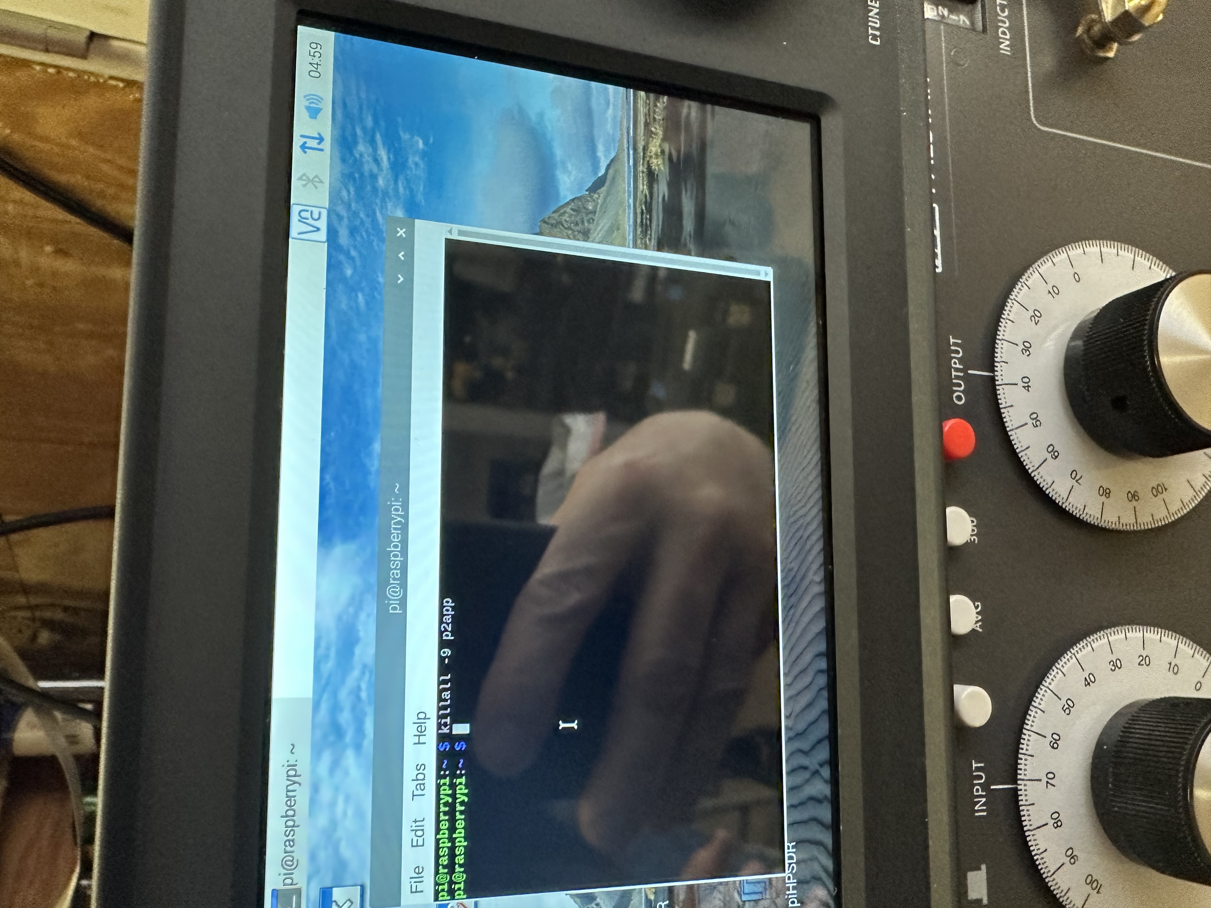

Post by Dave30Mac »
Ok I typed in the killall -9 p2app command ,but opening pihpsdr it’s still giving me the eth0 option which means the p2app is still running? I included pics.

Post by n1gp »
Something must be restarting it.
I'm assuming your starting piHPSDR by touching the piHPSDR icon
on the screen?
I wonder what that desktop icon has as commands in it.
Maybe it has a command in it to also start p2app?
To see that type: cat /home/pi/Desktop/piHPSDR*

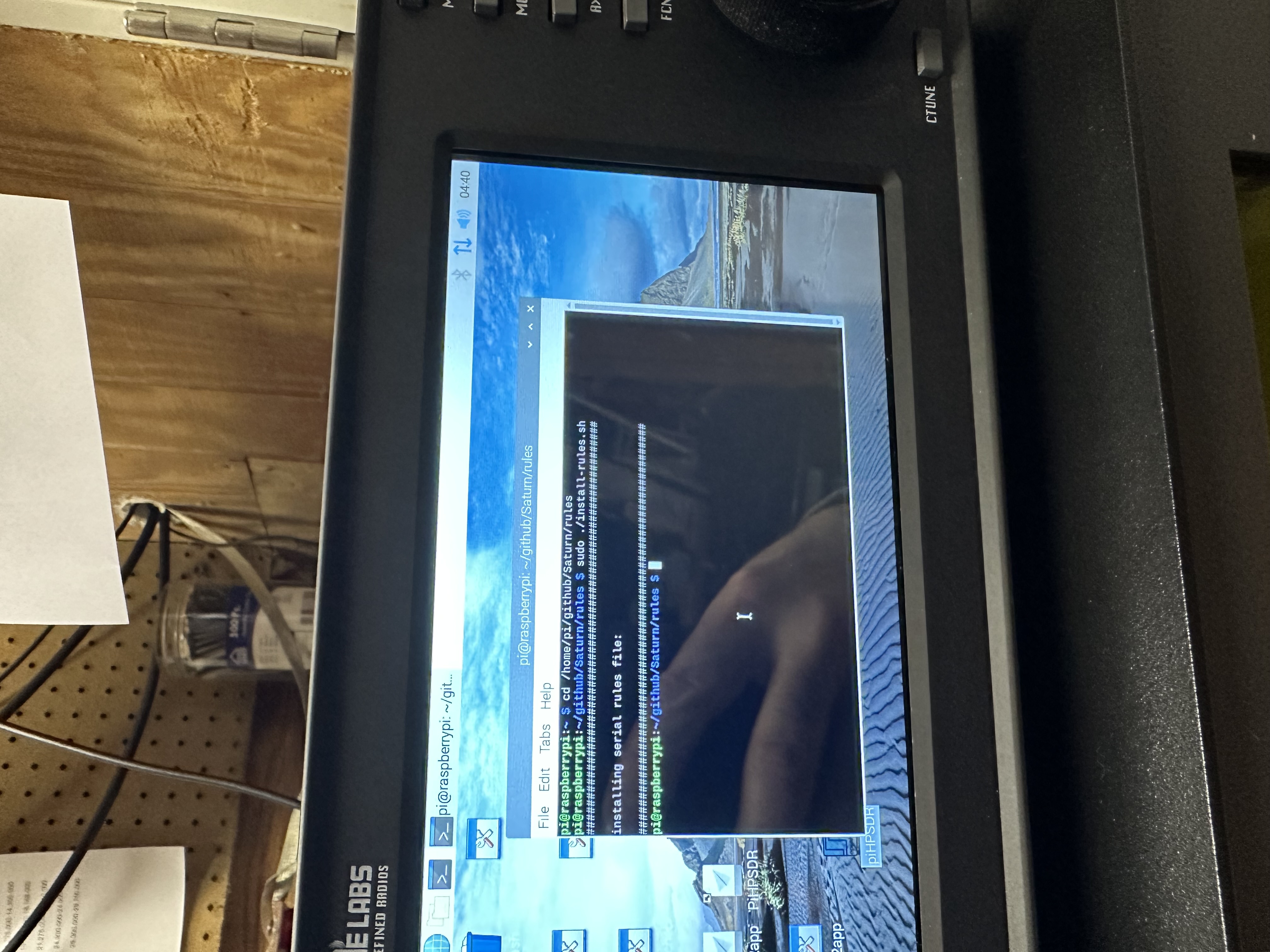

Post by Dave30Mac »
Ok I put that command in and this is what I got? I rebooted ,but the controls on the G2 display still aren’t working?
