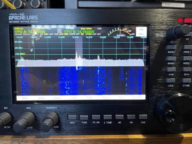

Posted: Sun May 08, 2022 9:36 am
by Vkwayne
NN3RP wrote:That was great! When you have play with it for a while, can you please post your like / dislike?
I wonder how many of us are using it and whether or not if is worth the investment
Hi Rafael
I have only managed to use it on receive ,so far ,and it seems to work very well.I like the receive on it.
I am not sure if it is just the initial novelty value ,but I will try taking it out of the shack and try connecting it to the modem inside the house ,and see if I can get it working remotely .It uses the Audio out of the radio ,so that is something I need to sort out ,as I want to listen to it away from the 7000DLE Mk11. I will report back when I have had further chances to play .
Wayne VK2VRC
