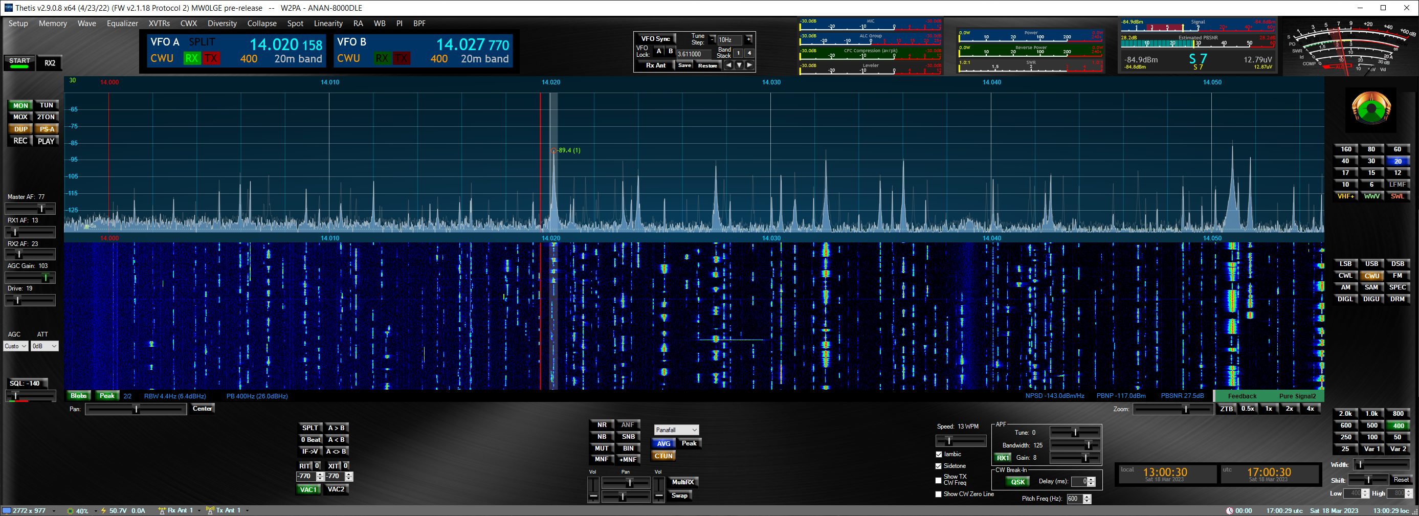

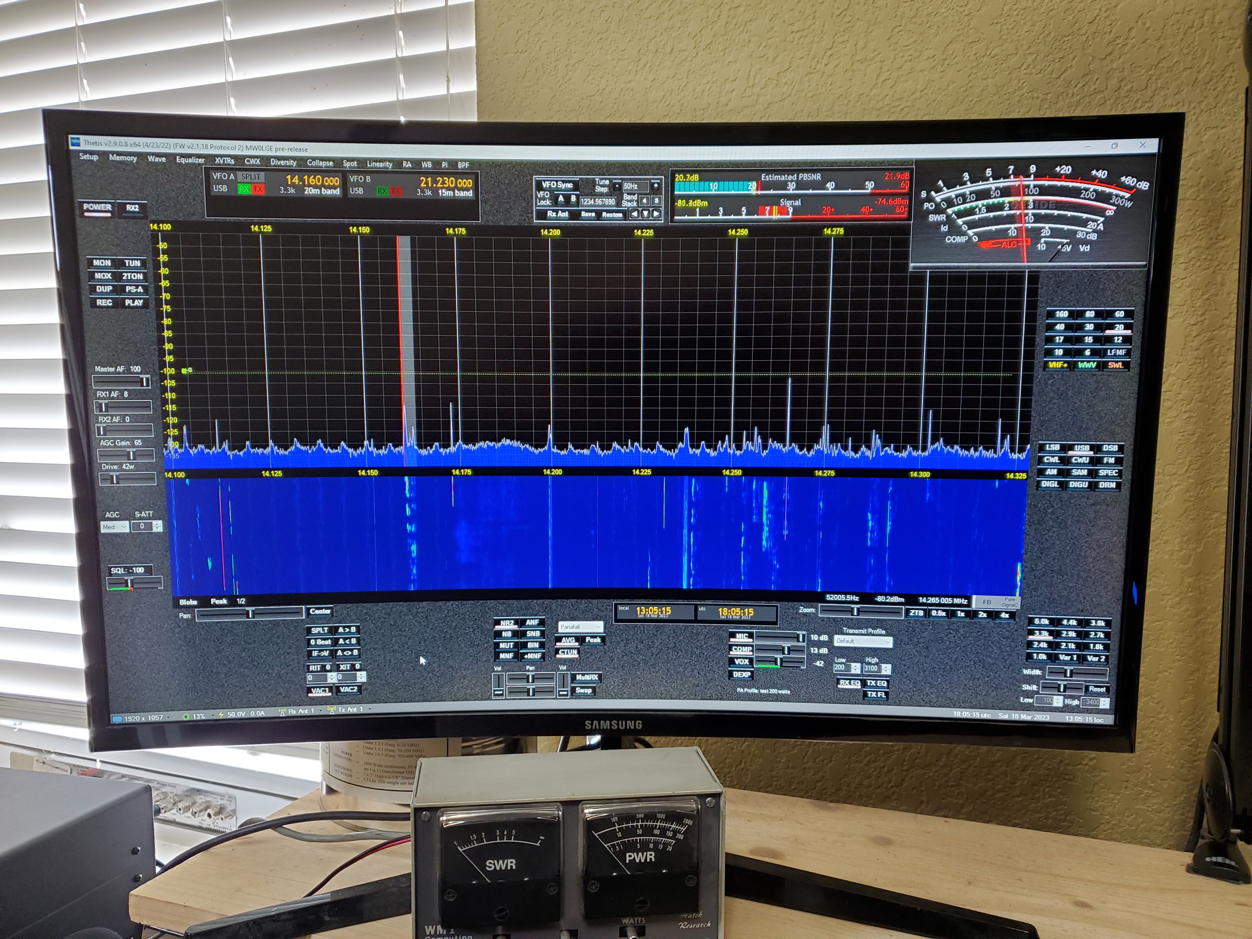

Hi everyone. Here's another example of meter containers inside the Thetis console, including edge meters, analog multimeter, VFOs, clocks, and a magic eye with an escutcheon from the floor model Silvertone model 4586 from 1936, courtesy W1JA (http://www.radiophile.com) and included in Ernst's collection. It's doubly retro in a 21st century rig!
I deliberately positioned the new meter containers to hide the old meter and VFO displays. I also use an undocked cross-needle meter outside the main Thetis window, so 8 containers in all. I haven't ventured forward into RX2 yet.
On the display the is the 20m CW band this afternoon.
Congrats Richie. And Ernst- tnx for the FB meter scales, OM.
W2PA Thetis meters.png (1.73 MiB) Viewed 22456 times
Chris, W2PA

Neat idea! Maybe at some point the new meters could be selectable for each position instead of using a container and positioning them on top of the default meters and vfo's.
Posts: 5941
Re: Thetis v2.9.0.8 - meters and then some more
W2PA wrote:Hi everyone. Here's another example of meter containers inside the Thetis console...
Nice layout, Chris! Very nice! If I can ever get this to run here I'm likely to copy you ;)

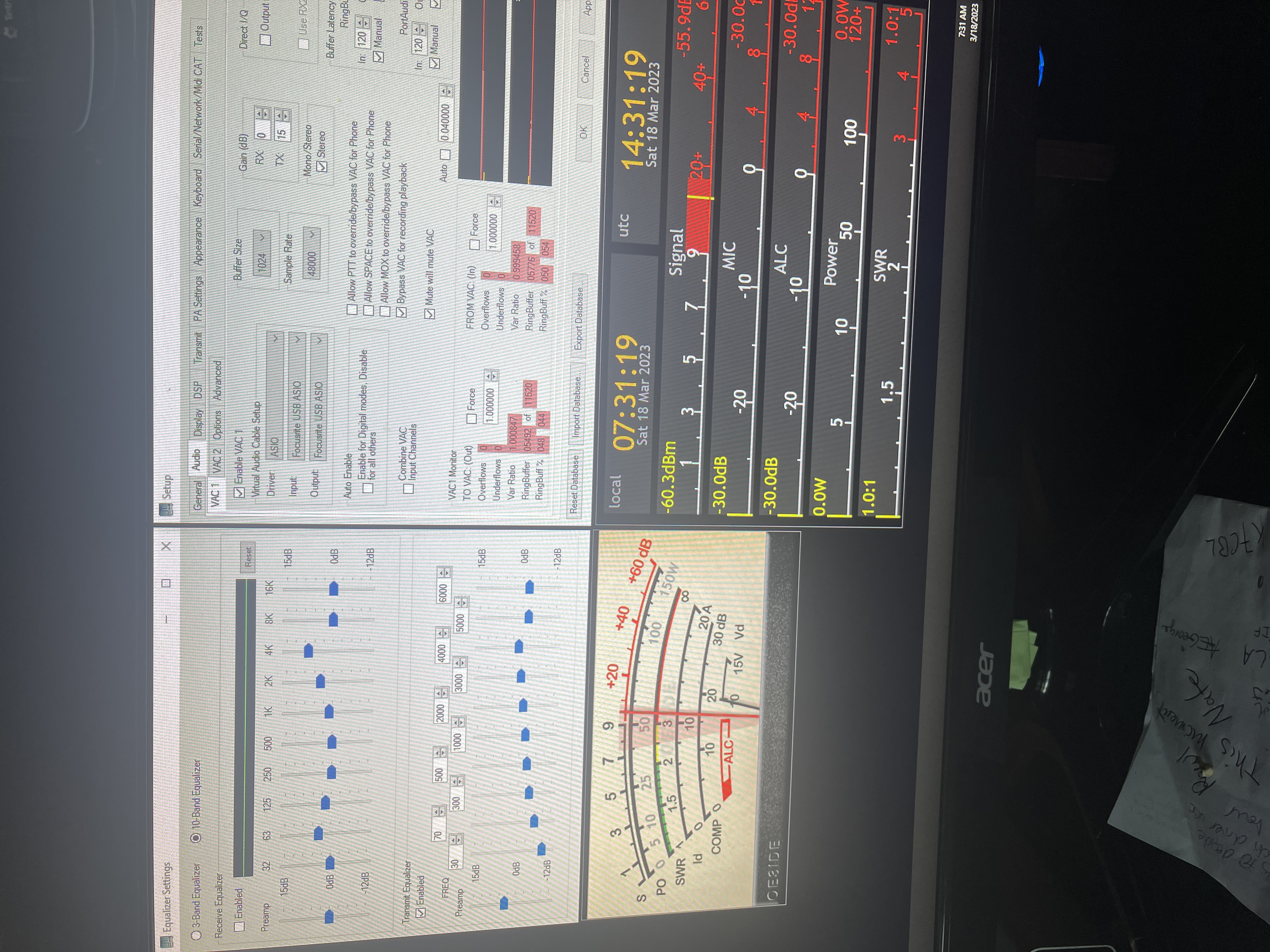

Doing a major rebuild, so have a temporary shack with only 2 24" screens. But this is what I did on one screen anyway.

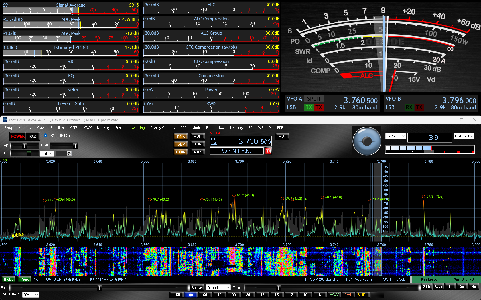

Skärmbild 2023-03-18 202411.png (890.43 KiB) Viewed 22411 times

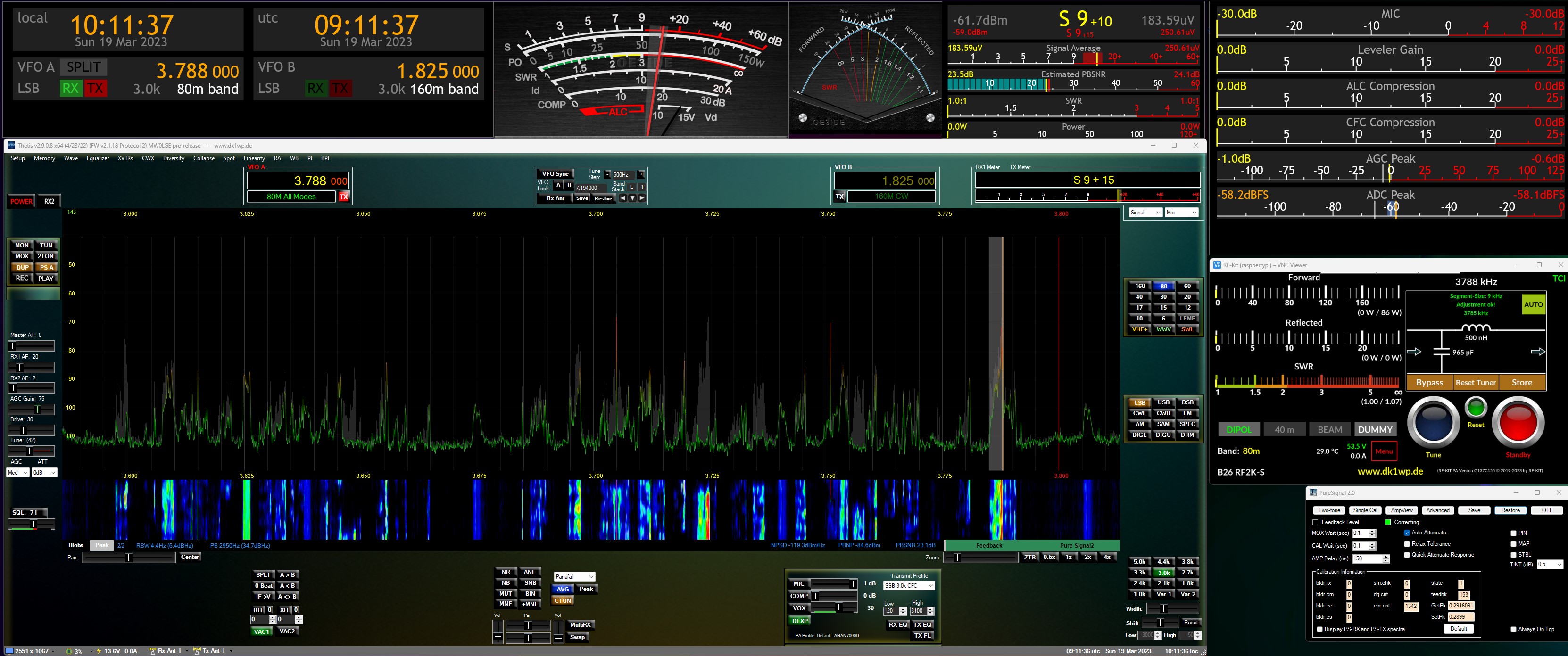

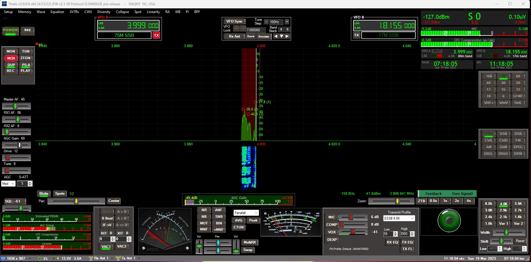

Current Thetis desktop in full screen mode...

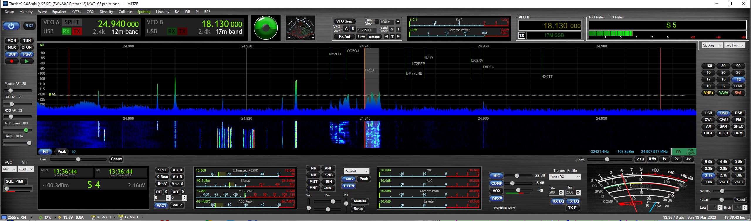

Thought I would share where I have placed things.
One request would be if a container could be made pop outable by just clicking anywhere in it, so it acts more like a shortcut button.
As you will see I have the cross needle meter very small, next to the magic eye across the top.
Obviously that is far to small to use but when I do want to use it I just click the pop out which brings up a big meter.
If I could just click anywhere on the image to pop in or out instead of the top right corner that would be neat.
Thanks again all involved
Paul

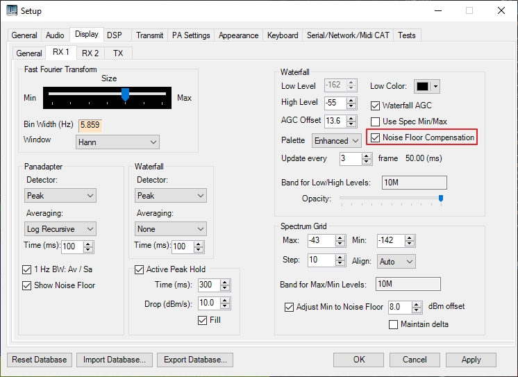

After enabling "visual aproximation of notch" in DSP/MNF I have a "color bug" on my waterfall when zooming in and out.
Watch this video:
[youtube] https://www.youtube.com/watch?v=MsZOBgDWrEQ [/youtube]
Any one else?
ea3aqr wrote:After enabling "visual aproximation of notch" in DSP/MNF I have a "color bug" on my waterfall when zooming in and out.
Watch this video:
Any one else?
Try it with activated noise floor compensation.
73 de Ernst

Thanks for the tip Ernst!
Checking "noise floor compensation" solves the issue.
Unfortunately, checkig it, my waterfall shows "more noise". I'm in down town Barcelona city and I'm suffering severe QRM from unfiltered switching power supplies in my neigborghood.

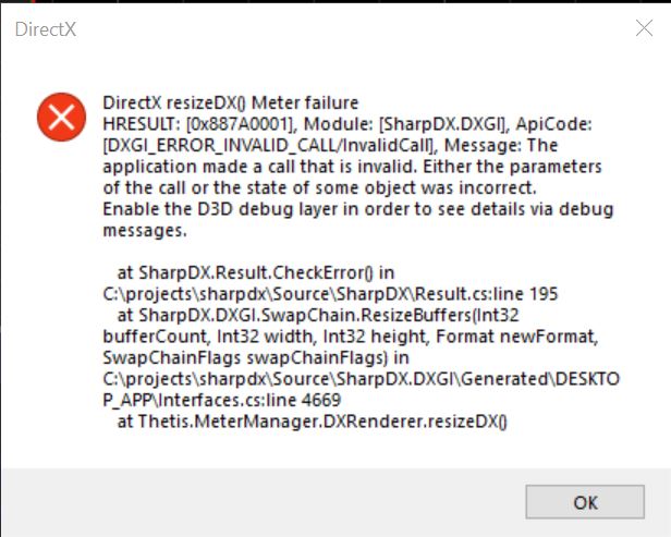

Sorry it took me so long to try this, Mike, the weekend was busy, but it was the first thing I did this morning.
I can repeatedly and reliably reproduce this error as follow: launch Thetis, create a multimeter container, then pop out the container or try to resize it:
If I dismiss this error and proceed to add meters to the container then Thetis will freeze and crash/quit.
I hope this helps to debug this problem for Tony and I.

Just a shot in the blue sky:
Did you both have installed Visual Studio?
If I look at the path on the stacktrace, it points to c:\projects\sharpdx, which is not a part from Win10/11.
Edit: I also have installed VS, but I always run these IDE's in virutal machines.
73 de Ernst

oe3ide wrote:If I look at the path on the stacktrace, it points to c:\projects\sharpdx, which is not a part from Win10/11.
While I do have VS installed, there is no such folder or path on my system. I'm guessing it's an artifact from how Mike built his version.
