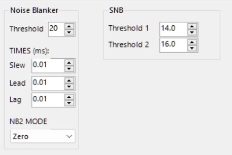

DSP (NB/SNB) setting values are currently as follows:
Noise Blanker
Threshold = 25
SNB
Threshold 1 = 8.0
Threshold 2 = 32.0
Times (ms):
Slew - 0.55
Lead - 0.18
Lag - 0.71
NB2 Mode
Linear Interpolate
I wish I could say I understand what all the Thresholds and Times were and how they were achieved but I'm not and know i have yet a lot of study and research to do. I've always heard about how special the receiver of the ANAN is and how it cuts interference and has such quiet performance. I do believe this and I would love to know what's best to have for the readings. I'm also using the ANAN 7000 for mostly SSB but also enjoy CW but mostly on the lower bands 80 - 30 Meter Bands.
Much appreciation to those who respond.

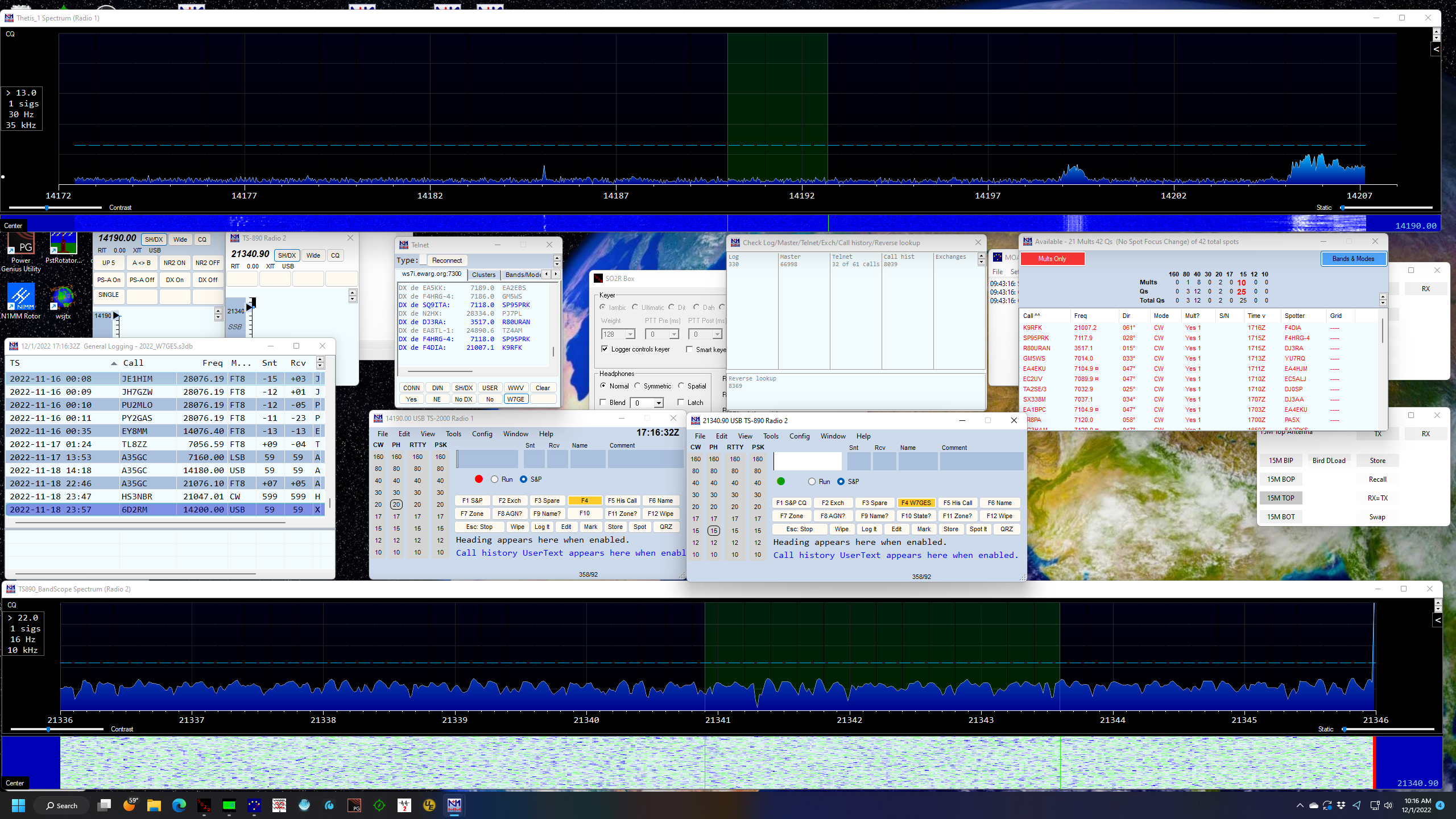

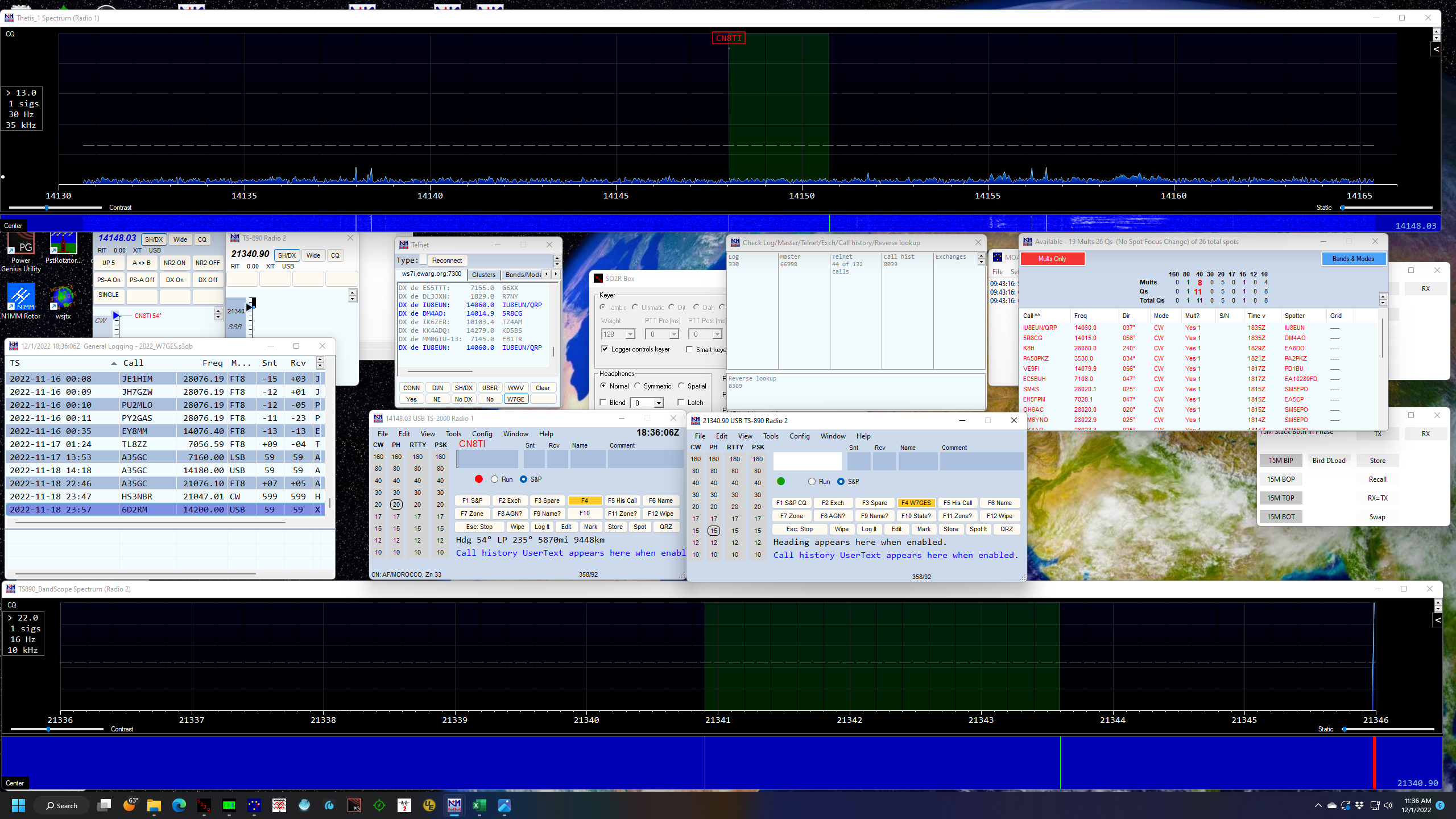

Re: Noise Blanker DSP Values?
I had terrible power line noise to my NE that the NB circuit in Thetis (or my TS-890) could make a dent with.
Sometimes it was easier to aim my beam SW to work Europe since I could hear them better off the back of the beam (and no this wasn’t during times when Long Path was open).
Using Thetis I recorded the noise floor values of 10-80 meters with my beams pointed NE and SW and recorded the values, times, etc in a spreadsheet.
Since I live in Phoenix, AZ it is rare that we get rain. After a rainy day I noticed no line noise (and recorded this in my spreadsheet).
I called the electric company and they created a problem ticket. After a few weeks (and an email for help on my contest club email reflector) a local ham mentioned he knew the electric company troubleshooter and he would give him a call.
A few days later I was contacted by the power company trouble shooter. He said my trouble ticket had been closed. Evidently a normal crew drove by, didn’t see anything obvious and closed the ticket.
He reopened the ticket and said he was doing noise abatement procedures for the Super Bowl preparations but would try to fit me in when he was finished.
A few weeks later he called and said he would be at my house in 20 minutes.
He drove by my house on the N/S street and the E/W street and did pick up line noise.
When he stopped at my house I took him to my shack and showed him my spreadsheet. I also showed him a screen grab video I had taken when the line noise was starting up again the day after a rain storm.
Then I started Thetis and showed him the waterfall / spectrum display as I rotated the antenna from SE > NE > N > NW.
He said I could walk along with him while he used his noise locating equipment.
3 Powerpoles later he said the noise was so bad it pegged his meter. He set up the bucket truck, extended it near the transformer and told me my noise would be gone when we went back to my ham shack. He said a wire was routed incorrectly and was arcing.
He was correct. This was on Dec 1, 2022 and although I get a little interference from neighbor’s pool motor’s, etc once in a while the horrible line noise hasn’t returned.
Below are screen shots from when he arrived and when he left. The top display is both beam antennas after the problem was fixed, the bottom display is from the antenna pointed at the power line. Unfortunately 15 meters didn’t have any activity when I took this screen shot but trust me my noise level is now low…
The screen shots are from N1MM as I could show the lineman both radios at once. I run Thetis on a stand alone computer so the noise floor readings are not visible on this computer but it’s easy enough to see there’s a giant difference.
Sorry for the long email, I just wanted to point out that it is worthwhile to document your noise and call your power company.
I hope you are able to get resolution for your noise. I don’t think there is going to be a noise blanker algorithm that will be able to fix it.
George / W7GES
