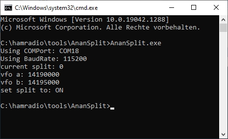

NC3Z wrote:I think Scott made a wish list item to have Macros on the GUI so you can do what ever you want. I use a StreamDeck and I have a Split button that does all that via CAT commands, set Split, turn on MultiRX, set 2nd freq up 5KHz, etc. Works pretty slick.
I have written a small tool (windows) which toggles split. On "split on" it sets vfob 5khz above vfoa and activates MultiRX,TX FL and split.
On "split off" it disables MultiRX, TX FL and split.
Its a simple exe with an ini-file (for comport and baudrate). Each call of the exe toggles split.
If someone needs this small tool, please let me know ;-)
