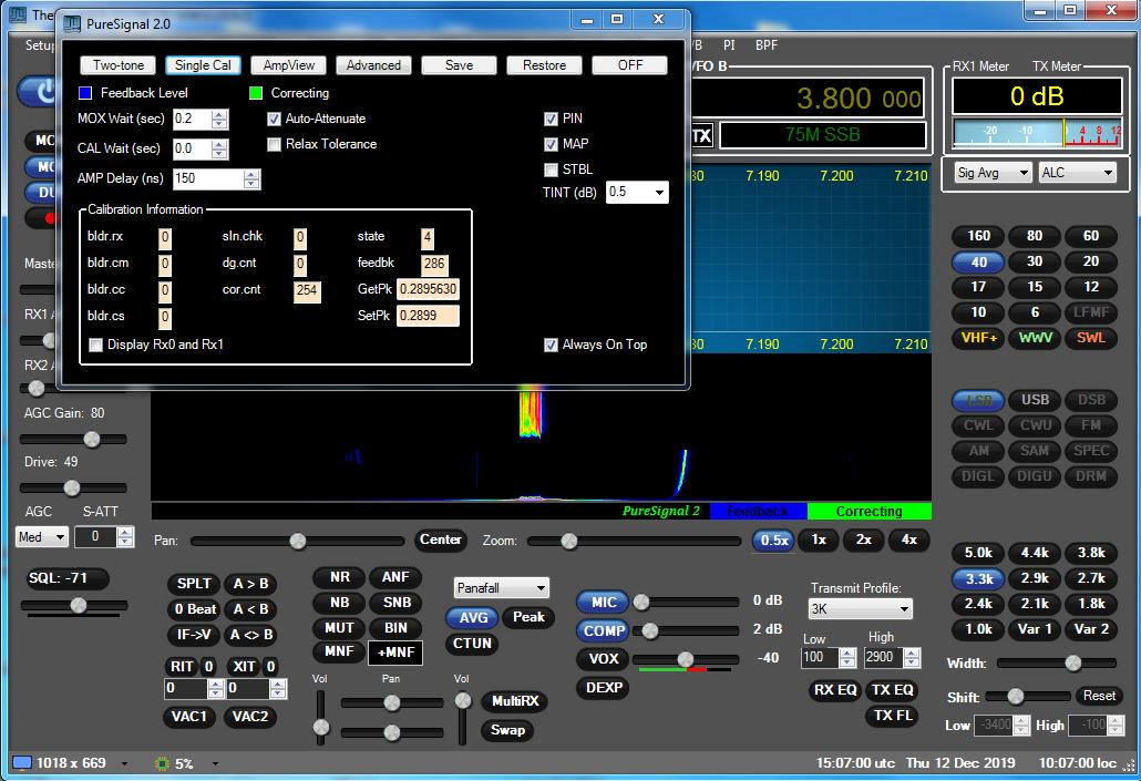

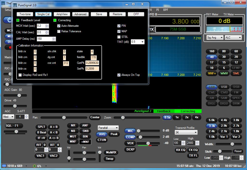

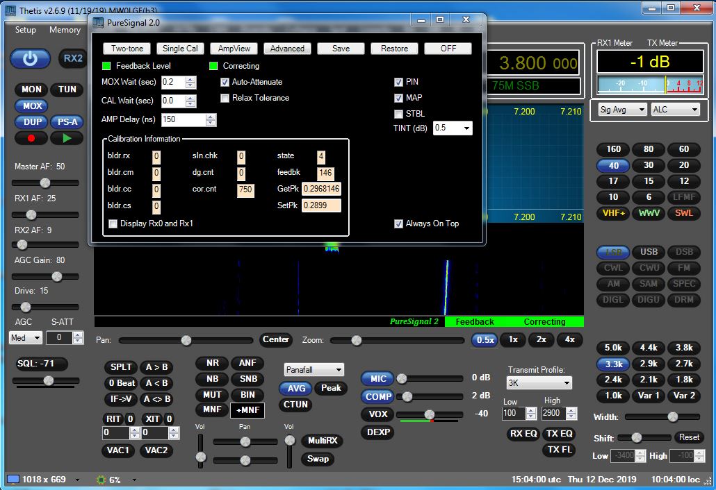

Here is my problem with the Auto-Attenuate (PS-A) since version Thetis_2.6.9_B1, 2.6.9_B2, 2.6.9_B3. Note that with the previous versions everything worked correctly. Test with old database or new and same problem
Drive 15 or low value ok (Fig. 1), but when I increase the drive (Fig .2) the Auto-Attenuate does not work. I have to put the S-ATT manually (fig.3). The Autto-Attenuate only works very rarely, so it can not be used.
Anan 100D
Firmware Angelia_Protocol_2_v11.7_7-15-18
fig 1
fig 1
fig 2
fig 2
fig 3
fig 3

VA2EY wrote:Here is my problem with the Auto-Attenuate (PS-A) since version Thetis_2.6.9_B1, 2.6.9_B2, 2.6.9_B3. Note that with the previous versions everything worked correctly. Test with old database or new and same problem
Anan 100D
Have you tried going back to a Thetis version before 2.6.9_b1 recently? In other words, now that it does not work for you, if you go back now does it work for you again? It may not be a Thetis problem. This behavior is more indicative of a firmware problem or a problem with excess current through the F3 PTC device.

[/quote]Have you tried going back to a Thetis version before 2.6.9_b1 recently? In other words, now that it does not work for you, if you go back now does it work for you again? It may not be a Thetis problem. This behavior is more indicative of a firmware problem or a problem with excess current through the F3 PTC device.[/quote]
I just checked (many more times) Thetis_2.6.8 any alpha version
Thetis_0700_171119_269_a7
Thetis_2240_181119_269_a8
all these version works properly
problem only with
Thetis_2320_211119_269_b1
Thetis_1622_091219_269_b2
Thetis_1905_111219_269_b3
Re: 2.6.9
Posted: Thu Dec 12, 2019 11:30 pm
VA2EY wrote: I just checked (many more times) Thetis_2.6.8 any alpha version
problem only with
Issue found. New version out sometime over weekend.
Thanks for the version info, helped me track it.

ramdor wrote:UPDATE
Please try : https://www.dropbox.com/s/sjzmbx14w0oyy ... 1.zip?dl=0
This is a pre b4 release, as some of the items are still work in progress. Hopefully will fix the issue Michel is having with PS attenuation.
73 for now, Richie.
(11/19/19) b3_1
-add: vsync option for directx screen updates, initial pass (wip still work to do)
-change: directX provided with fps setting during initialisation, was previously always maxed to 144
-fix: issue with PS NeedToRecalibrate check, did not consider existing TX attenuation if the sampled signal was too low. This was an error introduced in recent refactor
-add: peak hold delay on peak blobs, initial pass (wip still work to do)
PS attenuation works well now and I like the peak hold delay on peak blobs
Thanks Richie
