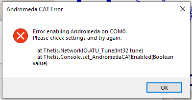

in that case it is also happening when shutting it down, as part of Console_Closing, where AndromedaCATEnabled is set to false.
Can you try this build Frank? and screen shot the andromeda errors?
https://www.dropbox.com/s/jwjkoke7ytv2u ... 3.zip?dl=0
Re: 2.7.0
Posted: Mon Mar 16, 2020 10:43 am
by W2SDR
Hey Richie,
Thanks for the test download. Installed it and the program will not start but here is the error message I get now
Frank

Frank
I think that error message with the stack trace gives us a clue as to what's happening. I've contacted Doug for advice on what could be happening.
If you click OK can you get past it, or does THETIS exit?

Some info regarding this error :
After some extensive testing and investigation, I can only assume the people that are seeing the Andromeda error are doing so because they are using the incorrect version of ChannelMaster.dll along side their Thetis exe.
ChannelMaster.dll includes a new call ATU_Tune. If that is not found in the dll then an error will occur during the andromeda enable/disable code and result in message you are seeing. It is impossible to see it any other way, especially after looking at the database.xml file provided.
I have checked the a2 zip file, and all correct files are there. If you are using these test versions, please make sure you follow the info in post number 1, especially the bold text.
There is nothing more I/we can do with this error as all looks ok in the code, and the only way I can get it to present itself is to use the wrong version of the dll.
