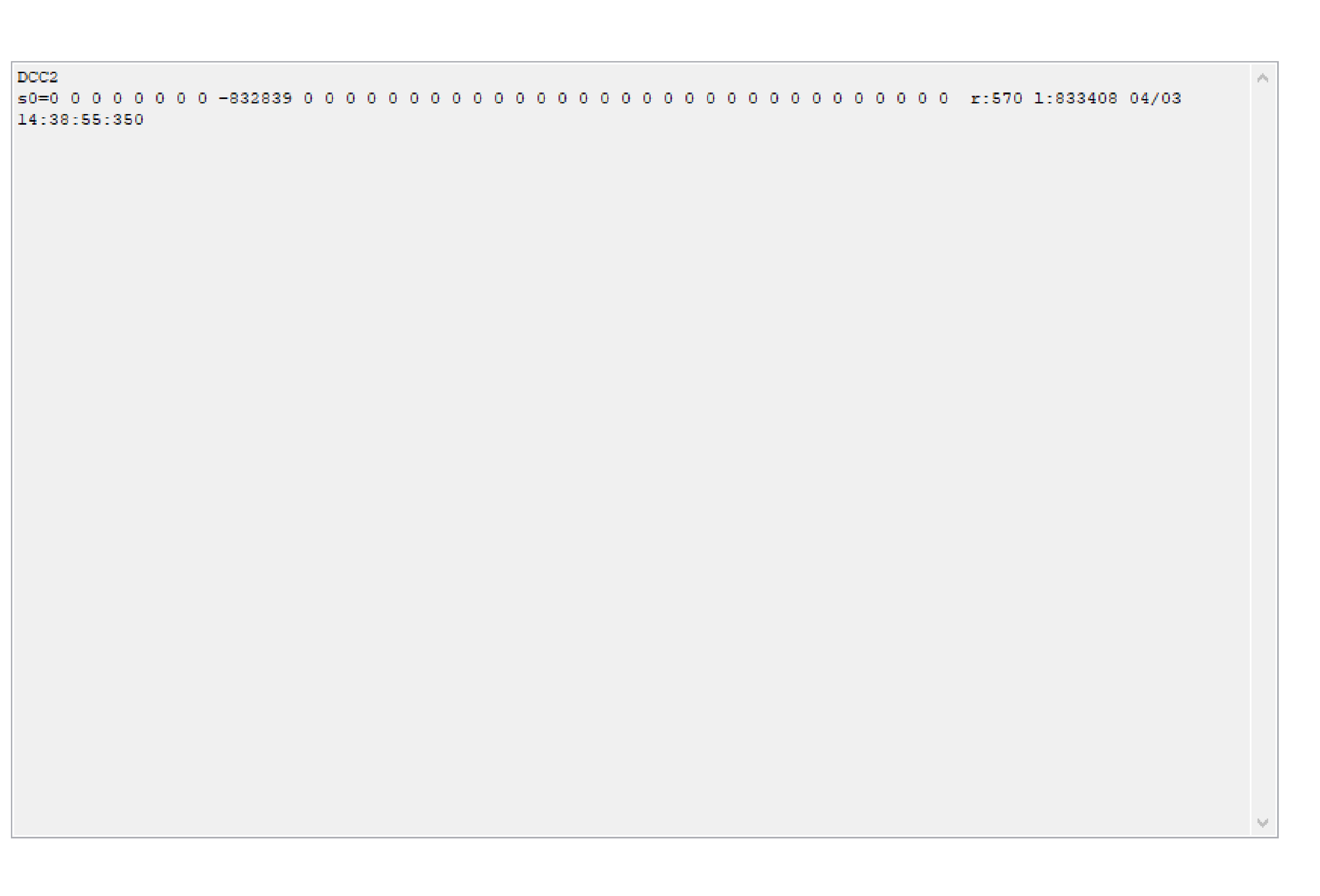

by W9BHI
This error popped up and halted the program.
Re: 2.7.0
Posted: Fri Apr 03, 2020 8:38 pm
If you get a big enough interruption in the network it will cause Thetis to go into a "stopped" state. Pushing the "power" button should make it go again.
If it won't run again without power cycling the hardware unit then it's a firmware crash, and nothing to do with Thetis.
Re: 2.7.0
Posted: Fri Apr 03, 2020 10:13 pm
by W4WMT
w-u-2-o wrote:If you get a big enough interruption in the network it will cause Thetis to go into a "stopped" state. Pushing the "power" button should make it go again.
The Network Watchdog won't kick it back into gear, Scott?
