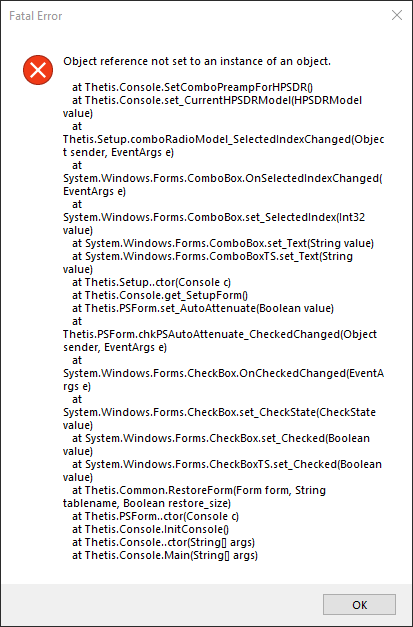

Got this error on start-this morning when starting 2.7.0 a1 !
error.PNG[/attachment]
oxt
oxt
- error.PNG (25.98 KiB) Viewed 55828 times
Re: 2.7.0
Gary, can you attach your database.xml please.wa1oxt wrote:Got this error on start-this morning when starting 2.7.0 a1 !

thanks, issue resolvedwa1oxt wrote:Richie ,here ya go.

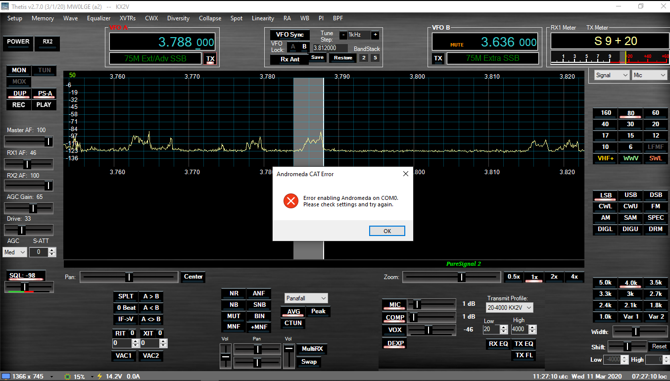

Re: 2.7.0
Hello all.
I am getting this error message twice when opening & once when closing Thetis 2.7.
Any help would be greatly appreciated.
- Untitled.png (253.07 KiB) Viewed 54943 times

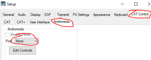

Re: 2.7.0
Try changing setting to NONE?KX2V wrote:Hello all.
