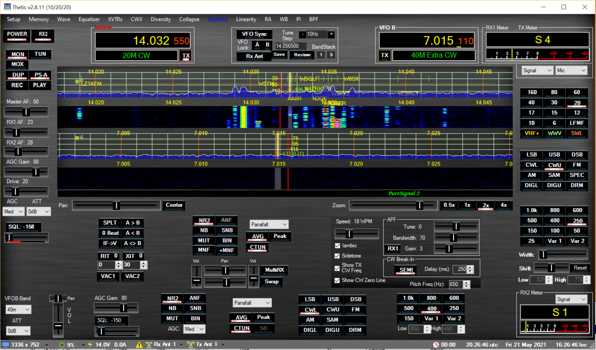

I'm attempting to configure RX2 for the first time on my black 7000 DLE MK II. Seems easy enough. But, I'm getting no signal on RX2. I have a multi band antenna and I'm trying to place RX1 on 20 meters and RX2 on 40 meters. However, there is clearly no signal being received as the waterfall is dead on RX2. I've been surfing around the manual and this site doing keyword searches hoping to bump into the solution. Can RX1 and RX2 share a single antenna simultaneously? Or, must there be a second antenna connected to the ANAN ? I have a total of three antennas and they are connected to Ports 1, 2, 3 of an Elecraft KAT500. Thus, I have one cable from the ANAN to the tuner. I use the KAT500 app for antenna switching currently. Perhaps there is a better way - not sure. I hope that I'm a mouse click or two away from a solution.

You can go to settings, general, ADC and assign everything to ADC0 in order to use the second receiver from the main antenna.

That is the much preferred method if you want to take advantage of the 7000 and Thetis. But as Mike noted you can move it al over to 1 ADC, but you'd throw away 1/2 the radio and have limitations.W8JJ wrote:Therefore, using the RX2 port does not seem practical unless I was using a receive only antenna, correct?

With all due respect, I think your statement is a little strong, Gary. Many of us have but a single antenna and thereby no good way to use the dedicated RX2 input (labeled ADC2 or ADC1 on some hardware).
Where the dedicated RX2 input really shines is when you have a dedicated receiving antenna, like a beverage array, or some other sort of antenna that you have set up for beamforming (aka diversity). But not very many people have this.
My own radio is set up to service all receivers off off ADC0. To do this go to Setup > General > ADC.
Don't forget that you also need to be mindful of the preselector settings. If you want to receive multiple bands at the same time you need to turn that off. Go to Setup > General > Ant/Filters > BPF1/LPF and check the Bypass/55 MHz BPF and BPS ByPass on TX boxes.
Also, be aware that your antenna may not provide the best response on an alternate band if you are using an antenna tuner and have, for example, tuned up on 20M for transmit but are monitoring 40M on RX2.
