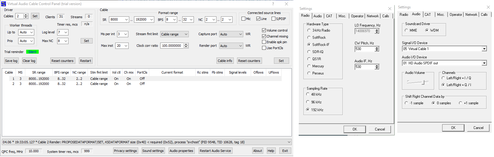

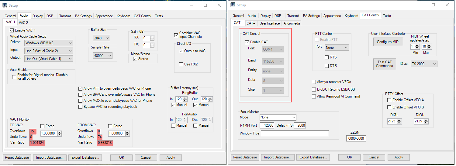

I am having some problems making Thetis 2.8.11 and CW-Skimmer 2.1 working together.
I followed the guidelines by Rafael, NN3RP, that I found in a previous tread https://apache-labs.com/community/viewt ... 73&p=11252:
CW-Skimmer can read Thetis frequency (via Omnirig-TS2000) but signals in its waterfall aren't in sync with the ones in Thetis. Maybe I am missing something but I have the same issue running Thetis 2.6.9 and CW-Skimmer.
The settings I am using are in the pictures below.
I am wondering if someone would like to share again the settings for Thetis 2.8.1 and CW-Skimmer.
Also, as I am not using cw-skimmer from a long time now, I would like to understand the mathematic relation between the samplerate in the VAC settings panel and the samplerate in the CW_Skimmer "Radio" panel. Is it right having 48000 KHz in Thetis and 192 KHz in CW-Skimmer (here a link to other docs is fine as well).
My rig is a Anan 7000-DLE (blue), CW Pitch is 530 Hz and the OS is W10-x64.
Any help will be appreciated.
73' Enzo, iw7dmh

Hi Enzo,
Ctune must be disabled.
Sample rate must be the same in thetis vac and cwskimmer.

Hello Mike,
thank you very much for your hints.
It works very well now. :)

another dumb question: is it correct I can't have a permant storage of the Audio-VAC1 settings?
Each time I restart Thetis I have to check the following three flags:
- Stereo
- Combine VAC Input Channels
- Direct I/Q - Combine VAC Input Channels
Also, what is the general rule in running Thetis? Do i need to set the flag "Run as Administrator"?
Thank you and 73'
Re: Thetis 2.8.11 - CWSkimmer
Posted: Tue Jun 08, 2021 6:18 pm
VAC settings are stored as part of your transmit profile. Just save a profile with the settings you want. You may wish to turn off the automatic profile save features in order to prevent unintended changes.
You do not need to run as admin.
