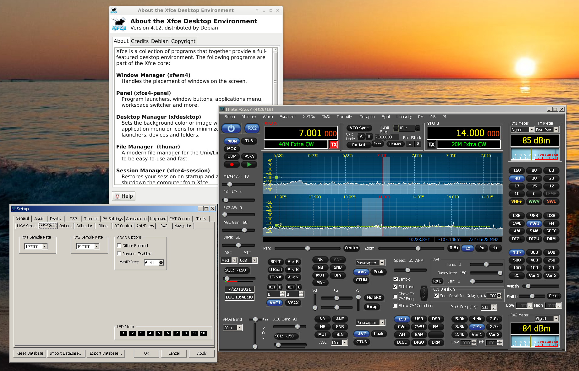

I've been able to get Thetis v2.6.7 to work under Debian Buster (release 10), wine-6.0
Clicking on buttons sometimes requires double hitting or just holding a bit longer.
I wasn't able to install any higher version of Thetis due to dependencies for graphics and such.
BTW I have not tested this very thoroughly, only receive.
Coming back to testing it I find I can only start it up from the Desktop Icon I created.
From the command line it fails to start. This is my Thetis Desktop Icon in case you may
want it to try:
$ cat ~/Desktop/Thetis.desktop
[Desktop Entry]
Name=Thetis
Exec=env WINEPREFIX="/home/mh/.wine" wine C:\\\\Program\\ Files\\\\OpenHPSDR\\\\Thetis\\\\Thetis.exe
Type=Application
StartupNotify=true
Comment=Run Thetis
Path=/home/mh/.wine/dosdevices/c:/Program Files/OpenHPSDR/Thetis/
Icon=30DC_Thetis.0
StartupWMClass=thetis.exe
-Rick / N1GP
