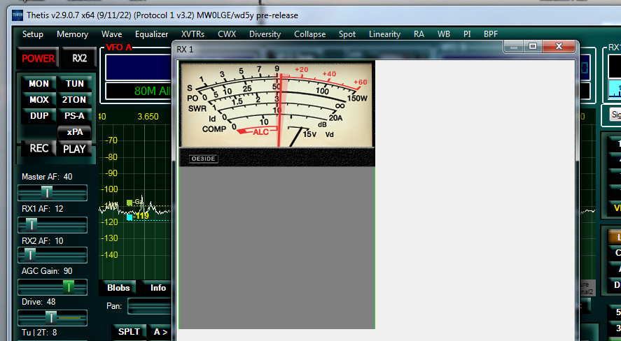

Hi
The size of the multimeter does not change.
- 2907_S.jpg (125.31 KiB) Viewed 9583 times
Re: Thetis Source Code
Multimeters (including the analog-style meters) are still work in progress...
Before Richie's summer-break I was in close contact with him. I created the png's and he created the code behind them. Nothing in this area has the status "ready" yet.
As far as I can remember, Richie built a general interface (kind of API) for all types of gauges (bar graphs, needle meters or something completely different). But this is also in very early alpha
Thanks to Joe and Siggi for the publications and for the beautiful analog meter to Ernst!
When looking at the analog meter, it occurred to me that the PO value of 150 is too low for the new ANAN 8000 with the 500 watt power amplifier.
But maybe this is already taken into account.
Marcus
As mentioned, early alpha stage. Some meter-pngs needing alignment procedure.. which is not implemented in the gui atm.DK1WP wrote:Thanks to Joe and Siggi for the publications and for the beautiful analog meter to Ernst!
https://www.oe3ide.com
