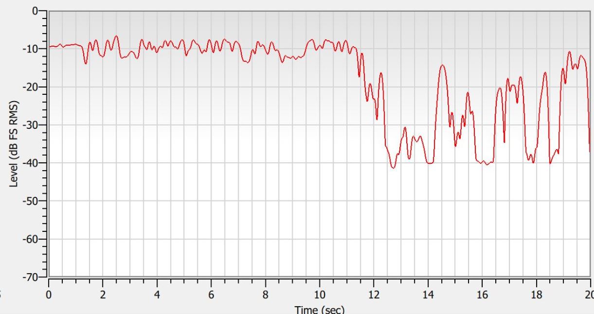

For example, I enabled the FM receive limiter (in Setup > DSP > FM) for the reception of a strong, full quieting, 10M FM signal. For the first 10 seconds the limiter gain was set to maximum, 30dB. You can see that the audio dynamic range is reduce to only 6 or 8dB. This is commensurate with many of the highly compressed SSB signals we are used to hearing. For the remaining 10 seconds, the limiter remained activated, but the limiter gain was reduced to minimum, 0dB. You can see that the audio dynamic range is almost 30dB under those conditions.

Wow, what an improvement! I just made a contact on 29.6 and the station was perfectly clear with a limiter gain setting of 2 notches (4dB). Playing around with the limiter gain it was perfect through quite a range and the minimal setting suggested by Scott was fine. This will be great fun to play around with the way 10 meters is behaving at this time. Thank you Warren!

Just to clarify: I wasn't recommending any particular level, only demonstrating the max. and min.
But to make a recommendation, I find it works best for me somewhere between about 10-15dB. This morning I made a couple of EU contacts on 10M FM and with the new limiter they were very clear and easy to copy.
