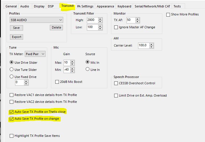

Phil, you are definitely on to something with the auto save tick boxes on the transmit form! I just installed 2.10.1 so I could try Joe's version. When I first ran Thetis 2.10.1 it imported my 2.9.0.8 database as I forgot to press shift. Anyway, just as an experiment, I let it run with the imported database but first went to the transmit form and unticked those two boxes.
I am happy to say that so far, 2.10.1 is now working correctly! it is saving all my frequency, mode and band data on exit and restart. Lets see how it goes.

I can confirm, that saving Transmit Profile manually "does not" corrupt the database.
73, Phil - VK1HX

I've selected the Auto Save TX Profile on change. seems ok
73, Phil - VK1HX

Thanks for that Phil, so it is just the save on exit one we need to leave unchecked. I'll try that now.
This discovery also explains why not everyone is seeing the original problem. Not everyone will have those autosave options ticked in the first place.
Terry. GW4NNO

Yep still works with save on change ticked, so the only one we need to leave unticked is "save transmit profile on Thetis close". Maybe this info should go in a new thread if it proves to work over the next few days. Might save other folks a lot of frustration!

Great work on identifying the relevant setting, gents! It seems definitely related to saving TX profiles.
There is an existing bug report already here: https://github.com/ramdor/Thetis/issues/144
I've added that info to the bug report.
