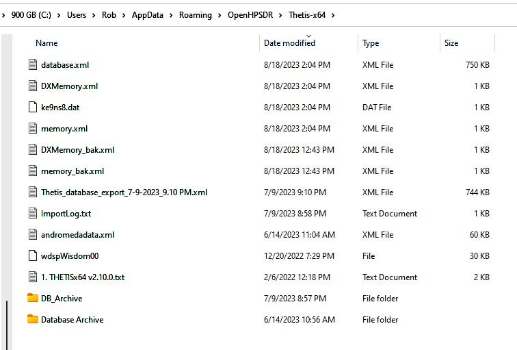

Re: Thetis starting with standard frequency
Hi Hans,
In the screenshot I can see that when I shutdown Thetis yesterday at 2:04 pm there were four files that were modified. I wonder if people who are experiencing this issue are seeing the same four files modified when they shut down. Could be the shutdown of Thetis is completed before everything gets updated.
- w1aex thetis shutdown.jpg (46.3 KiB) Viewed 24666 times
@Rob
I checked the time and all 4 files as shown in your screenshot have the right time on exit, plus error log...
@Hans
Runnung software as admin is not a good choice and should be avoid if possible.
For testing it is ok...
I also tried to run Thetis as admin but no change.
I' still using an older version which is running fine.
