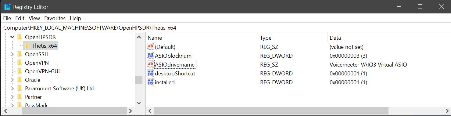

I finally got around to playing with this outstanding new feature by Bryan, W4WMT. Thank you, Bryan! :)
I've found it to work perfectly with Voicemeeter Potato. Working conditions are an ANAN-8000, FW 2.1.18, Windows 10 Pro.
ASIOdrivername is set to "Voicemeeter VAIO3 Virtual ASIO" (without the quotes). That was the Voicemeeter virtual channel I had been using with VAC (until now! :) ).
For giggles I'm playing with ASIOblocknum now. The default value of 5 works fine. A value of 2 doesn't work so well. Increasing to 3 seems to be pretty good so far, but I need more time on the system to know for sure.
I'm attaching Bryan's cmASIO preliminary instructions here for convenience. They include a link to his "hostsample.exe" utility for identifying ASIO drivers installed on the system.

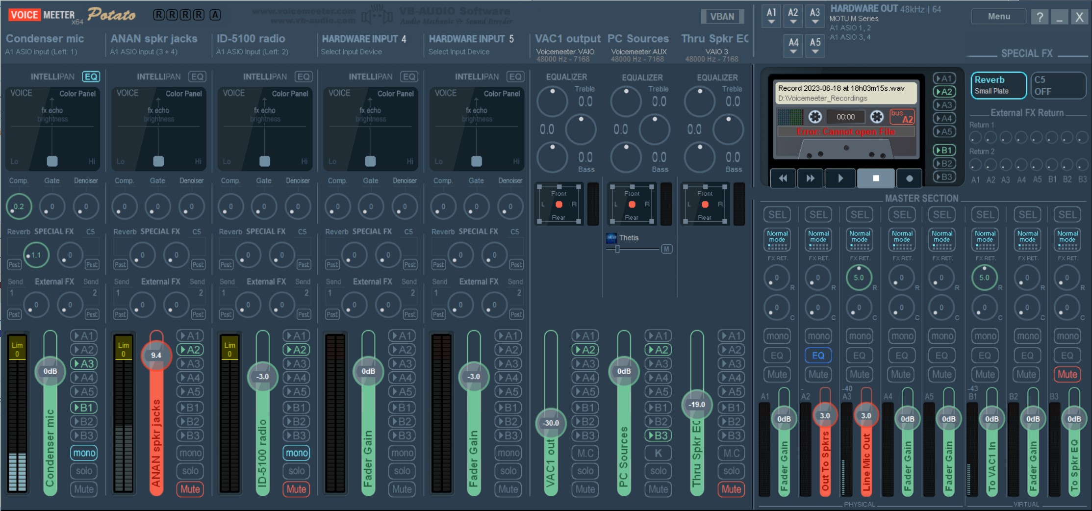

Thanks, Scott - I was hoping I'd still be able to utilize VM Potato, as I'm using VMP's Hardware Input IntelliPan EQ and Reverb for tailoring my mic audio and I didn't want to give that up.
One question, I haven't been able to find any Thetis mic audio level adjustment that works after I enable cmAUDIO, how are you adjusting your mic input level in Thetis?

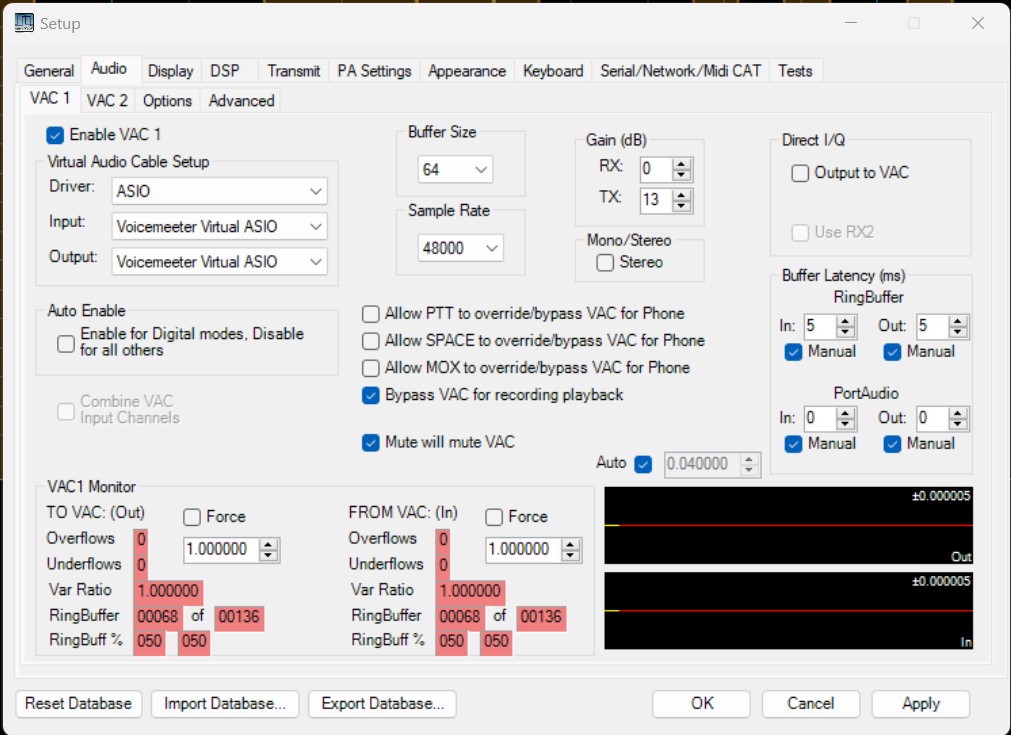

Scott, can you please post a screenshot of your VAC1 setup?
Posted: Sun Dec 10, 2023 9:53 pm
I'm no longer using VAC1. It's not relevant when using cmASIO.

I'm struggling to get mic audio from VM Potato into Thetis for TX. How can I get my condenser mic audio from Voicemeeter Hardware Input #1 into Thetis without using VAC1?
Screenshots attached
VM Potato.jpg (423.46 KiB) Viewed 77499 times
Audio VAC1.jpg (148.63 KiB) Viewed 77499 times

K1LSB wrote:I'm struggling to get mic audio from VM Potato into Thetis for TX. How can I get my condenser mic audio from Voicemeeter Hardware Input #1 into Thetis without using VAC1?
Make sure you are running Thetis 2.10.3.5 pre-release 3 (or newer). Then...
1. Quit Thetis.
2. Run regedit.
3. In regedit look at Computer\HKEY_LOCAL_MACHINE\SOFTWARE\ASIO
4. Check that you have an entry called Voicemeeter Virtual ASIO.
5. In regedit look at Computer\HKEY_LOCAL_MACHINE\SOFTWARE\OpenHPSDR\Thetis-x64
6. Right click in the right hand pane of regedit and select New > String Value. Name it "ASIOdrivername" (case sensitive, without the quotes).
7. Double click the new string value ASIOdrivername and give it a value of "Voicemeeter Virtual ASIO" (case sensitive, without the quotes).
It should look like this when you are done (you don't need an entry for "ASIOblocknum", that's just me fooling around):
8. Close regedit.
9. Start Thetis.
10. Disable VAC.
At this point you should find audio from Thetis on Voicemeeter channel B1. Any audio sent to Voicemeeter channel B1 will be used for transmit.

Mine seems to be working as described after I put what I believe to be the actual ASIO driver name into the string value. Thetis sound functions whether VAC is enabled or not. I'm still getting my mic sound through B1 in Voicemeeter. Now the only way to MUTE the sound is to reduce RX1 level manually.
When I ran hostsample.exe it reported 6 drivers. I tried each one in the string value named "ASIOdrivername" The first one reported is the only one that seems to function closest to Scott's description. All the others cause the sound to stop functioning when VAC is disabled. Whether it is correct now I don't know for sure. I guess we will know more when Scott reports in. I am sure that sound from Thetis is as stable as a rock whether receiving or during transmit.

The instructions that I wrote above are specific to Mark and specific to his desire to use Voicemeeter. If it's not working for Mark it's more than likely a Voicemeeter configuration problem and not any problem with cmASIO configuration.
As for the rest of you, the answer is simple: enter the precise name of the ASIO device you wish audio to flow to/from. If that's Voicemeeter, then great. If that's a UMC box, that's good, too. Etc. and so forth...

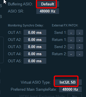

For everyone who wants to use VM Asio drivers, the 2 settings on the screenshot are important (thanks to Richie for that information)
The driver names for Voicemeeter are:
B1: "Voicemeeter Virtual ASIO"
B2: "Voicemeeter AUX Virtual ASIO"
B3: "Voicemeeter VAIO3 Virtual ASIO"
73 de Ernst, OE3IDE
