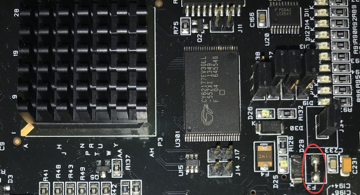

Well, my new fuses arrived in the post yesterday and I had some time to open my 100D for the first time this morning.
I was shocked to discover that the prior owner of my 100D had already replaced the F3 fuse with a wire bridge. I purchased the rig more than 2 years ago and didn't recall any mention that it had been modified. But this could be a lost thought on my part.
I will reassemble my rig and try the Protocol 2 uploads again to reconfirm my prior investigations. Barring a different result (yes, I too do stupid from time to time) I will have to challenge the effectiveness of the F3 fix.
I did take a couple pictures of my board and will be happy to share them, but I have no way to post them to this site.

It is easy to post photos. When making a new post, look down below the Preview and Submit buttons. You will see some other options and a tab marked "Attachments". Click that tab and then click the "Add files" button. Add the file then click the "place inline" button and the right codes will be added to your post wherever the cursor insertion point was last located.

Ok, I overlooked the attachments tab...
Here is a close up of the bridged F3 fuse.
100D F3 Brigded.png (562.63 KiB) Viewed 55634 times
And this is the whole board is shown below.
I hope this helps...
