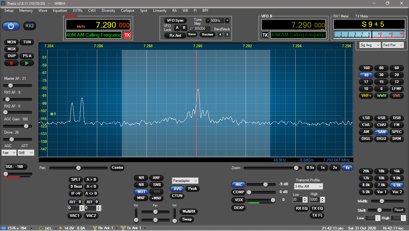

Just installed 2.8.11 running a 7000DLE.
I used the database from the 2.7.0 and everything is working except the dBm display at the right hand corner of the panadapter is not reading properly.
The peak on the panadapter shows for instance -85 but the diplay only shows -8.3.
I switched back to the 2.7.0 program and it is reading correctly.
I have done the whole database reset thing and still no joy.
Any body else seeing this?

Re: Thetis 2.8.11 Released!
That number is supposed to represent the amplitude and location of the largest signal in the spectral display window. I never notice it because I always have PureSignal turned on. But I tried it and the amplitude measurement does seem broken.

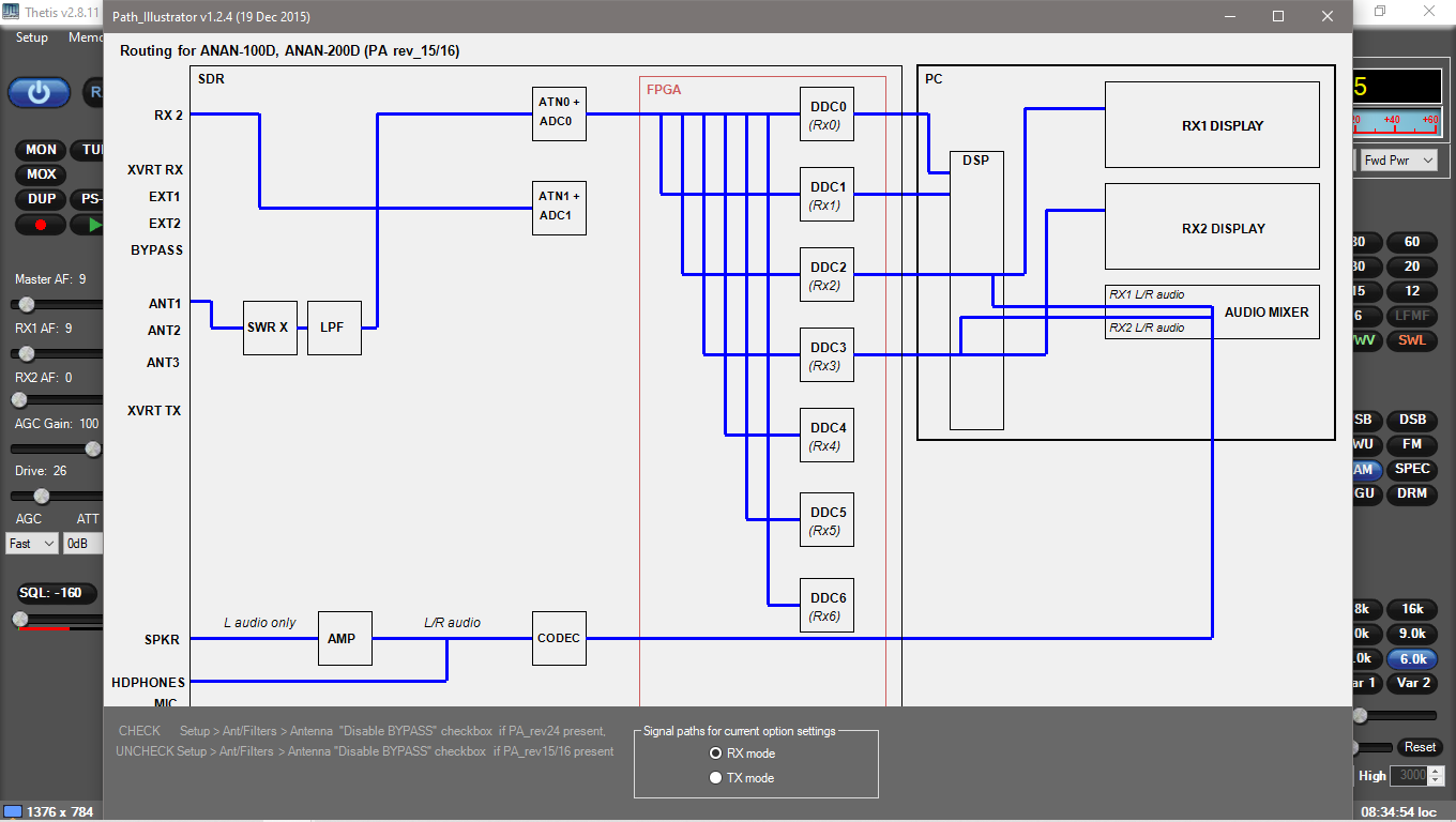

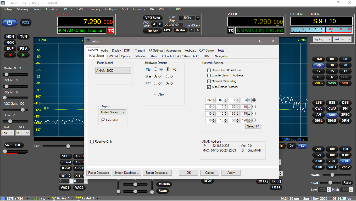

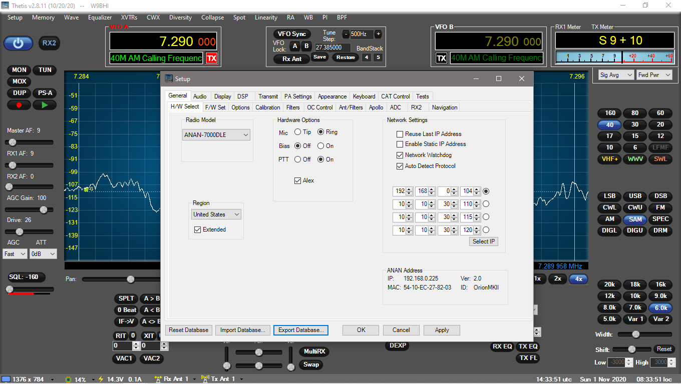

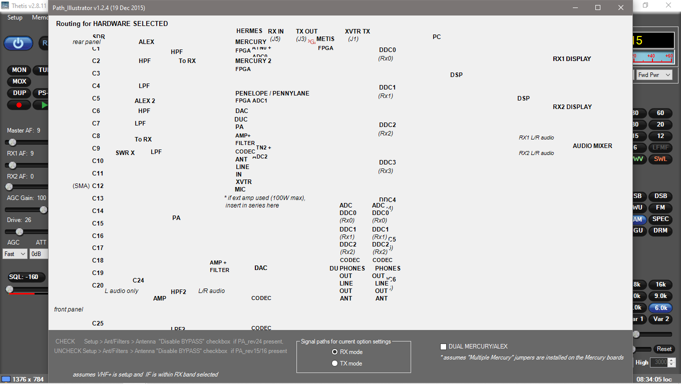

The Receive Only checkbox is missing on the 7000DLE selection, it is present on the 200D and the 8000DLE selection.
The PI (path illustrator) appears to be the wrong one or is corrupted in the 7000DLE and 8000DLE selection but is ok in the 200D selection.
This is from the same fresh database install as the previous post.
Don W9BHI
Don W9BHI
- Receive box on 200D

- No Receive box 7000DLE
- Screenshot (118).png (215.56 KiB) Viewed 48176 times
- PI on 200D
- Screenshot (121).png (115.19 KiB) Viewed 48176 times
- PI on 7000 and 8000
- Screenshot (119).png (132.34 KiB) Viewed 48176 times

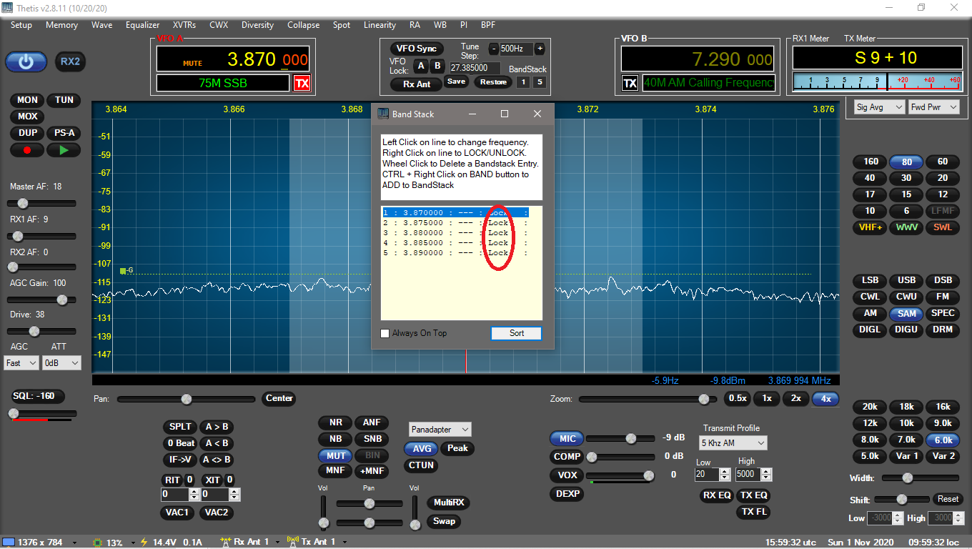

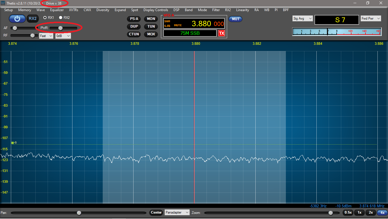

As long as we are looking at bugs and or features that are non functional, the band stack lock feature doesn't work (I don't think it ever worked). Even if you lock saved frequencies, if you change VFO A it will over write what is in the band stack list and save the frequency you set VFO A for.
The drive level on the screen in the collapsed mode doesn't change when the PWR slider is moved although the drive level actually does change.
The numbers are not updating in the program.
Just telling you what I am seeing.
Don W9BHI
Don W9BHI
- Collapsed screen power number
- Screenshot (122).png (160.41 KiB) Viewed 48153 times
- Band stack lock
- Screenshot (123).png (258.66 KiB) Viewed 48153 times
x2 on W9BHI's comment re: the Path illustrator re: the 7000dlemkii. Having the Anan-100 type routing diagram available in Thetis 2.8.11 for the 7000dlemkii would be highly useful.
Taiga.
Taiga.
Unfortunately Path Indicator is far from finished. It doesn't really work at all on the 8000 with Protocol 2 firmware.

RX2 has audio glitches, like data gaps. They vary randomly. If severe, I can see them in the panadapter. Twice, during severe glitch episodes, I noticed red error text below the waterfall, but they disappeared before I could read them.
The issue is also present in the x86 version. I tried changing the RX2 sample rate from 1536000 to 768000 to 384000 with no change. (RX1 sample rate is 384000.)
2.7.0 a3 did not have this issue.
73, John W1JA
x64
200D
Protocol 2
73, John W1JA

Did this ever work? In PowerSDR?K1LSB wrote:Not sure if this is the proper place to post this, but I can't seem to make the RX EQ work for RX2.
Am I doing something wrong or is that a bug?
