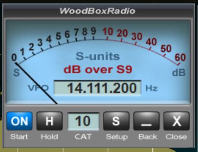

I have some Woodbox Meters successfully running with Thetis and PowerSDR.
Of course I don't have them all in operation at the same time. But it is possible.

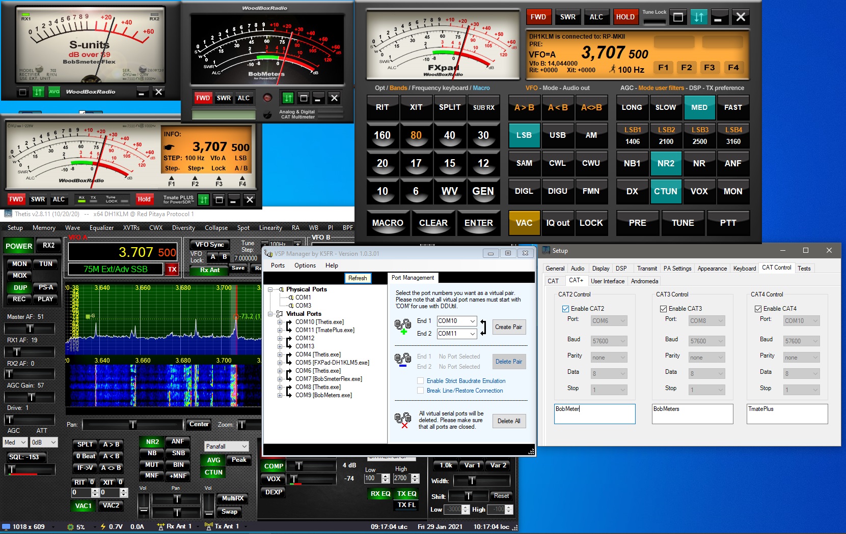

I see from DH1KLM's print screen, that he has two virtual ports assigned for Bob S Meter. Is the second port required or perhaps the second is assigned for use with a another transceiver? I also see what looks like multiple instances running. So, perhaps that's why.w-u-2-o wrote:"One serial port pair is all you need, and if you've already got DDUtil installed and running then you already have virtual serial port software installed and running."
Re: Bob S Meter
This is the way it works.
Virtual Comports are building a pair. So one port has to be setup in Thetis and the other port has to be setup in Bobmeter.
You have to think of it like a cable with a plug on each end. One connector is COM3 and the other connector is COM4.
COM3 "is" in Thetis COM4 "is" in Bobmeter.
The multiple instances you see are a result of having four different meters connected to Thetis at once.

OK, running great with just one virtual port. Thanks to everyone for their suggestions.w9ac wrote:I see from DH1KLM's print screen, that he has two virtual ports assigned for Bob S Meter. Is the second port required or perhaps the second is assigned for use with a another transceiver? I also see what looks like multiple instances running. So, perhaps that's why.w-u-2-o wrote:"One serial port pair is all you need, and if you've already got DDUtil installed and running then you already have virtual serial port software installed and running."

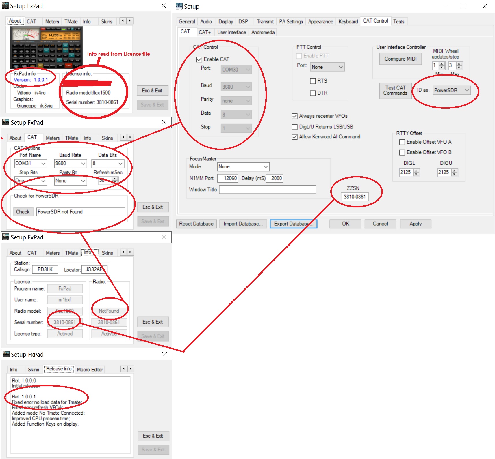

Hi Sigi, i do have FX-Pad, the downloaded version 1.003 includes even the .lic file, but as soon as the program starts it freezes. Can only kill it with Program Manager.  I tried different compatability settings without luck. I'm running the most recent version of Win10 64b. Do you have a suggestion?
btw I also have v1 (without a lic file) but that one says it is expired.
						Re: Bob S Meter
Probably won't work.
Assuming that your Virtual Com ports are set up.
Rename the .lic file. Start FxPad without running Thetis. FxPad now should run in trial mode (maybe trial period is over).
If this is working, close FxPad, rename your .lic file back to fxpad.lic. Start FxPad again without running Thetis.
It should startup correct and show the "License info" in Setup/About. In Setup/Info now all fields should be populated with license informations (assume the radio model is a flex 1500 ). The "Radio" is blanked out.
Do not stop FxPad.
Start Thetis, go to Setup/CAT Control, in ZZSN field enter the serial number which is shown in FxPad/Setup/Info,
click Apply and OK in Thetis. In FxPad/Setup go to CAT, click Check for PowerSDR, PowerSDR active on Port: (your port) should appear. And now the strange thing happens. FxPad/Setup/Info now shows Radio flex5000 although the serial number is for a flex1500, flex5000 is displayed here and license type is expired for that reason.
Either something is wrong with the .lic file, or FxPad interprets the flex1500 serial number incorrectly.
So no joy with this .lic file.
Are you willing to test this procedure with the older FxPad V1 software? Maybe the .lic is working there.
FYI: Regardless of whether you enter a serial number of Flex1500 / 3000/5000 in Thetis, 5000 is always displayed as the radio type in FxPAd. The exception is ZZSN 0000-0000. This leads FxPad to show demo mode as radio type.
 ). The "Radio" is blanked out.Do not stop FxPad.

Thanks for your help Sigi!, but sadly no luck.
FXPad is no longer freezing after i cleaned the registry from all FXPad rules.
Followed your guidelines exactly but FXPad can't find PowerSDR (ZZSN field and virt serial port setting are ok, see picture)
I tried both versions but i think the .lic file was made with/for a Flex1500.
I suspect FXPad is not only searching for the correct serial number but also for the correct radio model, so i give up unless someone has a sollution or want's to share a working .lic file for Thetis.
Demo (0000-0000) does work but there's not much you can do. The only other thing left is brute force ZZSN numbers in the hope there's a backdoor
				- FXPad.jpg (460.16 KiB) Viewed 21124 times
