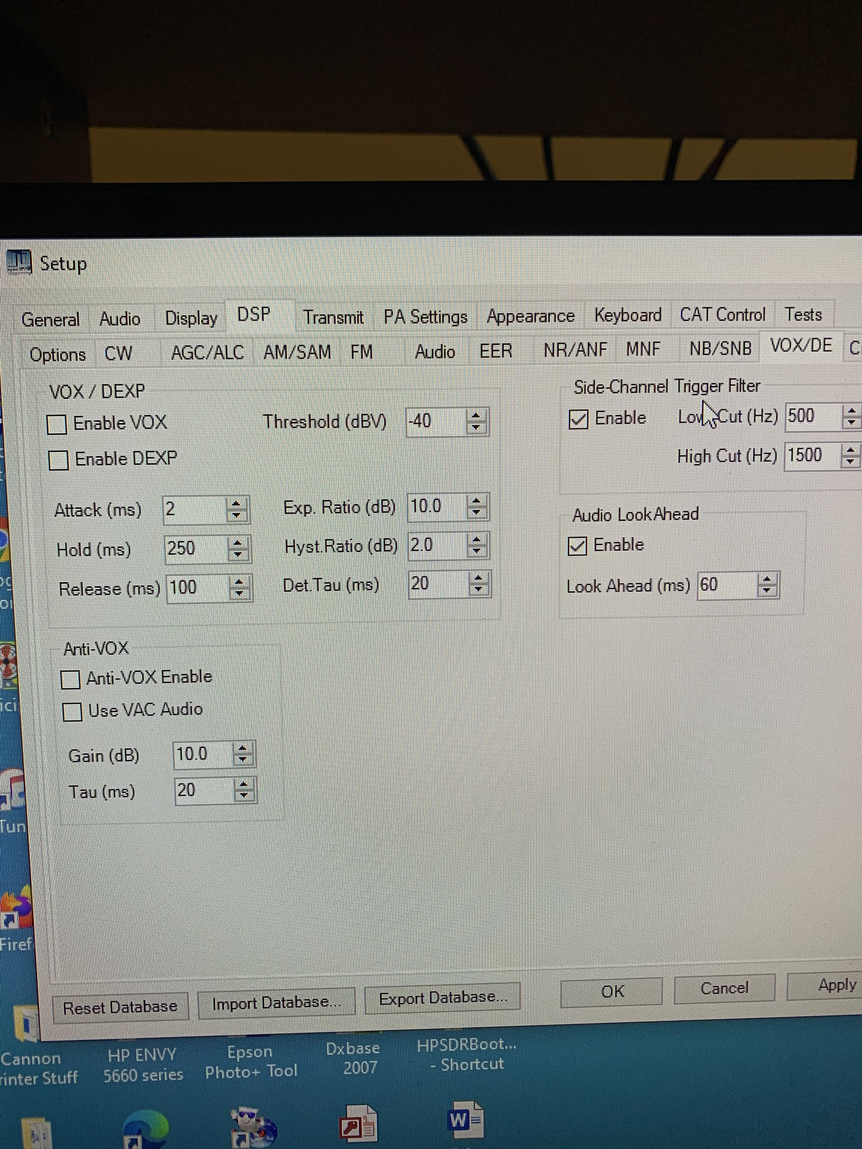

Joe, I notice if I have the downward expander ON with 2.8.11 either 32 or 64 bit I get a keyup spike or burst. When running the Amp the spike can be 150 - 200 watts so I have discontinued using DEXP.

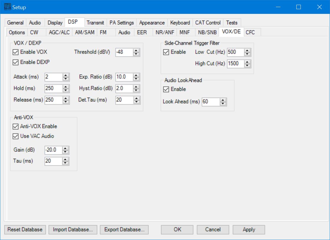

Post your DE settings. Perhaps there is something that can be fixed. Because I can't think of anyone else with this problem.

Scott I tried different settings but we have the settings back to default. Any help or settings would be appreciated.
I did read the instructions for it's use.
tnxs & 73 de KE4WY Jim

If you are only using DEXP and not VOX it probably shouldn't matter, but try setting your Anti-VOX gain to -20 and enabling Anti-VOX.
You did not say if you are using VAC for TX, RX or both. Are you?
