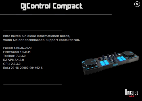

Have you installed the Hercules suite of DJ controller or only the USB driver that is automatically installed by Windows when you plug in the first time the controller USB cable?
Re: Slowing Wheel Tuning Speed
I have also installed the Hercules software.
Image 4.jpg (57.16 KiB) Viewed 10784 times
