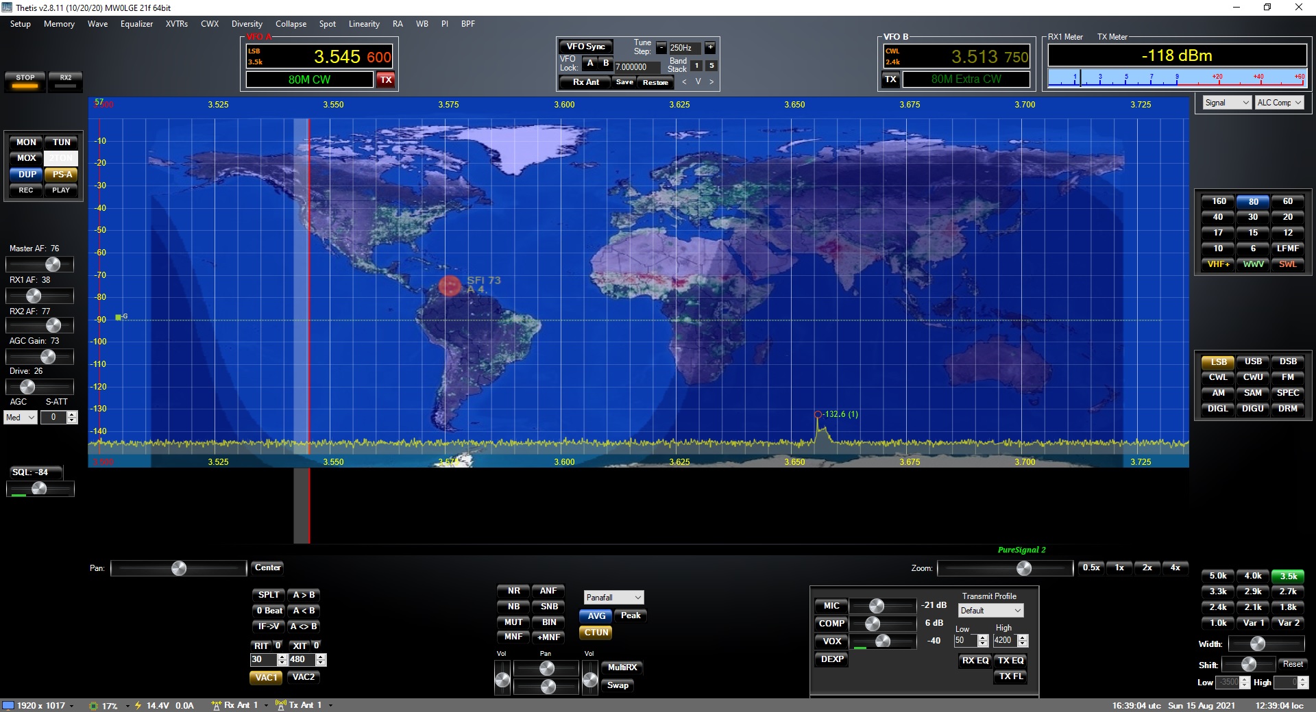

Folks, have a look at the attached desktop screen running Thetis 21f. Notice that the background of the 2-TON button changed from white-on-back to yellow-on-light gray. This occurs only after clicking the 2-TON button to establish PureSignal optimization. It's fine when the program starts.
I do have some custom display color settings, but that's the only button I've noticed that changes to a light gray background and doesn't change back. Thetis' video driver is Direct X. I use a four-port Radeon RX560 Graphics card connected to three Dell 1080p monitors with a DisplayPort connection. Ideas?
- Thetis Screen-W9AC.jpg (476.88 KiB) Viewed 25174 times

no problems with the 2tone-Button here.
Pls check your skin folder if chk2TONE-0.png and chk2TONE-1.png are present.
Both files are missing. Is there a means to get just those two files? The problem persists no matter which skin I use.DH1KLM wrote:Pls check your skin folder if chk2TONE-0.png and chk2TONE-1.png are present.
There are some infos about these buttons on the top of this thread. Anyway just copy chkMOX-0.png to chk2TONE-0.png and chkMOX-1.png to chk2TONE-1.png and all is good
Alternatively, you can also use one of my skins.

Ernst,oe3ide wrote:There are some infos about these buttons on the top of this thread. Anyway just copy chkMOX-0.png to chk2TONE-0.png and chkMOX-1.png to chk2TONE-1.png and all is good
Many thanks. I'll give it a try.
Thanks Sigi, I've been looking for this.DH1KLM wrote:I made 2Tone buttons for the following skins. IK3VIG Special, OpenHPSDR-Gray, W1AEX Dark Metal, W1AEX High Visual.
They can be downloaded as a zip file from https://drive.google.com/file/d/1eELS_G ... sp=sharing
You only have to copy the contained button pics into the corresponding skin directory.
Usually at C: \Users\ yourusername\AppData\Roaming\OpenHPSDR\Skins.
I hope to be able to help someone with this.

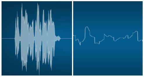

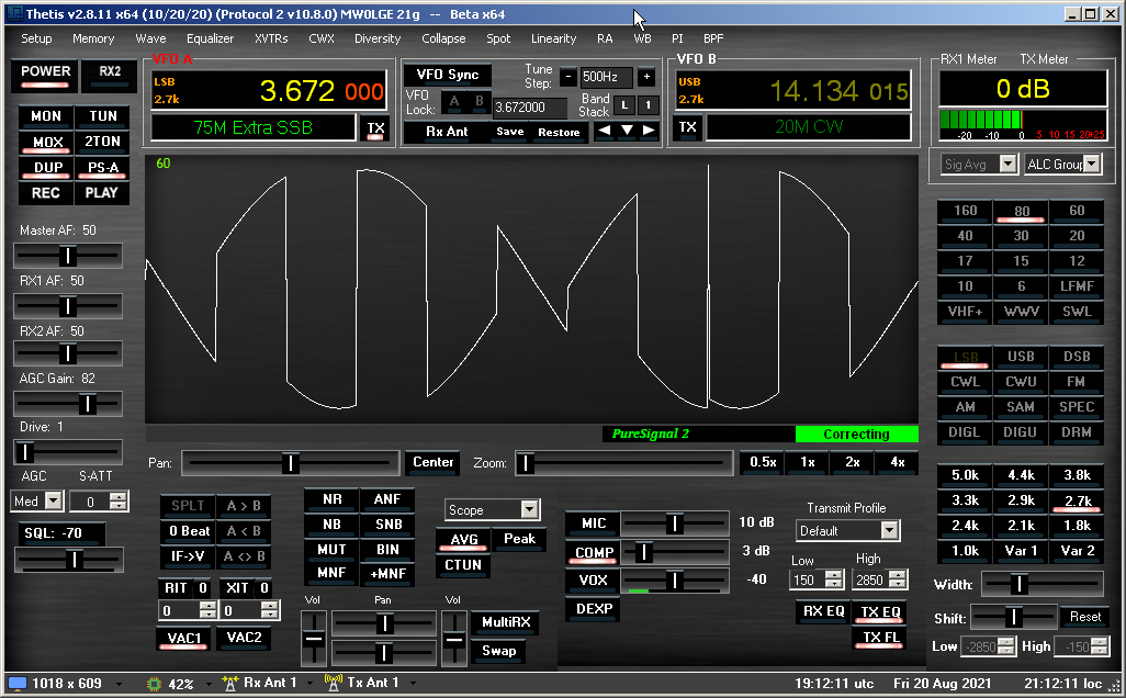

- fix: scope views now work again in TX mode (spectra scope panadapter issue still exists - todo)
- fix: scope now renders in DX2 correctly using filled geometry
In distorted TX trace there are flashing up large areas occasionaly.

Walter,
I will investigate that TX scope issue, seems to be more obvious at very short sample frame times.
ANAN100 has now been removed from the 31db limit. It sneaked its way in somehow
21h will see that change at some point.
Ref the fill. If you look at 2.8.11 display.cs DrawScope (gdi source to make it easier) you will see it actually uses a min/max for each pixel and with that creates a enclosed complex filled shape which defines the scope display (the majority of work is done through DoScope or DoScope2 in audio.cs). The min/max comes into play with slow frame times as you can see in the pic below, and it is not as simple as a single point. There are a number of samples per pixel, which will require a min/max value of those samples. Anyway, short story is DX2 version of DoScope was only drawing max points, so gaps would show up from time to time. It has now been recoded to be the same as the GDI version, which is draw lines and then fill poly.
ZZTU should have been ZZUT in the patch notes as ZZTU is indeed TUNE as you found. Not sure what zztu2 or zztu3 do as they both return ?, to me when tested using the cat command tester. ZZUT0 is 2tone off, ZZUT1 is 2tone on.
