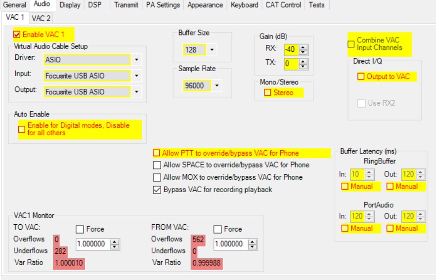

add: checkbox to tweak NetworkThrottleIndex registry entry in Setup->General->H/W Select tab, in the network settings group. Note: Thetis needs to be running as Administrator to make any change to this registry entry. State is read from registry.
add: option to close band stack window when entry selected
add: band stack entries can be shown in the spectrum (rx1 only), option is in BandStack2 options section. Colour can be changed in Setting->Appearance->RX Display. They only show for the current bandstack. They can be selected with a mouse click. Doing so will not update a stack entry that you might be leaving
add: filter edges are hightlighted by mouse when you are able to drag them
add: you can now resize filter in CTUN by hovering mouse on an edge and dragging
add: new Advanced audio tab. More settings will appear here over time

Posts: 6135
VERY excited about the advanced VAC settings. I'll probably start a separate topic to compare notes with others on these so as to not jam up this topic. I've lowered the Feedback Gain In and Out to .000001. Time will tell if this is more stable on my PC. If I let the radio run for 24 hours and it has not accumulated thousands of under/over-flows that'll really be something!

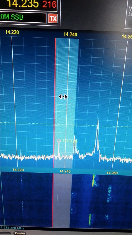

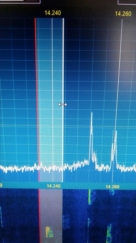

Using 21h2 - in CTUN mode:
Highlighting works, but moving the line does not alter the rx-filter, instead its tuning the vfo.
Same problem here.
DH1KLM
Posts: 222
Location: Germany
Post by DH1KLM »
For me it works without problems.
Big arrow changes VFO
Small arrow changes Filter
