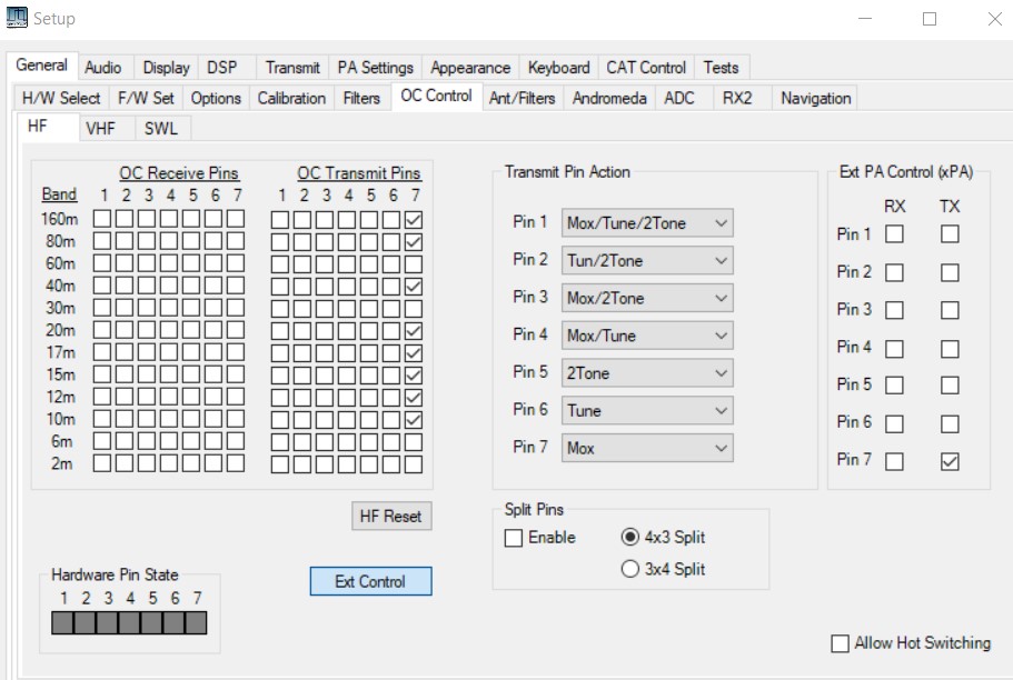

Guenter, as Ritchie noted you have 7 addition PTT's using the OC Control pins. I use it exactly that way that only the PTT will key my amp but if you use the Tune function it will NOT key the amp.
Here are all the AND OR you can choose. It is super Flexible:

Hello Gary,
thanks for your help.
Have checked and tested but for me, this way is not working.
My Amp is every time in TX mode when i click the TUNE Button.
Info: My ext amp becomes the PTT from the PTT Output RCA jack on the backside from the Anan.
For me, this way does not the right job hihi.
73 Guenter

Guenter, what version of 2.8.11 are you using?
What you are asking for is supported and works great to not key the amp when in TUN.
NC3Z wrote:Guenter, what version of 2.8.11 are you using?
But not for "PTT out"... its only possible via OC Output...
PTT out is not software controllable. afaik.
NC3Z
Posts: 493
Location: Merritt, NC
Post by NC3Z »
Ernst, that is what I told him in my first reply that you need to use the OC Pins for your PTT to make this happen.

First of all thanks for 21k3, Richie - OC now behaves exactly the way I need it.
@ Günter:
Often it's the little things that we overlook. So it's just an idea and I don't want to offend you. Did you notice that pin 13 on your Expert 1k5 wants to see 12 V in order to prevent transmission?
However, the OC pins of the Anan pull an applied voltage to zero.
So you would have to invert the signal. Connecting Pin 1 - 7 directly to pin 13 on your Expert wouldn't affect anything.
