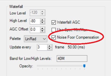

What is a "Noise Foor"? :D
Screenshot 2021-09-28 153115.jpg (32.24 KiB) Viewed 31564 times

Version 21k6 is running great here. Thanks for the change to the noise foor line. It's easy to see and fits in with the gain and hang lines perfectly. No anomalies noted except for a cosmetic item that showed up with the addition of the xPA button. If a skin uses the panelOptions.png as a background behind the upper left cluster of buttons it may repeat one line using the top of that graphic. The simple fix if it annoys someone is to rename the panelOptions.png file to panelOptions_.png to prevent loading that graphic.
Gary, the term foor is widely accepted on the west coast so you need to get up-to-speed with that!
