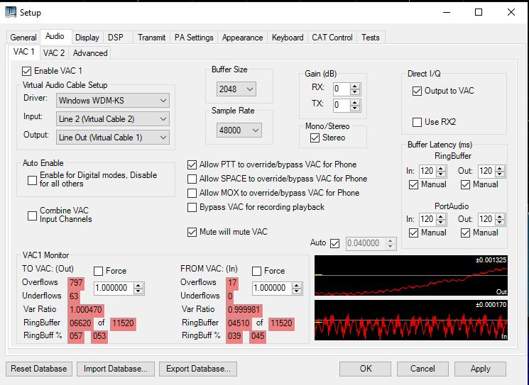

Hans,
Lower the audio drive level into Skimmer.
Post your Thetis VAC and Skimmer set up screens for review, if you like, and the setup for whatever you are using to transfer audio data (Muzy VAC or Voicemeeter).

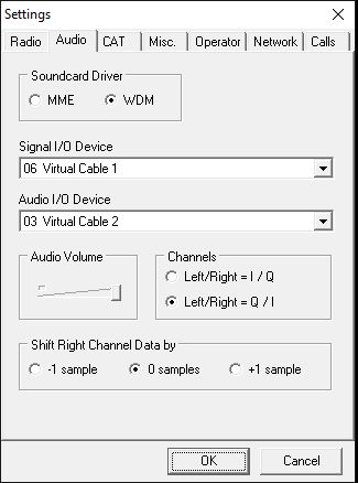

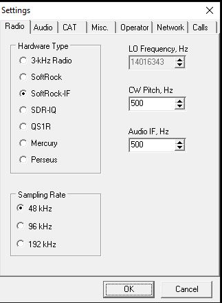

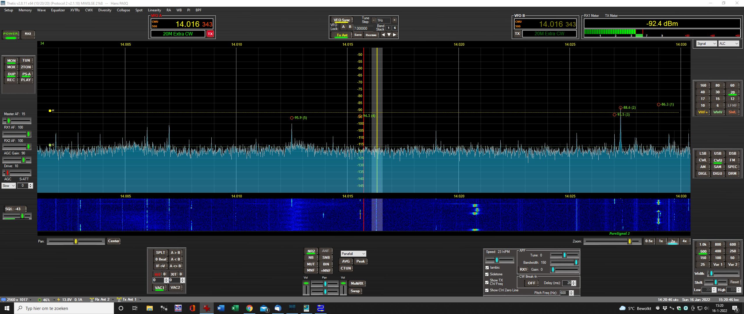

TNX for your reply Scott1
Enclosed you will find various screens with the settings.
Thetis 2.8.11.jpg (361.13 KiB) Viewed 4060 times
Thetis VAC1 settings.jpg (80.65 KiB) Viewed 4060 times
CW Skimmer settings.jpg (23.95 KiB) Viewed 4060 times
CW Skimmer settings radio.jpg (21.54 KiB) Viewed 4060 times

Re: Thetis and CW Skimmer
Not seeing anything wrong, Hans. Try lowering your VAC RX gain setting.
Unfortunately I don't have a license for CW Skimmer so this is a bit of a guess.
