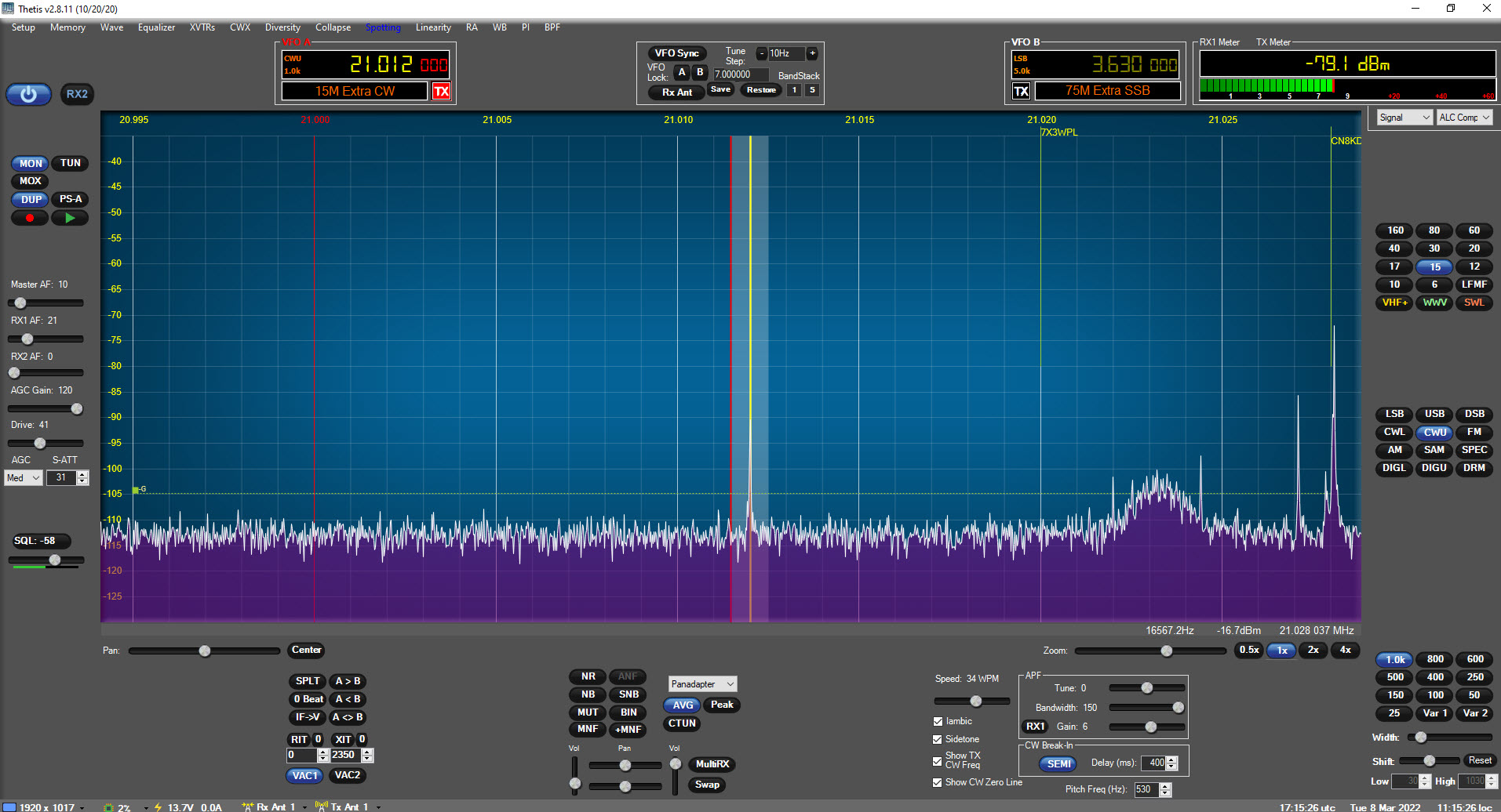

Embedding an image here.
For some reason I am not able to adjust the AGC level farther down as exhibited in this image. I don't think I had this issue previously. What gives? It appears that I don't have this problem on other bands.
Don't pay attention to the "bump" up the band. That is caused by an inverter inside my YETI Goal Zero emergency battery.
AGC levels.jpg (421.16 KiB) Viewed 2506 times

Hi Juha, it seems you are still using a older version. Most of us use. 2.8.11 MW0LGE 21k9. Now on revision rc3 but soon rev 4.
I think your issue has been solved sinds then.
Latest update is RC4b:
https://apache-labs.com/community/viewt ... 585#p18585
I believe your issue has been solved sinds then.
73, PD3LK

I see. Thanks!
