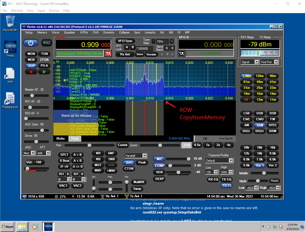

No Panadapter Display after 21k9 Update
edtyler
Posts: 9
Joined: Sun Mar 13, 2022 5:39 am
Post by edtyler »
Thanks for all of the hard work on Thetis by everyone, especially MW0LGE.
The waterfall display on the initial version of 2.8.11 worked fine with my new 7000DLE MKII, although it issued a warning about DirectX problems and noted thatit was going to use GDI+.
However, when I loaded the update and restarted with CTRL held down, the waterfall was all black. No directx warning was issued at startup.
Is there any way to force the use of GDI+ with 21k9? I am using a virtualbox VM host run Thetis and it appears that DirectX support is not working well with Virtualbox 6.1 on a Linux host.
One other question - is there a way to display the temprature of the PA heatsink?
Any help will be greatly appreciated.
Dale (W6EDT)

Re: No Panadapter Display after 21k9 Update
gdi+ was totally removed in 21g on 20th Aug 2021. If/when I get back to working on Thetis then there may be a need to add adaptor selection support, where Microsoft Basic Render Driver can be selected. In the mean time, run dxdiag.exe and attach screen shots of info related to primary display. Also, any screen shots of Thetis error messages and a copy of ErrorLog.txt.

Thetis displays no errors - just a blank waterfall.

As requested:
ErrorLog.txt: (last entry)
Entry : 4:57:25 PM Friday, March 25, 2022
HRESULT: [0x8899000C], Module: [SharpDX.Direct2D1], ApiCode: [D2DERR_RECREATE_TARGET/RecreateTarget], Message: Unknown
at SharpDX.Result.CheckError()
at SharpDX.Direct2D1.RenderTarget.CreateBitmap(Size2 size, IntPtr srcData, Int32 pitch, BitmapProperties bitmapProperties, Bitmap bitmap)
at SharpDX.Direct2D1.Bitmap..ctor(RenderTarget renderTarget, Size2 size, DataPointer dataPointer, Int32 pitch, BitmapProperties bitmapProperties)
at SharpDX.Direct2D1.Bitmap..ctor(RenderTarget renderTarget, Size2 size, BitmapProperties bitmapProperties)
at Thetis.Display.ResetWaterfallBmp()
at Thetis.Display.set_CurrentDisplayMode(DisplayMode value)
at Thetis.Console.comboDisplayMode_SelectedIndexChanged(Object sender, EventArgs e)
at System.Windows.Forms.ComboBox.OnSelectedIndexChanged(EventArgs e)
at System.Windows.Forms.ComboBox.WmReflectCommand(Message& m)
at System.Windows.Forms.ComboBox.WndProc(Message& m)
at System.Windows.Forms.NativeWindow.Callback(IntPtr hWnd, Int32 msg, IntPtr wparam, IntPtr lparam)
First Page of dxdig (64 bit) output. The screen display shows

I have zero experience of VirtualBox, and I am not entirely sure if the software VirtualBox video driver supports enough features. However, after a quick read around, do you have Guest Additions added, and 3d + 2d acceleration enabled? I expect this will need a hardware gpu, quote from the manual : 'Technically, Oracle VM VirtualBox implements this by exposing video overlay DirectDraw capabilities in the Guest Additions video driver. The driver sends all overlay commands to the host through a special communication tunnel implemented by Oracle VM VirtualBox.'
https://www.virtualbox.org/manual/ch04. ... tadd-video
and the VirtualBox manual mentions the following, which does not instil confidence
- Because 3D support is still experimental at this time
- Because 2D support is still experimental at this time

Thanks for your reply. Yes, Guest Additions are enabled, using Safe Mode and the 3D extensions are installed. Many things in Virtualbox are labelled "experimental" but work just fine.
That said, the primary difference between the Virtualbox VM dxdiag output is: AGP Texture Acceleration: Not Available
I can't make much sense of the stack trace from Errorlog.txt, but maybe someone can chime in on what it means. For now, I can run 2.8.11 without the updates in the VM or use a physical machine running Win7 to access the radio.

I have done some testing, and the vitrualbox 3d driver (which is experimental) is ok with the vector/line stuff, but is failing with the bitmap creation used for the waterfall. It might be because I use a premultiplied alpha, not sure. Another issue is that using the directX debug flags also cause the virtualbox driver to to error possibly because they have not implemented it yet, who knows.
Posts: 1596
It looks like the experimental part of this, is non working experimental :D The lack of AGP Texture Acceleration will not matter.
After many hours of looking into this, it seems that DirectX function ID2D1Bitmap::CopyFromBitmap is either not supported or is broken in the VirtualBox video driver. CopyFromMemory works which is used for the new row in the waterfall as can be seen in the image.
In other words, this is not going to work until they get around to fixing/completing their graphics driver.

yes, but that profiler makes no use of the CopyFromBitmap function. I too have run it here which is why I posted 'is ok with the vector/line stuff' previously. VBox directX support It is just far to experimental it seems and not being able to use the debug flag is :shock:

Thank you so much for investigating this. Understanding the deficits in the Virtualbox 3D driver will help drive improvements in that area (i hope).
For now, it looks like using a Win7 physical machine is my best choice. I can also use unpatched 2.8.11, but that is not a good path forward.
