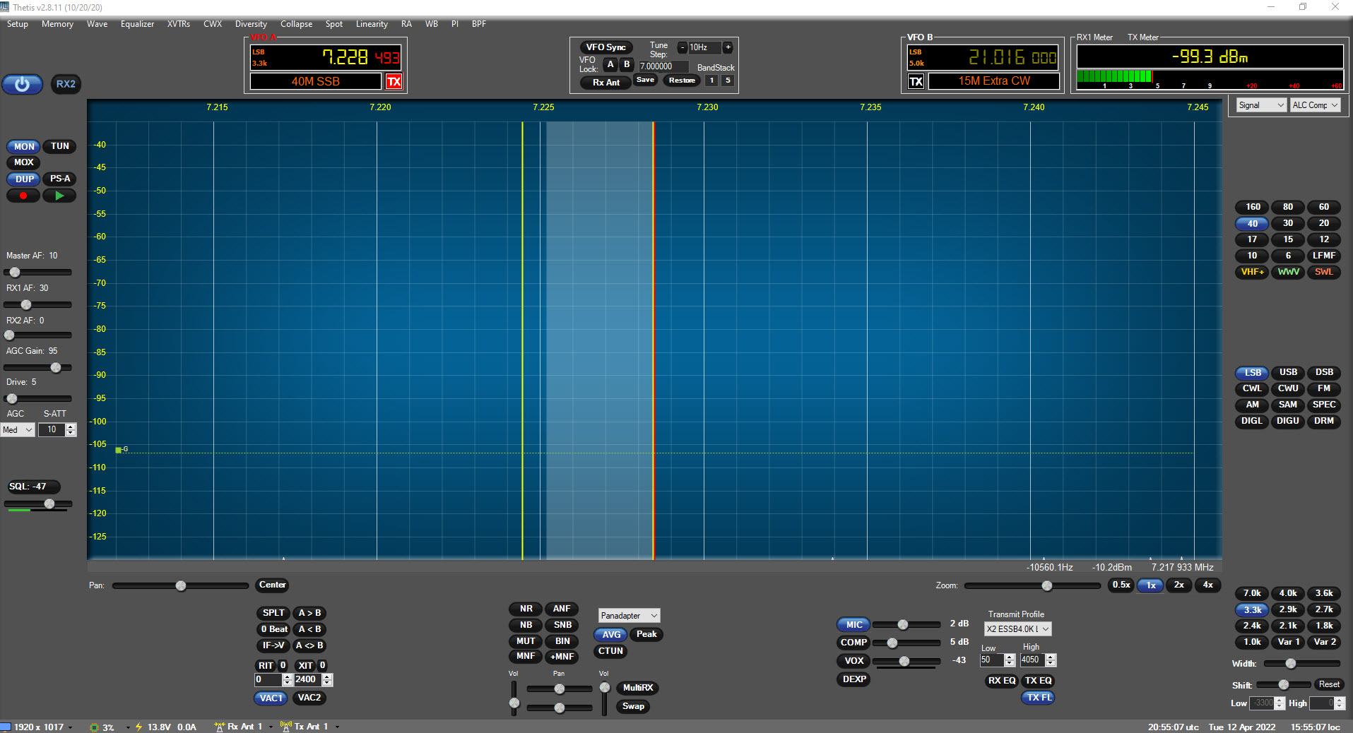

Kind of surprised at seeing "LSB 5.0k" in VFO B. Did get on 15m CW today which is right, but why the rest is out of kilter?

It should have said CW with the bandwidth of 1k or perhaps I don't understand this...... I was using XIT trying to work a DX on 15 so I expected a "corresponding" mode indication and bandwidth. Don't understand where the LSB and 5k bandwidth came from as I don't often go that wide on LSB......and I don't often use VFO B (I assume that when I am on VFO A and select the XIT feature VFO B isn't evoked at all.....)

How about a screenshot? Otherwise we dont have a clue what you are seeing.

It needs to be of the entire user interface, not just a close up of VFO B

Below, see screen capture.
Re: Weird display in VFO B
That is strange. I was not able duplicate that configuration. I put VFO A on 40M. Then I activated RX2 and manually set the frequency, mode and filter bandwidth to LSB and 5K. Then I disabled RX2. VFO B mode and bandwidth reverted to the same as VFO A. Try as I might, I cannot get VFO B to have a different mode and bandwidth from VFO A when RX2 is disabled.
It might be that your database is corrupt somehow. You might try saving it and going back to a reset database to see if the condition persists.

BTW, There have been one or two fixes since 2020.

fix: labels on VFOB box show correct mode and filter when RX1 is the only rx in use

Thanks Richie! Yup....I am using P1, Thetis version that came with my radio still

Yeah, you need to install a new versionJJ4SDR wrote:Thanks Richie! Yup....I am using P1, Thetis version that came with my radio still
