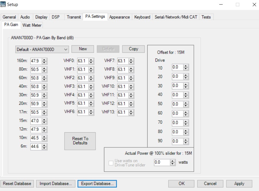

Regarding the PA calibration topic, is there anything I have to do if running a fresh install of Thetis? I noticed my stated wattage output is 100 watts when the drive slider = 50.
What do I have to change to make 100 slider = 100 watts?
Attached are my existing (default) settings. Do I need to calibrate? Any instructions on how to do so?
Those are the correct settings for a 7000. So interesting you get 100w at 50, it is as if it is actually an 8000.dynamicfusion wrote:Regarding the PA calibration topic, is there anything I have to do if running a fresh install of Thetis? I noticed my stated wattage output is 100 watts when the drive slider = 50.

Edit: I just deleted my database.xml, so it built a new one. I picked 7000dle, the drive was defaulted to 50. ~55w into a dummy load on tune, on 80m
Also if you are using an external watt meter you can calibrate the internal wattmeter in Thetis. If you haven't already done that. I did that again a few week ago after I first reconnected everything at my new QTH. It's great how closely it all works now.ramdor wrote:Those are the correct settings for a 7000. So interesting you get 100w at 50, it is as if it is actually an 8000.dynamicfusion wrote:Regarding the PA calibration topic, is there anything I have to do if running a fresh install of Thetis? I noticed my stated wattage output is 100 watts when the drive slider = 50.
