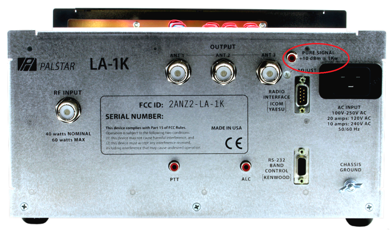

I recently just received my Palstar LA-1K and noticed it has a Pure Signal Jack on back, anyone using it and how would it connect to the Anan 7000 MKII Black?

If it were me I'd just run a cable between that jack and the Rx Bypass jack on the Anan.
It'd need to be a custom cable, with a BNC connector on one end and an RCA plug on the other end.

Mark is correct, of course.
You need to set the "Bypass on TX" option in the settings so that the radio uses the external feedback signal instead of one from the internal coupler.

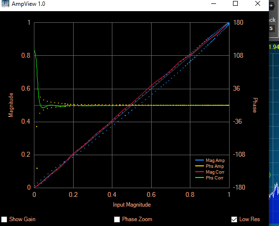

Here's my 1st attempt running 500 watts cable from Palstar amp to 8000.
Any comments would be helpful. Thanks

The data shown on the AmpView display looks not so good. Linear, but those lines should be filled in more, and the blue line should not make a "loop". What does it look like with the Low Res box unchecked, what does the DUP display look like, i.e. what kind of IMD products are you getting?
