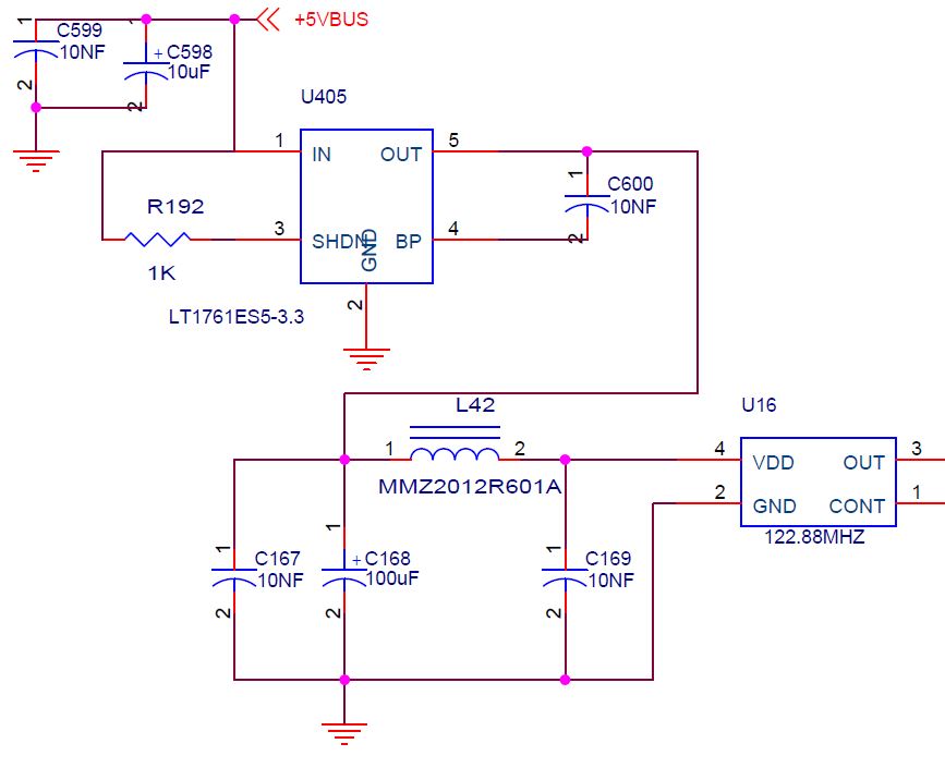

I would think 4 A and C could be part of the problem here. Just trying to figure out exactly what it is. Do we actually know what specific changes were made for power rails/LDO's and LDO on the master clock?
If the schematics I have are correct we do know precisely what the changes are. The only change is the addition of an LT1761ES5-3.3 LDO regulator on the input to the 122.88MHz VCXO instead of feeding it from the 3.3V rail directly.
Perhaps could there be a problem with them?
Perhaps, but I can't think of what they might be.
I had to edit this post. It had previously focused on the output capacitance provided for the LDO regulator, and of course there is plenty, with C600, 167 and 168 in parallel on the output, as shown in the schematic snippet below.
