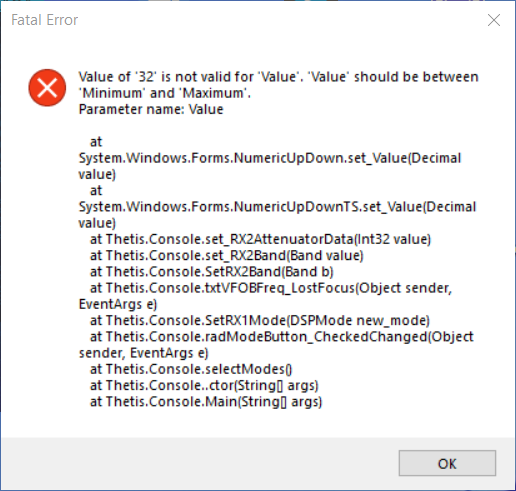

Starting Thetis 2.9.06 this morning coming up with the following fatal error:
What can I do? What is the problem?
Thanks a lot!
73 Georg, DG9FDA
Thanks a lot!
73 Georg, DG9FDA
Anan 100D first edition, Thetis v2.10.3.6 x64, Protocol 2 Version 12.1.8
Problem solved, corrupted database!
Thanks, Georg DG9FDA

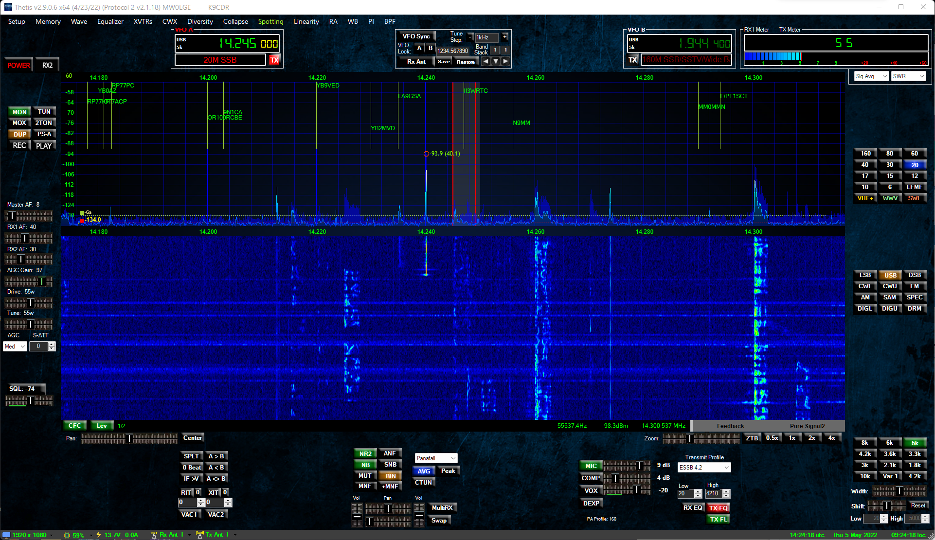

---WANT/WISH---
With respect to the current "original" style meter and possibly any additional bar graph type ones that might be coming in the near future, maybe add a checkbox in the setup to use the panadapter gradient coloring for the meter bargraph(s) as well kind of like I've emulated in the screenshot or add another gradient to customize it further than 'left color' and 'right color'.
Thank you again for ALL the hard work and amazing software we have!!!
Cheers!
Cheers!
- Panadapter gradient with similar 'original' meter coloring
- Screenshot 2022-05-05 092432.png (1.97 MiB) Viewed 25093 times
Cory K9CDR
please send me the database that is causing thisDG9FDA wrote:Starting Thetis 2.9.06 this morning coming up with the following fatal error:
Thanks a lot!
73 Georg, DG9FDA

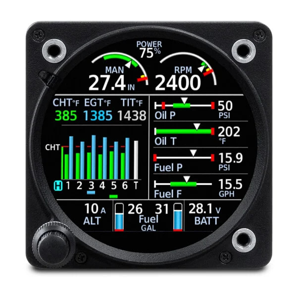

You are confusing "analog" as equating to a dial type indicator. Anything with a pointer on top of a scale is "analog", so that includes bar type meters as well. I'm not against analog presentations of data, in fact they are very important. But old style moving coil meters represent a huge design compromise associated with inflexible hardware, limited panel space, and cost considerations. None of these factors are associated with modern software-driven, information displays.
When you look at any modern EIS (engine indication system) in an aircraft, and I stress modern because you can find some really dumb stuff in older instrumentation designs, you find:
1. A single value per meter, be they dial or bar type.
2. Rarely two values per meter, and only on dial types.
3. If there are two values those values are closely related somehow.
4. If there are two values they either share the same scale or the scales are physically part of different meter areas. Under no exception is more than one scale shown in an overlapping manner, they are always on different parts of the dial. There is one special exception to this that I can think of (see below).
5. In most cases the actual value is also indicated numerically.
Both analog and numeric presentations are important. This way you can obtain both a quick, general idea of the state of the value from the analog presentation, as well as a very precise measurement from the numeric presentation.
These are all excellent UI and ergonomic guidelines, and that's how modern cockpits are designed. Old-style, moving coil simulations meet almost none of the guidelines. Metering in Thetis or any other modern SDR software should meet these same guidelines.
Here's an example of a relatively low cost display that is currently available. It displays no less than 24 parameters
3 numeric only parameters
9 combined analog and numeric parameters
12 analog parameters summarized by two numeric parameters
The one special exception I alluded to is the engine/rotor RPM display in a helicopter. Many of these (not all, not the one in my helicopter) display both rotor and engine RPM over two disparate scales. However the pointers and scales are arranged so that under nominal operating conditions both pointers are aligned right on top of each other, or nearly so. This is one of the rare exceptions, and there are unique ergonomic requirements associated with the maintenance of rotor and engine RPM in a helicopter that make this exception desirable.

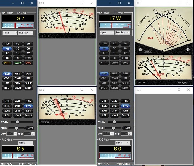

The meters are fabulous Richie and beautiful art work by Ernst! Thank you for all the effort going into this! Just my opinion here but as a ham who grew up in the analog era of electronics I love the arc and swing of a nice big meter. Major props to you for having the skill to calibrate the multi-meter scales. Amazing!ramdor wrote:Hey all,
Well, a day of sorting out data to image calibration, so I just had to implement a cross needle meter. The images are thanks to Ernst, OE3IDE.

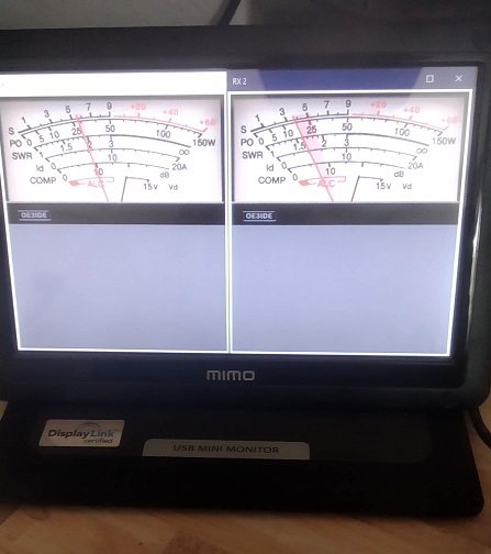

I would love to see something like this in ThetisDH1KLM wrote:The new meters looking terrific.
- mimo.jpg (56.11 KiB) Viewed 24899 times
- meters.jpg (140.28 KiB) Viewed 24899 times

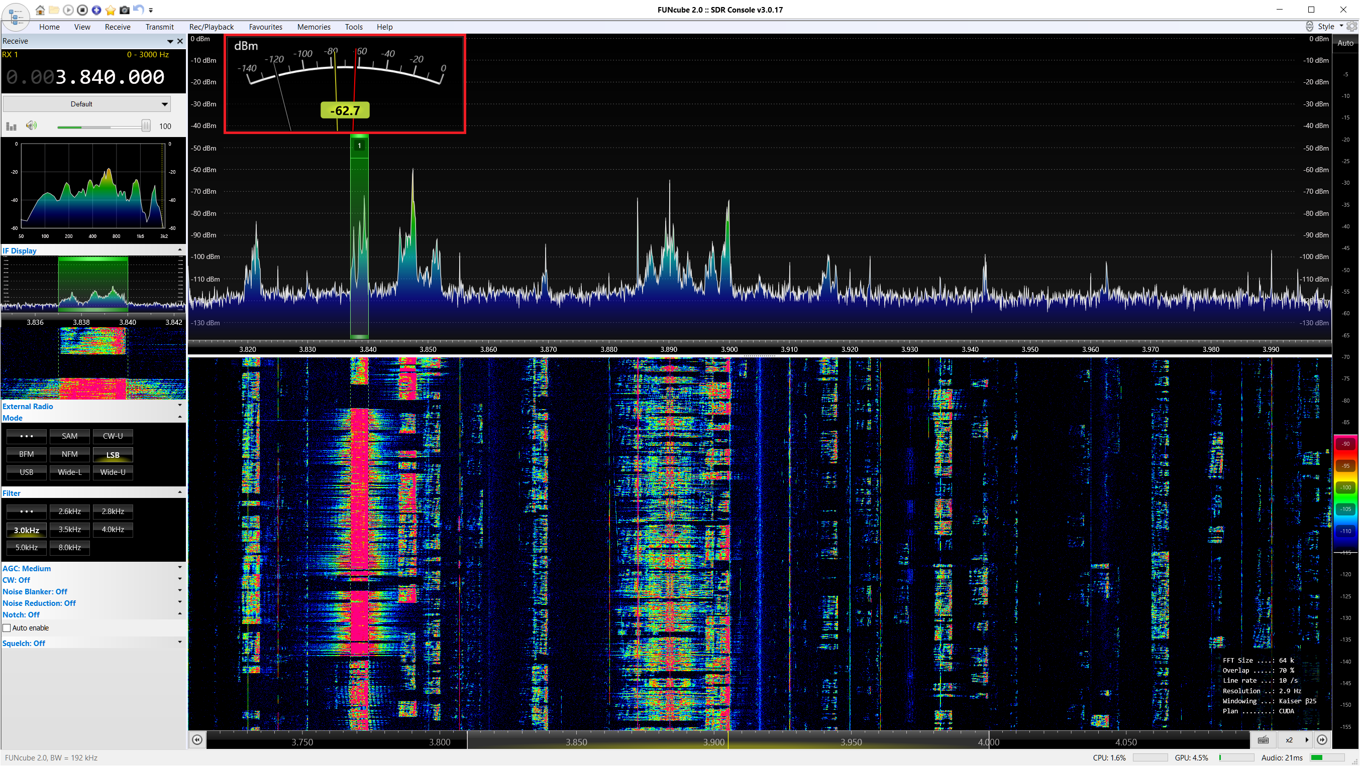

Re "real estate", as you noted there is currently lots of unused "dead space" in the lower portion of the console, some of which could be well utilized to house a good-size meter.
Also as an example, here's a screenshot of Simon Brown's S-meter in his SDR Console. Notice how it sits rather unobtrusively in the upper right corner of the spectrum scope. Also note how it has three needles -- peak, instant and noise floor -- lots of info there! It's also resizable.
Lol, I just remembered that screengrab was actually taken to record the horrible splatter of Bill's signal on 3.840. I'll not publish his callsign here but anyone listening stateside in the mornings between 8:00 and 10:00 am Central Time on that frequency can find out for themselves. His signal is very strong, and always that trashy. Positively disgusting!

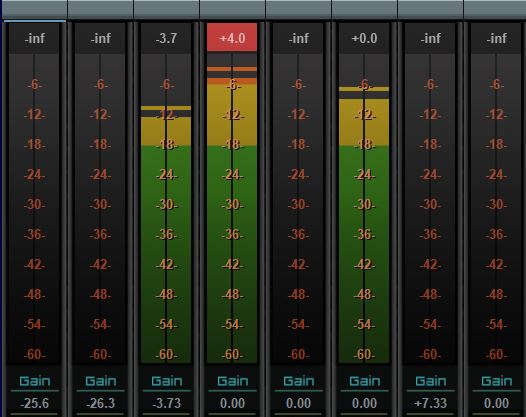

Here's what, IMHO, would be most useful, something like this:
Where each vertical bar Is user defined/selected to represent the parameter desired and has:
1. An appropriate, easy to read scale.
2. A solid section the top of which indicates the average value, or just the value if there was no separate peak and average information.
3. A bar that floats over the top of the solid section indicating the peak value where available.
4. A numeric readout at the bottom showing the current numeric value and the units they are in (my example has no units--too lazy to Photoshop it).
5. A numeric readout at the top showing the current peak value.
6. A parameter label at the top or bottom (my lazy example shows "Gain", but you get the idea, I hope).
Such an arrangement provides a most efficient use of space while still allowing a large amount of information to be clearly and consistently displayed and understood.
Also:
7. A typical layout need not have a fixed number of bars, but there might be some maximum number allowable.
8. Bars would grow/shrink in width and height to fill the available space in the Window/Windoid/Docker, but there should be some minimum allowable width and height so that they cannot be shrunk infinitesimally small.
9. Scales might become more or less detailed depending on the absolute size of the bar in pixels.
10. Context would NOT change between RX and TX--to do so risks confusion. The more meters allowed, the less important it is to change context.
A typical lineup of bars might be:
MIC, ALC Group, FWD PWR, SWR, S-meter (both avg and peak on the same meter), PBSNR
Bars need not be colorized as in my example, but one could play all kinds of games here. For instance TX related bars might have a different color background than RX related bars, etc.

That's my kind of meter Scott. It looks simple, efficient, elegant and customizable for my individual needsw-u-2-o wrote:I'm not sure people are thinking big enough. One need not be limited to one or two dial style gauges, be they old fashioned or ultra-modern.
