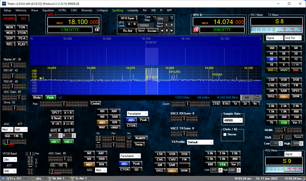

Please post screenshots of the entire Thetis main console while operating in RX and TX mode in WSJT-X FT8 so we can see exactly what you're talking about.

I hope this attachment works !K1LSB wrote:Please post screenshots of the entire Thetis main console while operating in RX and TX mode in WSJT-X FT8 so we can see exactly what you're talking about.
Dick/w7wkr

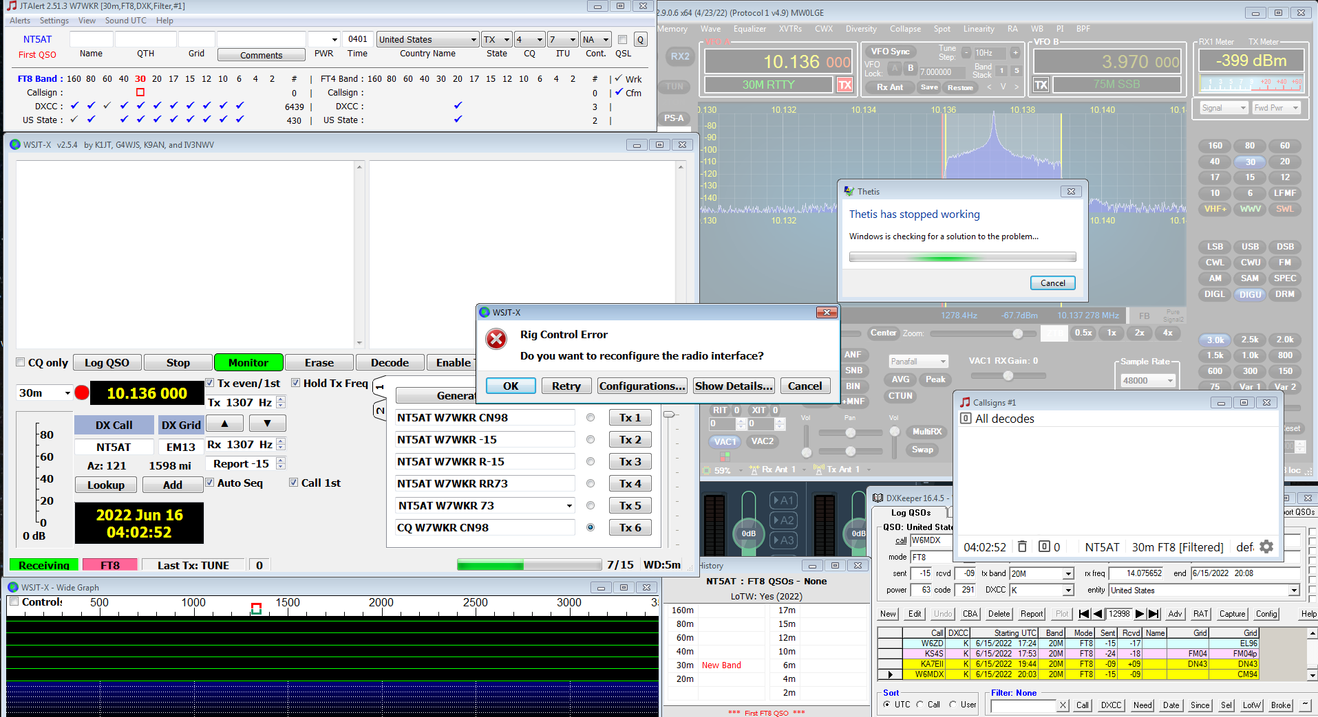

After maybe ten FT8 contacts right in the middle of another FT8 contact THETIS quit working (view
the attached file to see the screen capture)
I shutdown :
- THETIS and restarted w/o any error messages
- When clicking on the THETIS "power" button a popup screen asked if the ANAN-200D was powered-up - it was
- Went out to remote site and cycled power to 200D
- Clicked again on the THETIS "Power" button and the 200D was running OK
- started WSJT-x and made sure VAC1 was active in THETIS
- FT8 signals decode fine
- Clicked on WSJT-x "Tune" button - Nutz, no output power
- Ensured VM-Banana was working correctly, checked all input/output settings in WSJT-X and THETIS
all correct.
Again, the setup here is :
- DELL E6510 Laptop with Intel I5 CORE and 64-bit OS W-7 PRO and 8GB RAM
- THETIS v2.9.0.6 x64 (4/23/22)
- WSJT-X v2.5.4
- Voicemeeter Banana
Again, I'm outta-my-comfort-zone and need assistance. At first I thought maybe running JTAlert and having PSKReporter
running in the background might be overpowering my system. So I closed everything but THETIS and WSJT-X and had the
same failure.
Dick/w7wkr at CN98pi
- THETIS stops working Capture.PNG (271.06 KiB) Viewed 16782 times

Hi after upgrading to v 2.9.0.6 iit doesent show waterfall on 17m
and only on 17m rx1
any soggestions ?
br Geir
and only on 17m rx1
any soggestions ?
br Geir

Geir: your screen shot shows "panadapter" display mode selected for both RX1 and RX2. Switch your display modes to panafall or waterfall.

its no difference whatever i chose 18Mhz is not showing it works can send and receive but no display
it works in every other freq but not 18 mhz, it works fine in RX2

Please compare your Setup>Display>RX1 settings while on 17m vs. RX2 settings on another band. I have a suspicion and I'm pretty sure you'll notice big differences in the settings.
What is striking at first glance is that the "Spectrum Grid" display is not visible. I assume this is turned off. It is usually left-aligned, as is the case with your RX2.
If RX2 is working on 17m, duplicate the settings to RX1 one by one. I assume then RX1 would work.
Or post a screenshot from your RX1/RX2 settings.
What happens if you enable AutoAGC?

yes you where correct was -155 in spectrum gain settings set them the same both and it works. Thanks
